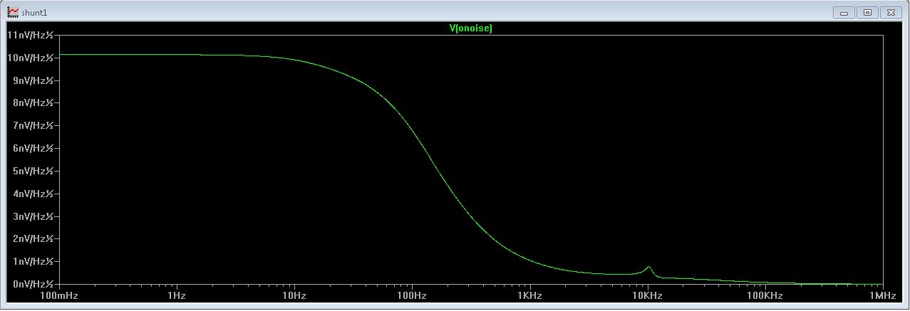

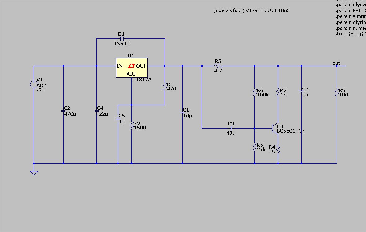

Tinkering with the wenzel shunt. It works well !!
I saw the "squeezebox" DAC supply , simulated it.
Pretty good at 50nV/hz ...but I can get <10nV/hz with the wenzel.
(below 1) is the circuit , and (below 2) is the simulated noise.
5.04V out , 5mA shunted , 50ma max current for the posted circuit.
Wenzels shunt cut the 317's 300nV noise down by a factor of 30+.
Edit - A "squeezbox" LM723 regulator plus this shunt would be phenomenal.

Is this regulator ready to go or are you still perfecting it?
I still am not sure what pre-regulator to pair it with. I'll have to cross match
LT's precision regulators with TI's to model anything correctly.
My gut feeling now is that you set any adjustable reg. at 5.25-5.35V ,
shunt off .25V through a resistor to get 5V with 1/30th the noise.
At least this is what has happened with all the LT regs. I've simulated
so far.

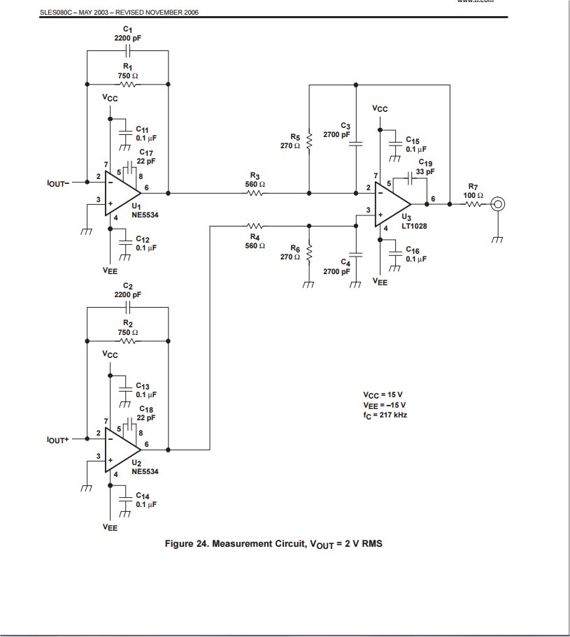

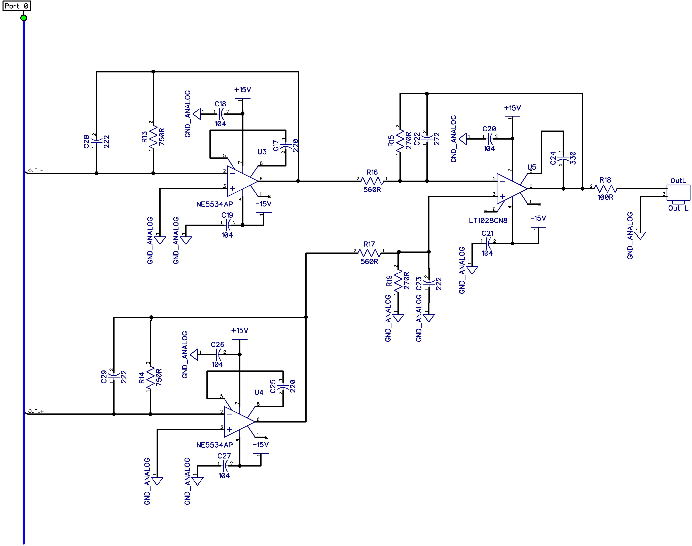

I meant can we take the output directly from the DAC IC output pins or does it need an op amp in between?
Some DAC's need external op-amps for the I/V and filter (below- pcm1794)
For just a DAC in a box , fine ... use the filter as the main buffer.
Newer auto/mobile ones - http://www.ti.com/lit/ds/symlink/pcm5121.pdf
...have the DAC + I/V - filter all in one. No buffer really needed if for a standalone app.
However , the externally buffered/converted DAC's offer greater performance
and flexibility (roll yer' IC's 😀 ).
Multiple input preamps with attenuators should have a dedicated main buffer
as some inputs won't be pre-buffered , like the DAC is.
OS

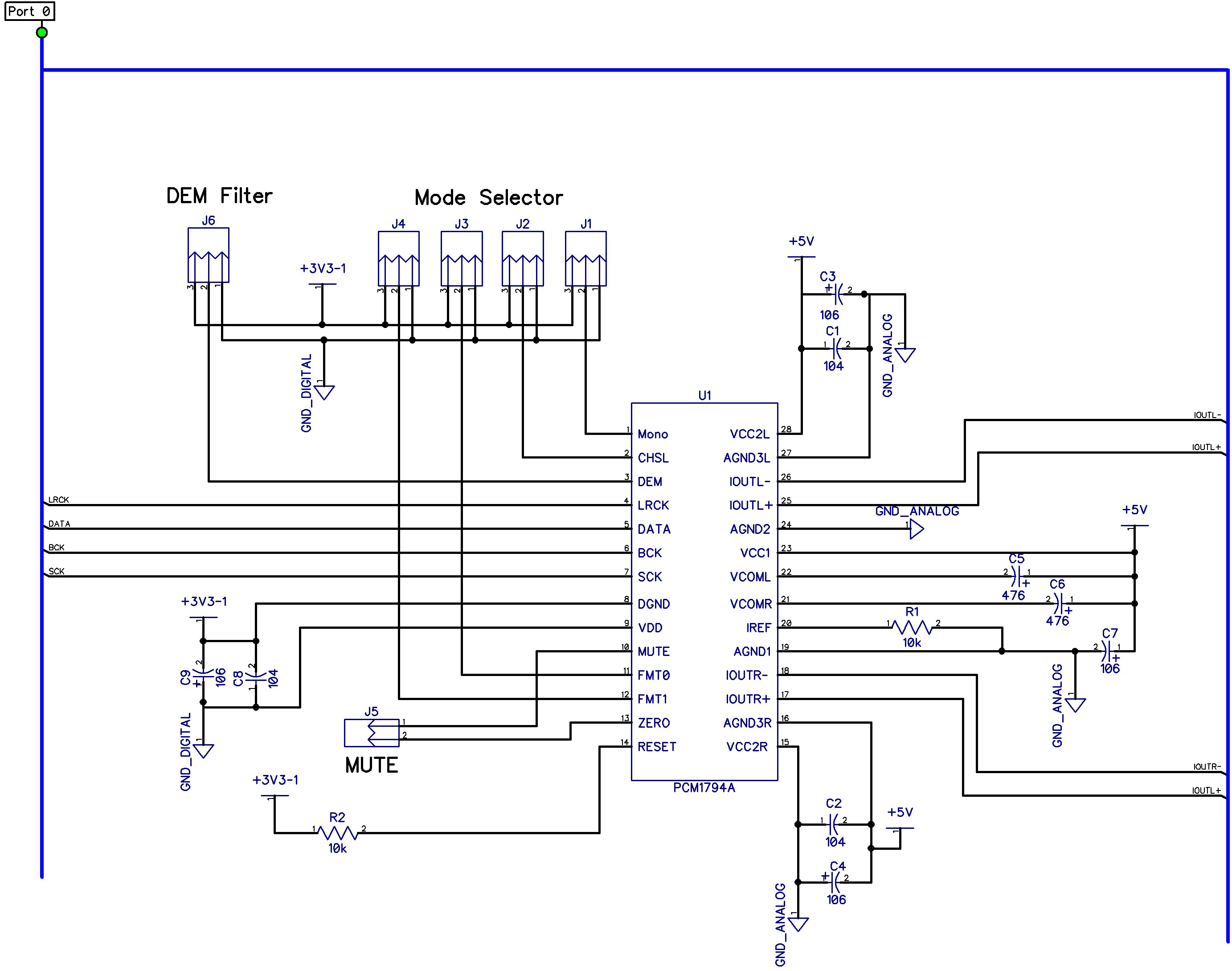

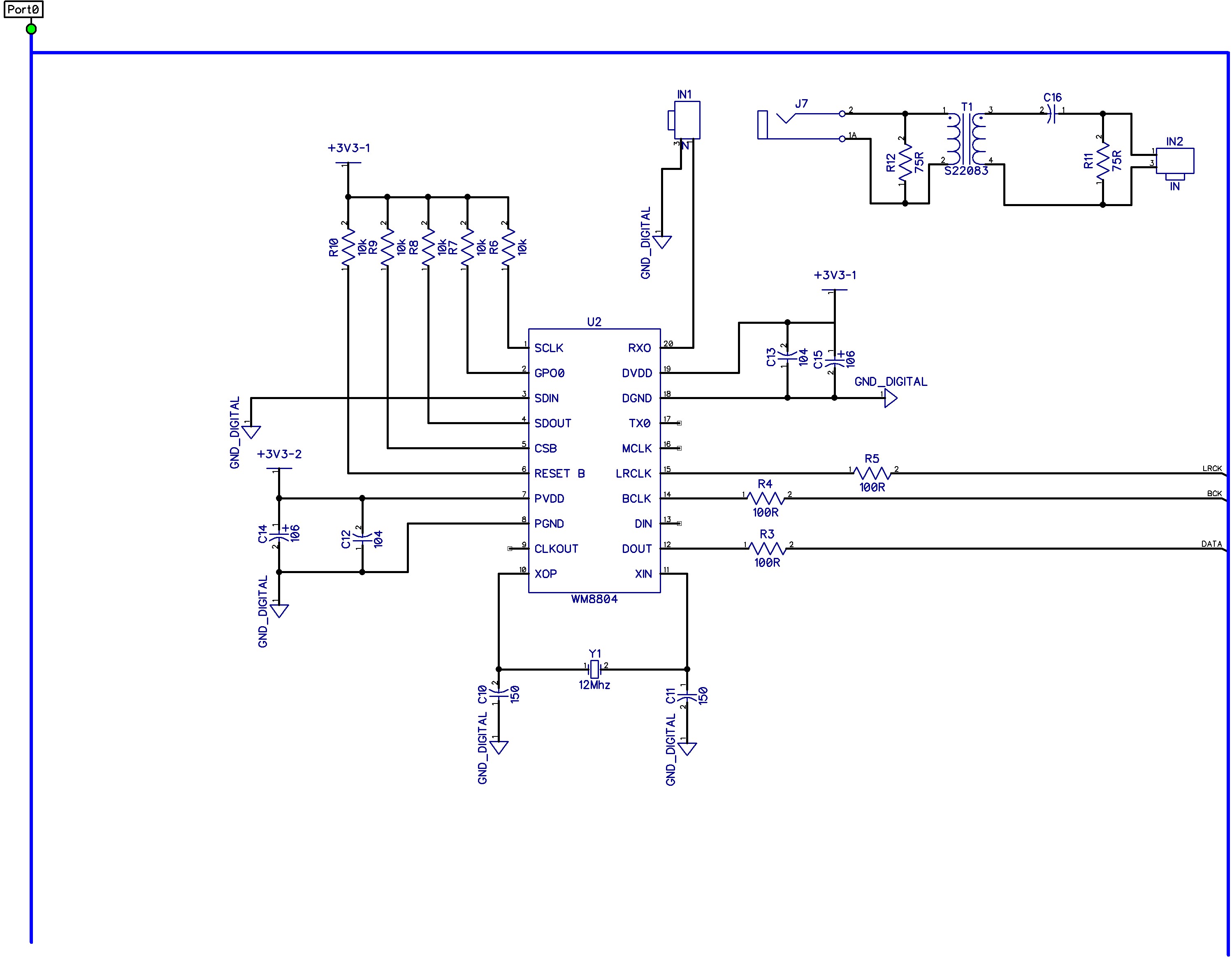

Here's what I've gotten put together for the DAC so far. I'm still trying to figure out something for USB input but it's looking like a ready made daughterboard is the way to go there.
I also need to add an optical connector yet too.
