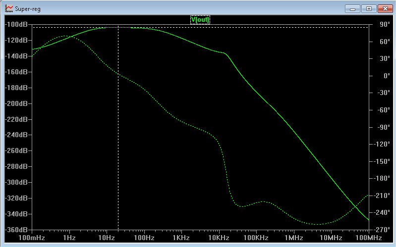

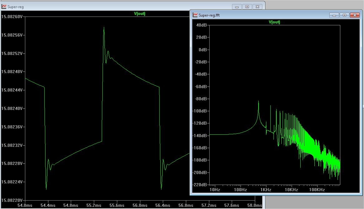

But it's true (below) ... the original would "croak" on the 6V squarewave
shown. That's all the ringing I could get out of it (without a CRC , even).
You can use a TIP142/147 as series device for a nice -125db PSRR (1.5A out).
The whole range was -115db to -127db , with any op-amp or BJT -
NO oscillations ... at all.
PS - I'm not sure the regulators designers put the circuit though the
"hell" I did. It is just a simple neg. feedback circuit , with the reference as the
"pesky" positive component. After identifying this , I treated it as such.
Edit - we use this instead of a LM317 ... why ?? (below 2) , it even makes a ZENER
reference look good at -102db ! Truly "pitchfork" ... junk drawer bliss !

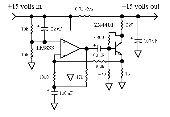

I've been waiting to see if anyone responded to your design. What voltage do we need to feed the regulator? Will it run on 24-0-24VAC?
Another plus , you could run these off the Slewmaster supplies. 😱
The led current source and series BJT are the only things that see the
unregulated input.
Another point of this regulator is startup. The original zener assured that
a "railed" op-amp output would not be needed to set the series transistor
bias - hence , "this is absolutely essential" comment. My 3 leds are close
, 3 greens would almost copy the original 6.7V zener ,but reds are quieter.😀

I know you like your LEDs, but do you not think a tl431 or equiv, would make a better reference, than a LED, in your current source driven off an unreg supply?
The LED CCS is a start-up facility for the regulator. You want it to be "fast and
dirty".That is also why it's hooked to the unregulated side.
The error amps feedback would even mostly cancel out just a pure resistive
source instead of the led CCS.
PS - Q1 is not the reference , the real reference is hooked to the op-amp (+).
The op-amp (error amp) will also correct thermally for Q1/2 and the led's.
(checked this , too).

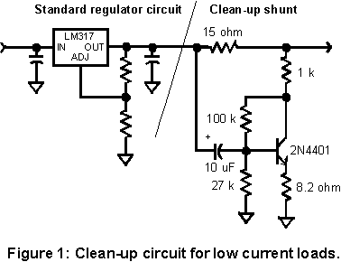

The other power supplies ....
Now we need a nice quiet 5V and 3.3V for the digital.
I looked around , (link) - Finesse Voltage Regulator Noise! |
It seems the combo series/shunt (317 / simple shunt). Just sinking the resistor noise current through a BJT , easy !
The 3rd example is said to be able to reduce a 317's noise to 20uV.
So , I looked at what is available from TI. Hmmm ,
- 3.3V = http://www.ti.com/lit/ds/symlink/lp5907.pdf
And the 5V = Any number of TI LDO regs - like http://www.ti.com/lit/ds/symlink/lm2937.pdf
Performance is not much better than a 317 here .....
Better ones are costly or are limited in current. It might be best to go
DIY discrete for the 5V supply.
Any relays can be run from a simple 7812 fixed regulator - no real "audiophile"
factor to worry about.

For all to see , I'm checking these two (below) for the 5V "clean".
Lower PSRR won't be a problem for digital ... like it is with analog ?
