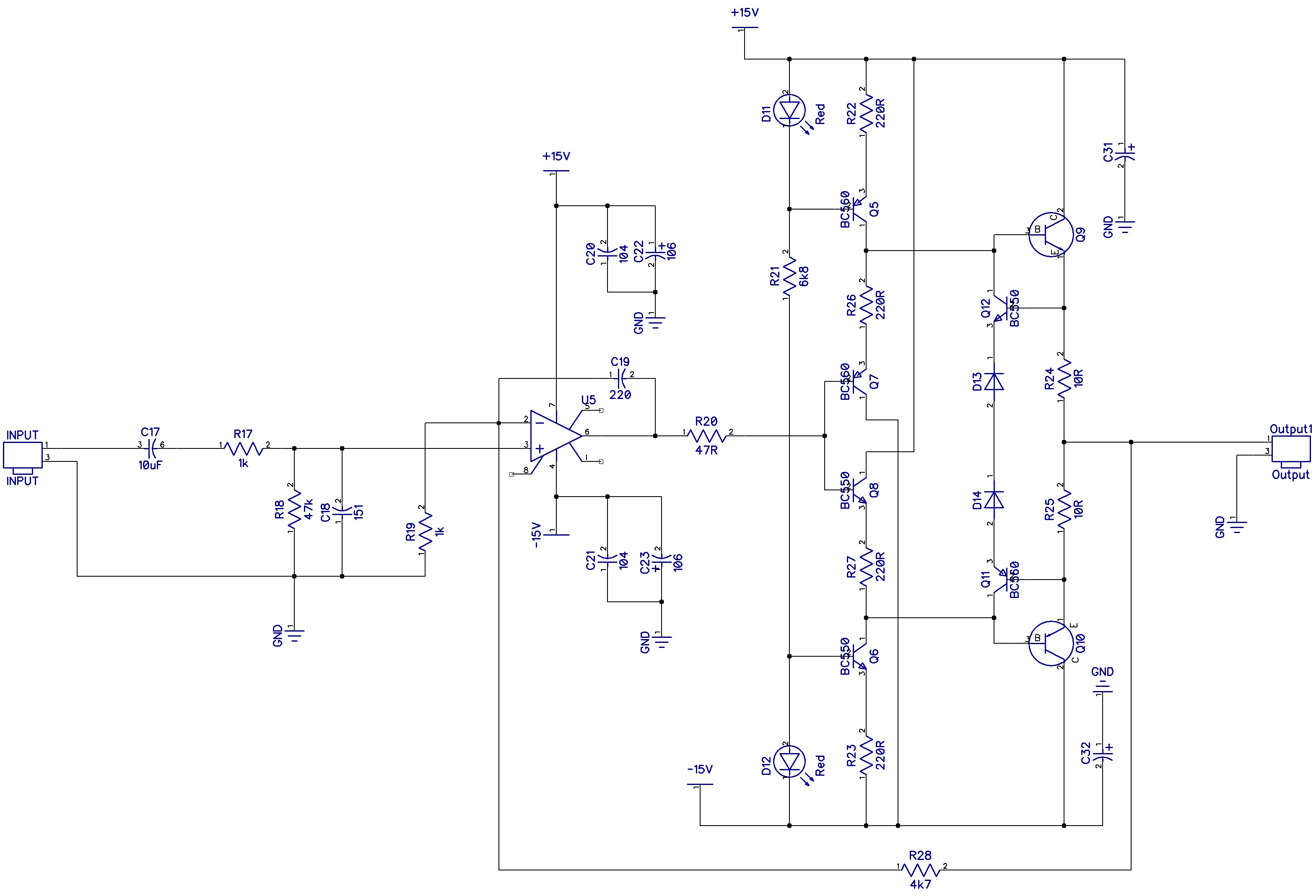

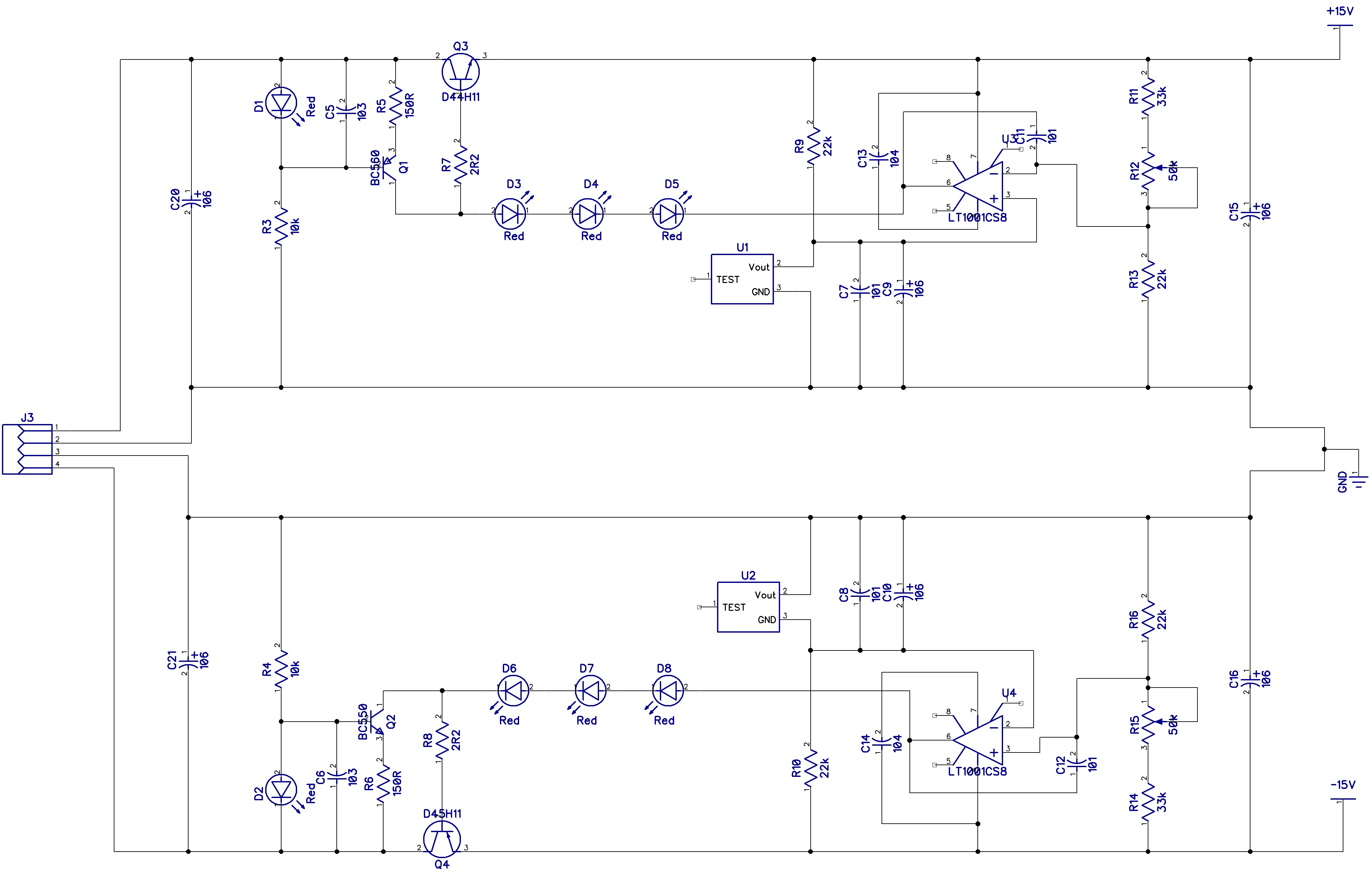

I've got a stereo linestage almost ready for testing.

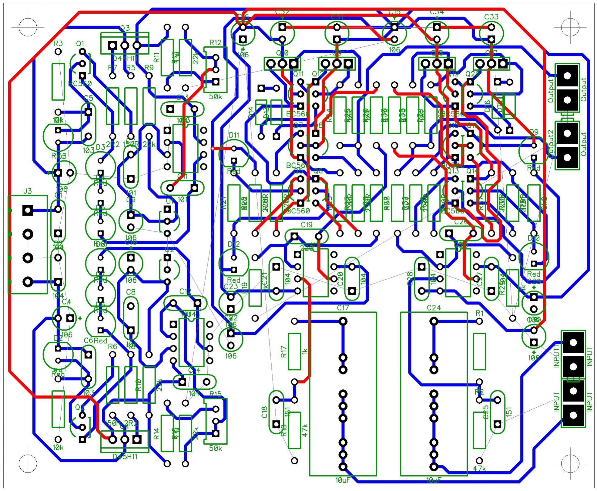

That looks like a lot of loop area between the linestages and power supplies.
There is no way to make it symmetric ?
What I mean is the positive regulator close to the two positive class A
output devices - same rail.
Think of an output stage on a big amp with two pairs - each pair driven
by it's own individual set of diamond buffers and running off the same
common V+ and V- bus.
Grounds could return to the middle symmetrically.
The Jung's give us the option of a slightly unsymmetrical rail layout , as the
error amp feedback can compensate by it's takeoff point.
Ground layout should still approach symmetry (for cancellation).
Show the major tracks , like I do on a new IPS.😀
OS

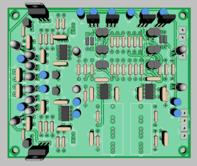

This software is pretty hard to show a board. I've removed the ground plane to show traces. I think I should be sensing the supply right at C15 and C16. It's pretty tough to feed both channels symmetrically from one supply so I moved the output caps from the supply right to the output stage. That leaves a long loop in the negative rail output. There's going to be a long loop somewhere no matter what. Is that better to be in the raw DC input or in the output of the supply?

You want the shortest path possible between Q9/10 /18/17 and the regulator
pass transistors. The regulator error sense inputs - R11/14 , should connect
midway between (or on a thicker common bus) going to those line stage
outputs.
Pass transistors/line stage outputs - where any real current will be flowing.
The ground returns of these "players" should also be short,sweet, and symmetrical.
Why not have a set of euro terms with the jung regulated outputs. The load
on the regulators is almost resistive and the regulators will have
a full .5 -.75A "left over" ????
PS - you realize this could also be a very nice headphone amp with the
addition of a input volume pot ?? (external . of course 😀 ).
Edit - all grounds through the plane ??? Nah , digital maybe - this is analog
(anal analog).
ground returns on the ips's , slewmaster ops decoupling are how you get
"nasty" currents to behave.
OS

Should the regulator grounds be on their own star? I'll play with this some more when things slow down a bit. I'm going strong on the I/O control design right now.
Did you ever narrow down your choices on a DA converter?
The regulator grounds to a perfect star , the ground plane will act as a faraday shield/cage if connected to the center of the PS star.
But , any component grounded to the plane might also pick up EMF/RFI 🙁.
Also , the reference grounds and the error amp divider on the Jung want to see the same perfect ground (the main PS star). Separate returns for these , too.
Please , output the regulators (euro-terms) 😀 ....

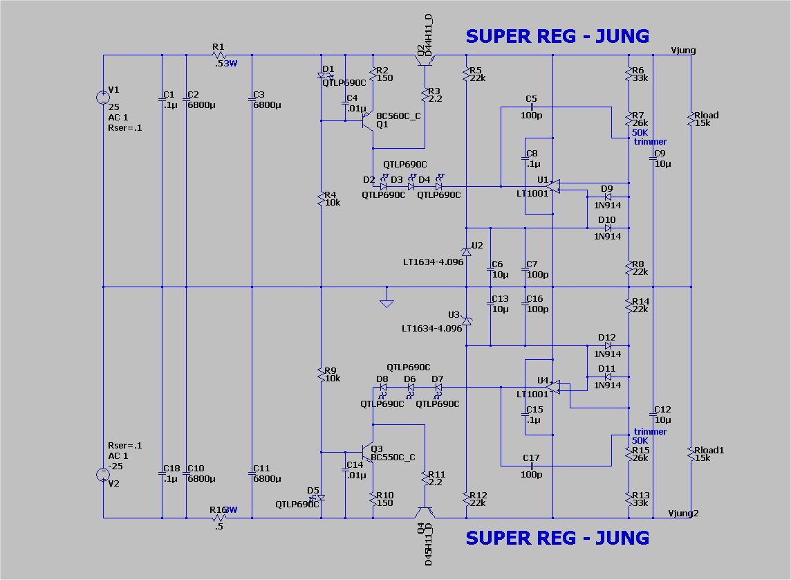

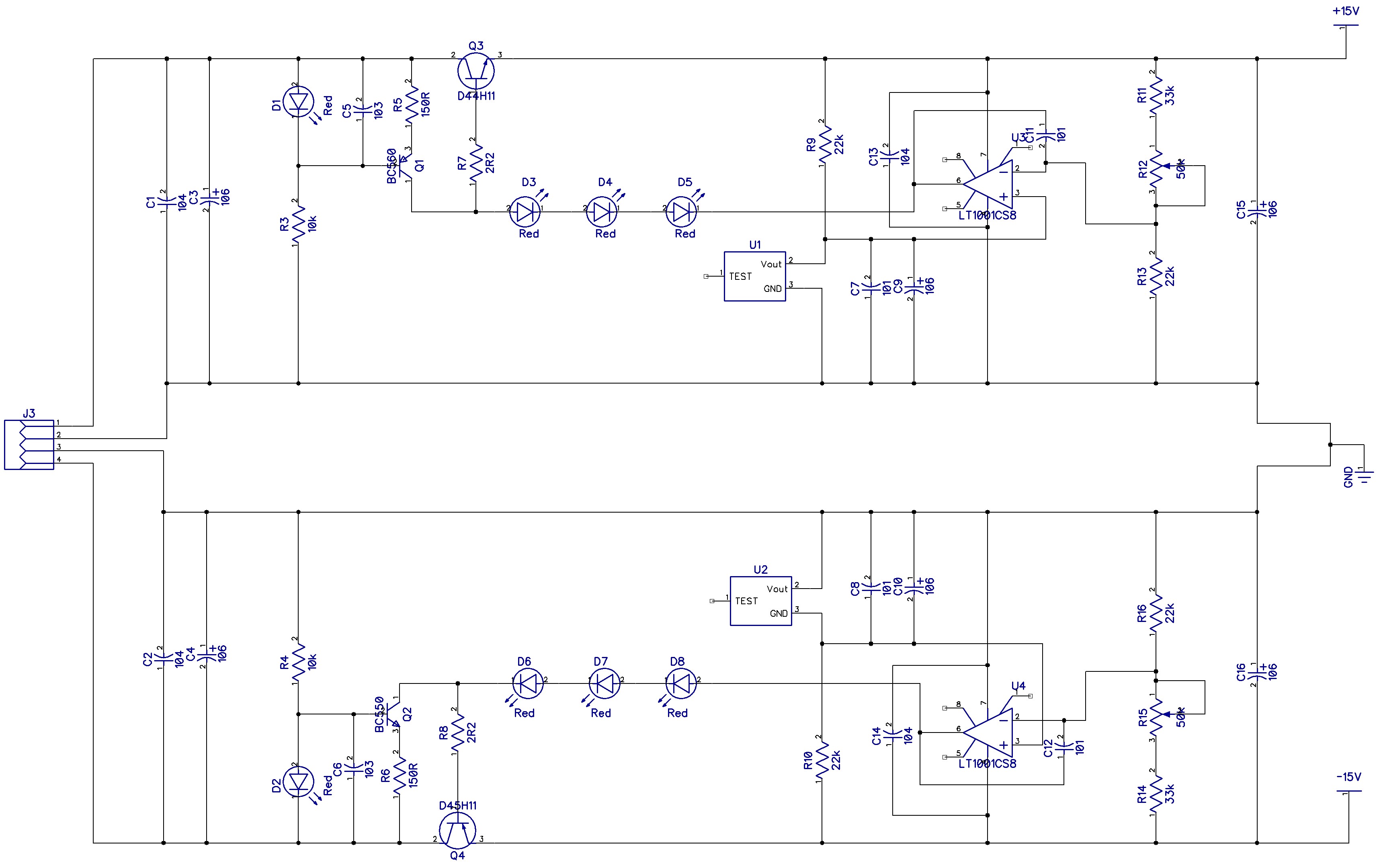

Okay. Can you see any changes happening to the linestage? Should I add any pads for caps anywhere?
http://www.ti.com/lit/ds/symlink/lme49600.pdf
See the 10uf's at the 49600 ? Those are the ones at the output of the Jung.
These should be at the linestage output collectors instead.
These were included in the PS schema to test for stability.
Just consider the discrete linestage like a big 49600.

I added some right at the outputs (C31-34) to decouple them from the other channel. I left the regulator output caps (C15 & 16) as well. I also added electros and ceramics on the op amps on the inputs. I'm just wondering if there will be any compensation caps on the outputs or predrivers.
I fed the input sections from the output collectors. Should they be fed from there or from the caps on the Jung outputs?
I added some right at the outputs (C31-34) to decouple them from the other channel. I left the regulator output caps (C15 & 16) as well. I'm just wondering if there will be any compensation caps on the outputs or predrivers.
What I meant , was that you don't need them at the Jung's output. I put them
in the schema for a stand alone regulator. Hooked to the linestage , the 10uf's
go to the linestages outputs (where they count).
If the PS was stand alone , an "unknown" dynamic load might require that
decoupling.
Edit- you might want to add one optional SM cap placement from (-) to (out) for the linestage IC.
