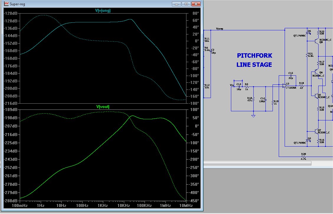

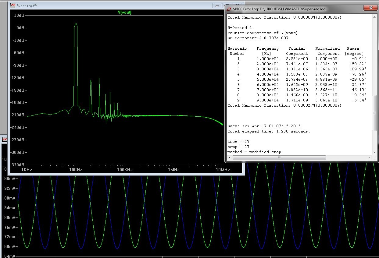

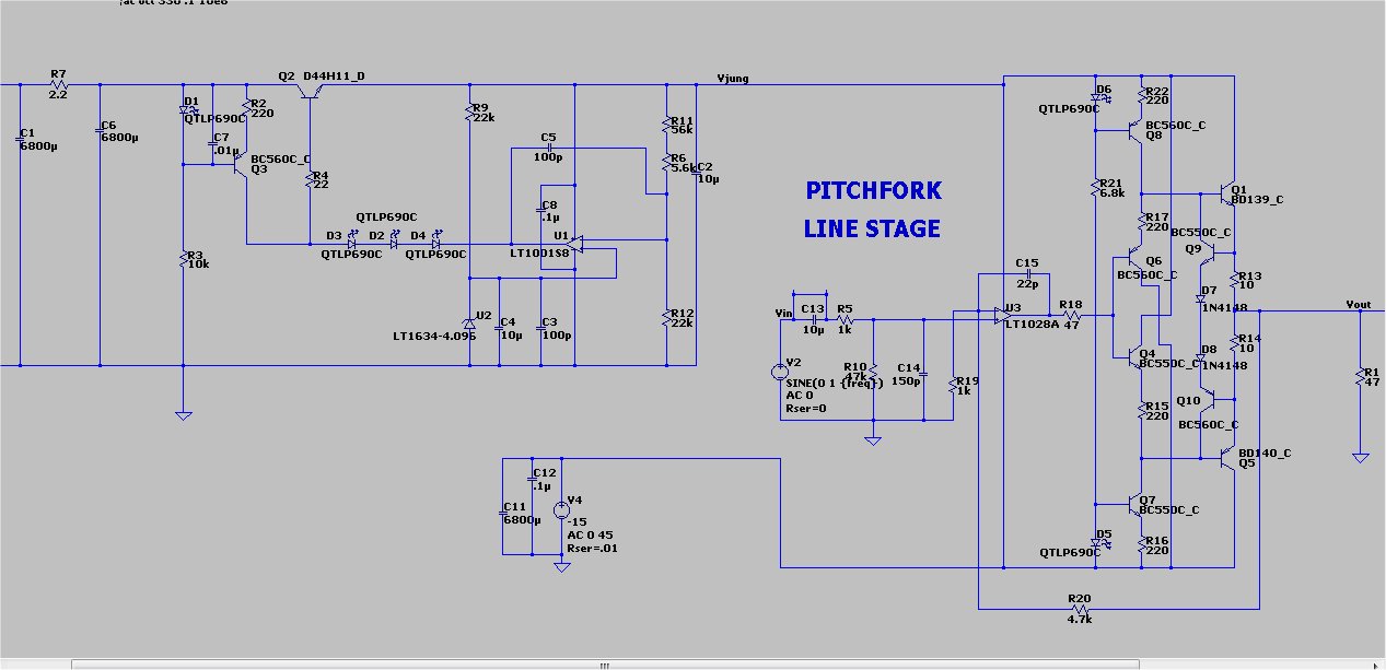

Full deal - any parts (not "picky") !!
(below 1 ) is my best attempt at a "blameless line stage".
By "blameless" I mean ... these specs don't matter -
.5ppm and -210db psrr !!! (below 2/3).
The Jung super reg was a "beatch" , it oscillated on some op-amp
models and not on others ... as it was originally published.
So , I treated it as a feedback amp , broke the loop - and optimized
it for phase margin and bandwidth. In doing so , I had to compromise
between performance and stability (like in my amps). ;)
My Jung did not have the LF PSRR of the original , but had superior HF
performance ..... added a CRC instead of that LM317.
In the end , I have the Jungs performance , add my line stage for
that -210db pssr ... plus ,ANY IC will work ! (in either PS or amp).
"Roll yer' chips in my designs !! :D
Edit - this is for analog ... for digital , a mosfet reg. is the way (noise performance).
OS

I did that one , I even made a full discrete error amp with a series current
source and the shunt controlled by the differential.
NOT EVEN CLOSE to the IC error amp Jung. (-60db vs -120+db).
The Jung can also be ported to control a shunt with the lowly
317 as the current source , as well.
Just simulated , evaluated , and modified 50 "super regs" ...
the Jung wins - hands down.
PS - yours will work ... but only do -50- -60db.
edit - did the salas , better noise ... but not PSRR.
OS
Not too well , not enough current gain @ 750ma load. It might work with a smaller base stopper and lower current on the CCS. (and less load).
The MJE just requires too much base current with any load (just simulated
it).
Low Vceo devices rule for the Jung regulator.
