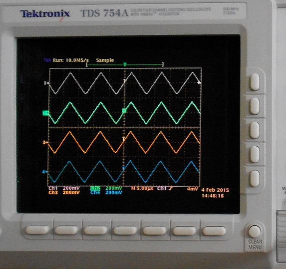

On screen menu selection with buttons around on side and on top or bottom work like the Tektronix TDS 754 type work great and language etc. never a problem.
that is exactly what i did with the portable, bottom row for display of menus over the 6 bourns encoders with builtin switches and bi-color leds, covers a lot of bases and makes for ease of use. without this ability the gui is nuts, i have a separate menu for the different functions, AM, FM, MP3 player, USB dac/codec. look a the tons of buttons on the a/d preamp = nuts, many done away with intelligent /dynamic menus

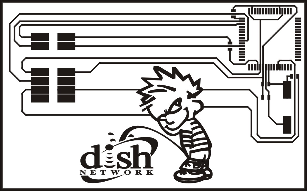

I can't find a finished one. Here's the pc board from it though. All that worrying about board layout is overblown. The top of Calvin's head and the rest of his body were RX an TX if I remember correctly.
