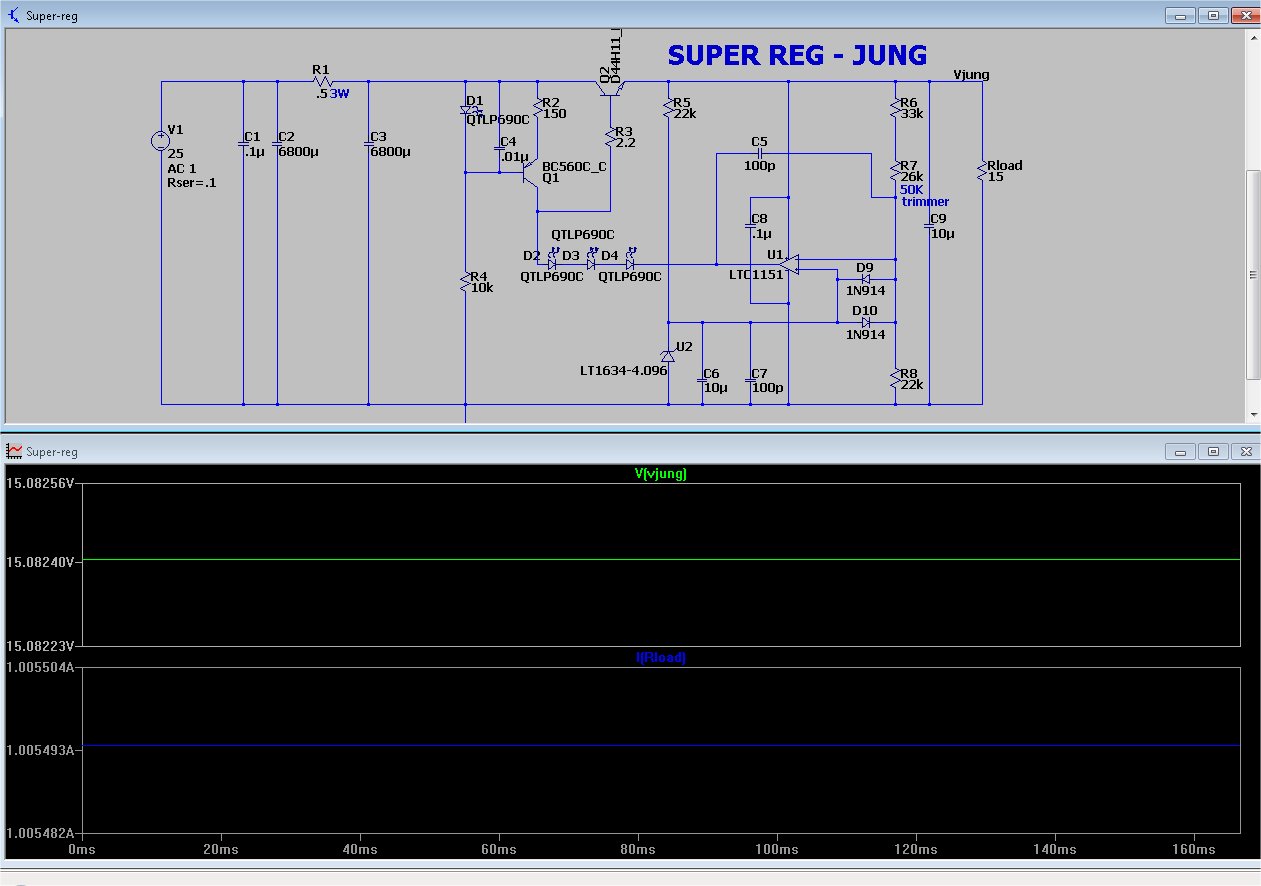

Pitchfork pre-amplifier
(below 1 ) is my best attempt at a "blameless line stage".
By "blameless" I mean ... these specs don't matter -
.5ppm and -210db psrr !!! (below 2/3).
The Jung super reg was a "beatch" , it oscillated on some op-amp
models and not on others ... as it was originally published.
So , I treated it as a feedback amp , broke the loop - and optimized
it for phase margin and bandwidth. In doing so , I had to compromise
between performance and stability (like in my amps). 😉
My Jung did not have the LF PSRR of the original , but had superior HF
performance ..... added a CRC instead of that LM317.
In the end , I have the Jungs performance , add my line stage for
that -210db pssr ... plus ,ANY IC will work ! (in either PS or amp).
"Roll yer' chips in my designs !! 😀
Edit - this is for analog ... for digital , a mosfet reg. is the way (noise performance).
OS
Is the Jung regulator ready for PC board or is it still going to get some more refinement? Should R6 be a trim pot?
Yes , here is the "tidy" positive version (below/ R7 = 10-20V).
I just tried just about every LT op-amp in this circuit. All are stable and
between -115db and -125db PSRR.
As I said before ,
- LM317 = -72
-7812 = -52
- a Discrete LTP error amp with reference @ -65db.
This is such an easy circuit , you should build it and scope it. Give it
a 15R load (1A) .... that is it's limit. ( 2 picovolt load change !! )
I'll make the inverse negative version next.
Both the reg's and the two buffer
amps should be anally laid out on one board.
Just two of these PS's could also supply any other analog requirements.
PS - Q2 needs a BIG heatsink for 1A. (or chassis mounting).
What I did was trade off 20db in performance for stability/simplicity.
The original did >-140db !
You are a morning person , jeff ?? 😛
OS

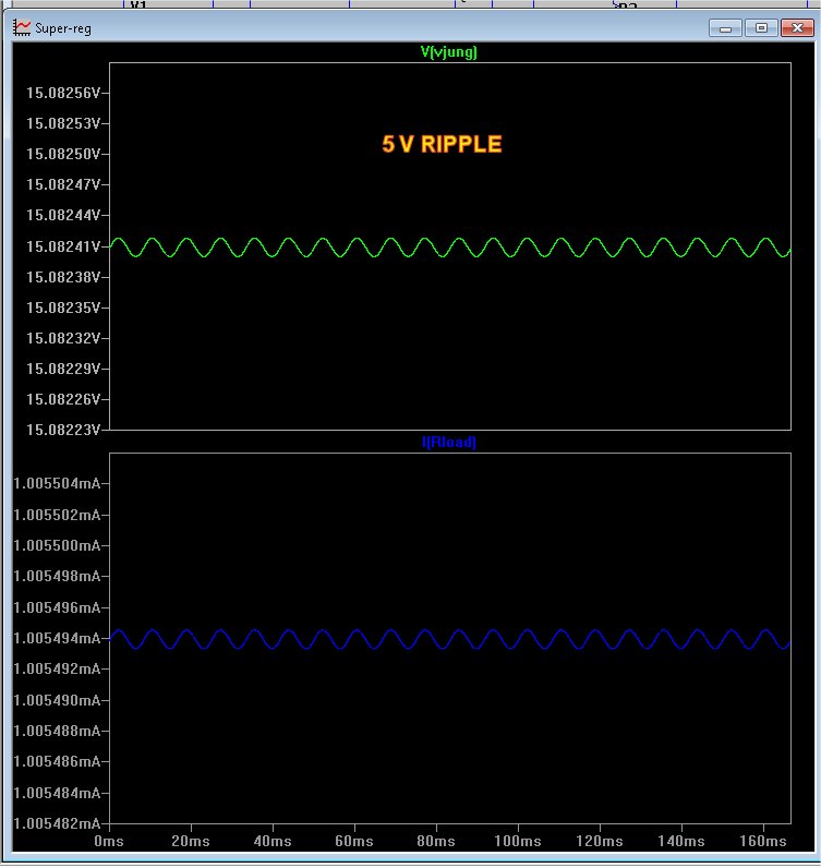

Edit - Below - with 5 volt ripple .... still 2 picovolt !
OS

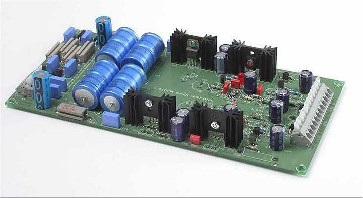

(below) .... most of the Jungs out in the wild have the unregulated
onboard , the better ones with a separate trafo. Some chinese or diy
ones integrate the trafo on-board. Yuk !

At 1.1A you drop to 13V . 1.25A - 4V. At this point the reference loses
sufficient voltage and the whole regulator collapses to a safe >2.5V level.
A dead short will output < mv.
Regulator is self limiting by design. 🙂
Jeff's protection board , in a simple form (tiny relays for soft start/on)
would be good. Just using the delay for the output buffers would be nice.
The buffers (either mine or the IC one) , also are current limited at @200ma.

I did that one , I even made a full discrete error amp with a series current
source and the shunt controlled by the differential.
NOT EVEN CLOSE to the IC error amp Jung. (-60db vs -120+db).
The Jung can also be ported to control a shunt with the lowly
317 as the current source , as well.
Just simulated , evaluated , and modified 50 "super regs" ...
the Jung wins - hands down.
PS - yours will work ... but only do -50- -60db.
edit - did the salas , better noise ... but not PSRR.
OS
