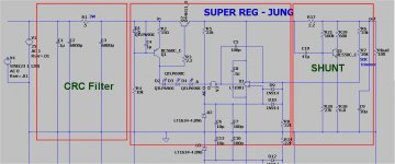

As there is a lot of discussion on shunts here and the Jung regulator someone mentioned to me at some point that the Jung could be made into a shunt supply...was that considered?

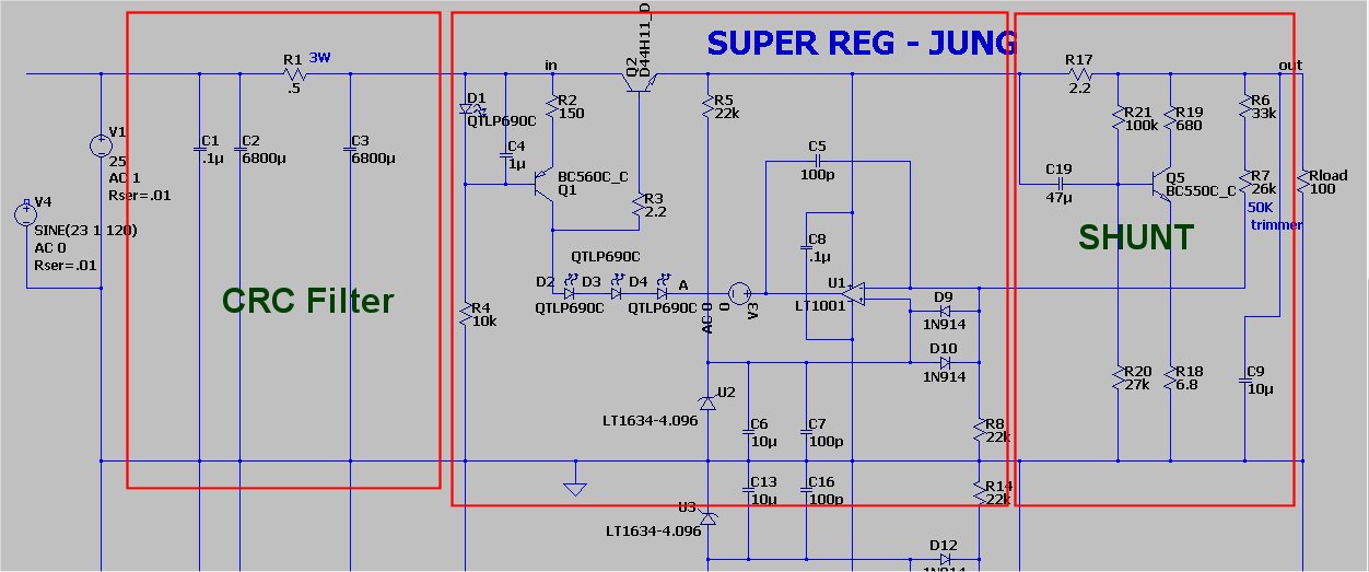

Besides burning up wattage , why use a shunt on the jung ?
It only has 100nV noise. (below) ... if you combine the Wenzel shunt
with the jung , you get 3db more pssr and reduce the noise to the
BC550's and R17's noise (shunt section - below).
The combo seems just as "bad" as just the series regulator ... same
15.082V , as I referenced the output after the resistor to the error amp.
Shunting between 25 and 100ma gives 2nV noise !!

Thanks for the reply OS, Just had always wondered about the performance of the Jung as a shunt. At one point I was looking a supply to power a THAT 1206 balun. line receiver and someone gave this as an option. But now I know and perhaps I too will look at the wenzel.

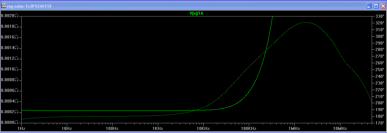

What's the hit on the Zo spec though?
Yes , no longer ideal (@ milliohms).
I'm just extrapolating this conclusion because I can't get a Z out plot 🙁😱 .
R17 for DC/LF and the output decoupling cap for AC-HF ( 2-3R Z).
I tried the forum search for the method , still just get db.
I'm only using the low noise shunt for low current digital , do I need
real low Z ?
.ASC below ... could some help to plot the Z ?
OS
Depends on priorities. Noise spec vs dynamic spec. To sacrifice mOhm spec for several Ohm spec takes some serious application specific reasoning. If the particular device (load) changes some current draw then the high Z regulator's output will modulate along accordingly. Test the device to see if its constant draw or not first.
Can't run your .asc because my LTspice is set on different component libs but If you can already produce Zo dB over AC for out then right click on V(out) curve title and make it V(out)/1A also left click just beyond y axis where a ruler symbol shows up, select linear presentation and the plot range settings also, like in this example:
