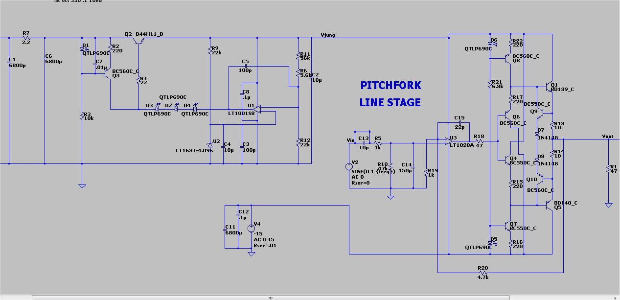

What should I be seeing for idle current on the linestage? I've got it fired up on a 27VDC supply. I have the regulator set at 15V rails and am idling around 220mA. Those pass transistors are cooking.

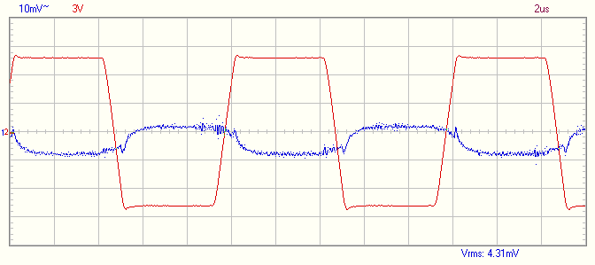

I've added some heat sink to the regulator pass transistors and did a little testing. The regulator seems to be dead stable and quiet but the slew rate of the linestage itself isn't good. Sine waves turn to triangle waves around 40khz with no load. It's designed from this schematic. Should I be adding the extra diode in the output like the diagram in post 1?

47K || 150pF might have a bit to do with that ...

... Sine waves turn to triangle waves around 40khz with no load...

OPA177 op amp on the input is causing it. I swapped them for LT1028 an it's much better. Positive rail voltage has around 1 mV of noise on it. Negative rail has more. This is at 100khz square wave with no load..

On the schema you posted , raise R22/16 (the CCS's) to 270-330R. That
will cool things down. You want 50-100ma class A at the output stage.
Headphones or an amp input will never load down to 47R (like I anally tested
it at) - overkill by a wide margin. 50 ma would even drive the most hungry
headphones.
I might be wrong , but the much higher Z op-amp input could work
without such a big capacitor for the filter , try 22-47pF ... we just
want to filter any RF here.

270R puts the output at 75mA.
