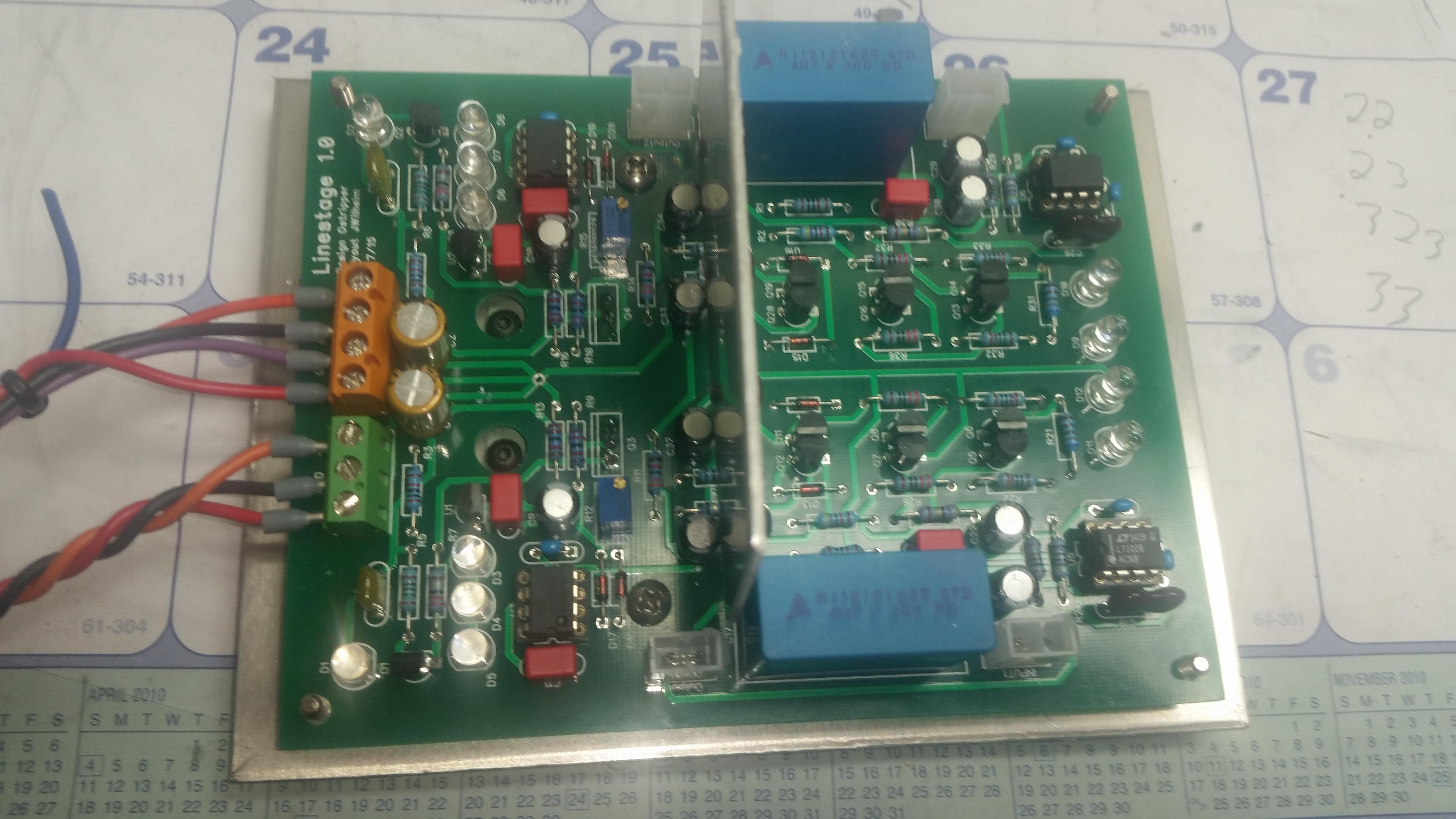

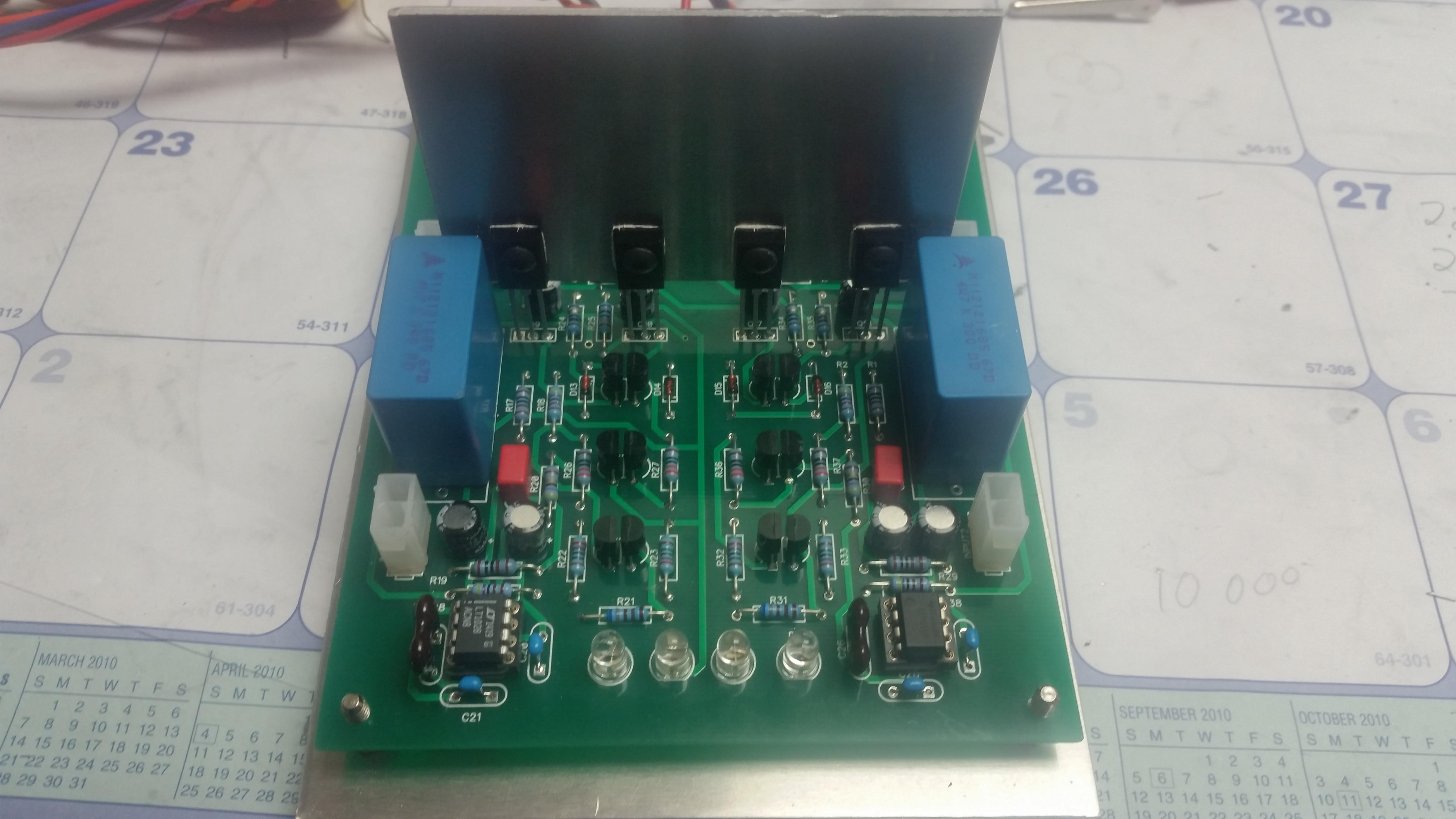

Do you think the Jung pass transistors will run cooler with a lower voltage transformer? I was testing with 22VAC. 12VAC ran cold but didn't quite make 15V.
Right now I have them mounted on a 5" x 6" piece of aluminum plate below the board. They get the plate up to 130 degrees after about 10 minutes. It's likely going to pump out more heat after the volume pot and analogue parts are connected. Not dangerously hot but it could run cooler.
130 C or F ? If it's F , 5 X 6" is a low C/W rating. That protection board
7812 will warm up that whole 7 X 9" plate you made me with only >100ma.
The regulator transistors should dissipate 3-4W each.

Linestage Porn!😱
I ran it a little more with a 10k load on the output. It definitely needs more heat sink on the outputs but I was expecting that. 22pF on the input filter would probably be good. Output is still starting to drop at 500MHz with 33pF.
Sweet , looks better than many a Ebay kit !
You could drop to 330R for those linestage CCS's (cooler - 54ma class A).
Load on the output is very little of the dissipation , the class A iis most
of it (even down to <100R load).
OS
