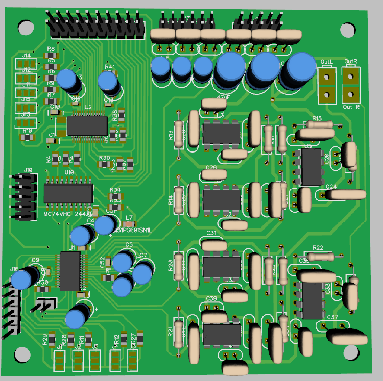

Been playing around with this design a bit. Since I did a lot of the work a few years back when I was designing my A/D pre-amp, it was a matter of copying some of the old design into this new design. Basically it is a pcb in the range of 7.8"x3.8" as it stands.
Here is the incomplete schematic/design and a placed pcb with no routing.
I was thinking to make a dual footprint for opamps, as requested, use all singles instead of duals. I used all TH films cap in the sig paths, 3.3uF PP are large beasts.
The PS I am contemplating where to situate.
I did a quick power cal, once again based on the original A/D pre-amp design and will attach the spreadsheet to look at and use for other design work/modification as req.
So a taste of what my version looks like.
I was also thinking to add extra features to make it a more functional unit and test bed for some other circuits I have in the works to be proto-typed

It is a interesting problem to solve.
Are you running separate grounds for the WM8805!?
I thought it was best to tie the P/D grounds together locally to the dgnd for this part.
The PLL is in the digital domain.
Right at the bulk caps at the power connectors on your pcb, is not the best way, if the a/d grounds share the same wire back to the PS star ground.
I believe one should tie a/d gnds together at the PS star ground points.

I'm treating PGND on the WM8805 like an analogue ground so I need to bring it to analogue ground as well. I assume it should be a star ground somewhere.
Digital supplies aren't designed yet but I was assuming they would be isolated from analogue completely. I was thinking of joining grounds at the supply caps for the 15V rails for the DAC output buffer hoping they would filter out anything the bead didn't.
Wolfson recommends the connection be made right under the DA converter with a wide trace. Cirrus' Eval module is on one ground plane as well.

I'm getting closer on a prototype design for my DAC. I haven't got any onboard voltage regulation and my analoge ground and digital grounds are still separated. Where is the best point to merge the grounds? Right at the bulk caps at the power connectors?
Assuming a dual secondary trafo or even two separate trafo's , a chassis
star would be the final destination for both the digital and analog 0V.
I do this on my slewmaster / 21'st century - digital/analog "mix". 0V is
clean on my digital board. No false triggering and the ATmega's rail
is quite clean.
The digital ground here is hooked right to the 4 cap returns on the big
star. NO issues. The analog on the pitchfork won't be (decoupling) anything
in the same realm as a 200W power amp !

That makes sense. The extra wire length would help filter it as well.
Do you think this will be okay with remote regulation or should I wait for a shunt design to place near the devices?
