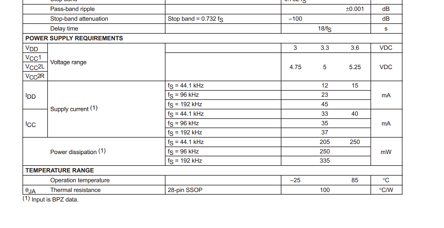

I'm looking at the PCM1794a data sheet trying to figure out power requirements. Is the Icc current draw per Vcc input or total for the device? Do I need to design for 50mA or 150mA?

Okay to answer your?
The current for pcm1794A Icc is total for all pins. If you multiply out (Vdd * Idd) + (Vcc * Icc) it works out to the 205mW as stated for the 44.1k bit rate.

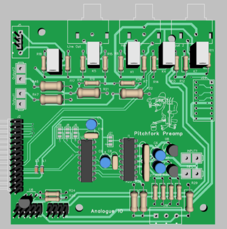

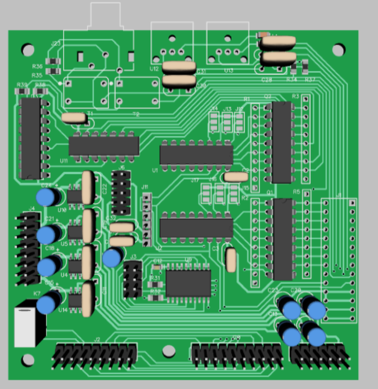

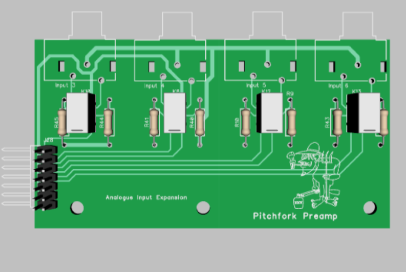

I'm making a little more headway. Just the display board and supplies to go. It's modular with up to 6 analogue inputs and 4 digital ins. The DAC also has a connector for a WaveIO USB board.

Post your schematics/gerbers and i will take a look, if you want someone to do some checking for you.
On your dual RCA conns, they spec a slot for the mounting tabs. I assume you are using the Kobicon (161-4219-E) or equiv from CUI. It can be non-plated since it has no connectivity. How do you plan to get your pcb (pcbway) fab to make them?
I'm using CUI RCJ-2223 jacks. PCBway has no problem milling slots. They use a CNC router to cut he boards so slotting isn't a separate process.
