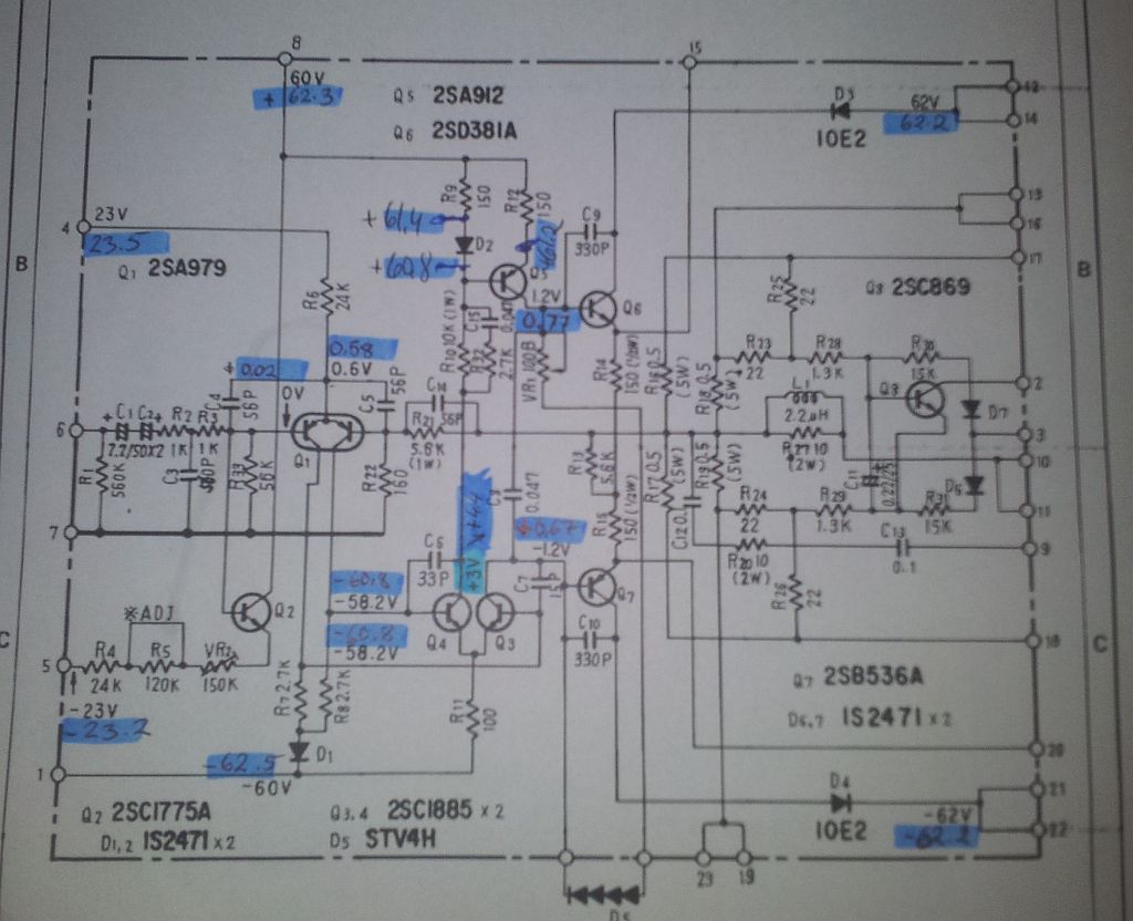

I hope you haven't spent too much time on the next step, because I discovered I had left 2 resistors up in one end (R7,R8) :headbash:
That said I did read the voltages listed on the schematic:
HTML:
                        Read	Spec
intersect. C4,C5,R6:	-0.6	(+0.6)
intersect. Q1,R3,R33:	-0.02	(0.0)
Q4c			-7<-	(+3)
Q4b-R8			+60.6	(-58.2)
Q3b-R7			+60.56	(-58.2)
Q3c			+1.0	(-1.2)
Q5c			+0.83	(+1.2)
Note polarity is reversed 😕

Still struggling with power amp
Transistors Q1 (2 of them in the combo sub) Q2, Q6, Q7, Q8 have been pulled, and all read between 0.6 - 0.7 V e-b and c-b.
Q3, Q4 and Q5 have been left un-tested since they just have been replaced with new ones.
Q1 is now the combo of 2 KSA922.
D2 is replaced (was new from rebuild) again just in case, but with no effect.
I took a glance at the power meters, and when the relay clicks in right ch meter jumps to -27 db, and stays there, regard less if no function button is depressed (all out) or if any one is.
Just a symptom that right ch is srewed up, I guess.
Please see all the voltage readings on attached image.
:worried:
OK, cool.
Can you please check the big output transistors (the ones we keep unplugged so far) with the ohm-meter, the same way you did it before with the other transistors?
We need to make sure none of them is shorted.
Also, please measure the voltage, putting the leads between the pins 15 and 20
