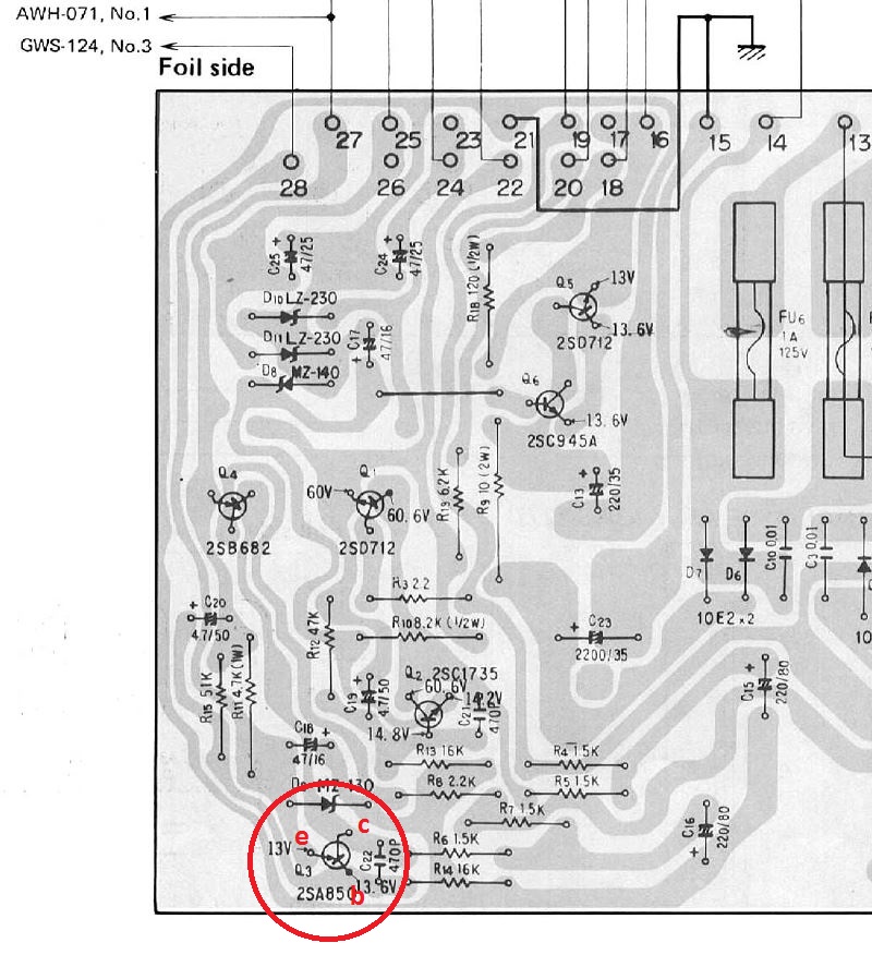

OK, I guess Q4 must be broken as well:
Neg to left Pos to ctr: 0.0545V
Neg to left Pos to Right: 0.0538V
Neg to ctr Pos to left: 0.0556V
Neg to ctr Pos to Right: 0.0024V
Neg to Right Pos to left: 0.0540V
Neg to Right Pos to ctrt: 0.0027V
10 ten years ago I had the power supply assy fixed after serious overheat, and then changed Q4. I have kept the original B682 that was there at the time and it checks out what in my limited world seems normal to 0.59.
Since I do not have other replacements at hand I would like your opinon as to put it back in?
Yes, Q4 is definitely shortened (bricked)...
I think, if the original one looks good (try to check it the way I mentioned above), then it will be ok to put it back in.
The question is - what made the previous Q4 shorten... overheat? because of overload?
Is there some heat-sink on Q4?

My problem is that I never seem to understand exactly where e-b-c pins are. I have looked at a spec sheet for one of the trannys I purchased for this project, and from the depiction in the datasheet: http://www.fairchildsemi.com/ds/KS/KSA1381.pdf
I would place the trans (PNP - Pos-Neg-Pos) with the fine type print up (readable), lead pointing i my direction I would have emitter to the left, collector in center and base to the right:
Do I want to connect my red test probe to 1 (e), and test 2 (c) and 3 (b) with the black testprobe?
That gives me OL (out of limits) and 0.68V.
I will then connect black to 1, and vice versa...
That gives me OL (out of limits) and OL.
Then if I flip the trans over I will now have base-collector-emitter (left-center-right), and connect black to left (base) and red to center(coll) I read 0.68V
and move red to right (emitter) i read 0.69.
Right, it is shown top side (with prints on it) up.
Then the left pin is (e), the middle is (c) and the right one is (b).
First check e-to-c both directions. Must be nothing (infinity).
Then put the red probe to (b) and touch (e) and then (c) with the black one.
Then put the black probe to (b) and touch (e) and then (c) with the red one.
In either first or the second case it will show some resistance b-to-e and b-to-c.
In the other case it will be infinity.
That's the right behavior.

Well, yes there is a heatsink, I made from scrap PC-CPU heatsink, back then 10 years ago when it broke down with leaking main (22000) caps, scorched power supply etc.
Q4 and its neighbor Q1, has this which has been working since then. However I have reduced the size in order to reduce their weight, because I belive that the weight was the main reason the before mentioned damage to the lead-track.
Also during the whole process I have been touching the heat sinks of Q1 and Q4 to deget a sense af activity, and the whole time Q1 has been luke warm (ca, 40deg) and Q4 has been COLD.
I have taken this picture af the current heatsink for Q4 (Q1 it the same).
Here with the old, original trans mounted, as we talked about:
https://drive.google.com/file/d/0B-K7vfu8iewrMkl2VjV5X3BRWTA/edit?usp=sharing
https://drive.google.com/file/d/0B-K7vfu8iewrTVpRSVlZNG5jVXc/edit?usp=sharing
I hope you can see these ?

Q4 - now we know why it was cold. It was dead 🙂
Heatsinks are rather compact, but look fine for the purpose.
If there are no mistakes in power amp assembly, current consumption from -60v rail is not nore than 20 mA per channel, giving us 40mA in total.
Voltage loss on Q4 = 76 - 60 = 16V, so power it has to handle is 16v * 40mA = 640mW.
Reasonable. Just need "something" to allow minimal heat dissipation.

Now I'm so much in doubt exactly how to place the leads on Q3 on the board. I'm sitting trying to make the correct pairing, and right now I believe that :
1. emitter goes into the hole nearest the corner where it says '13V' and 'Q3' on the foil print
2. collector goes into the hole towards the center of the board , and
3. base goes into the hole closest to the long edge of the board just above the '0' in '2SA850'
emitter is the left lead when transistor has flat edge up, leads pointing to me
collector is center and base to the right.
Please advise
Like this:
https://drive.google.com/file/d/0B-K7vfu8iewrT1FNRDJHOGplYUE/edit?usp=sharing
Here we go - attached
you're right - emitter is the left lead when transistor has flat edge up (the one with letters), collector is center and base to the right
