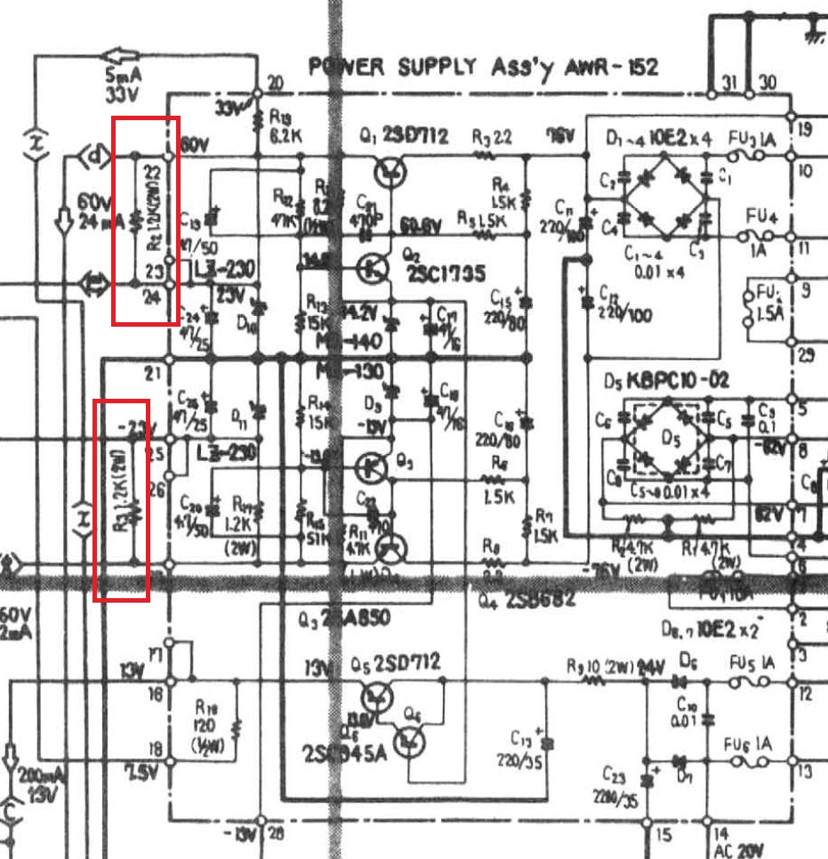

On the PSU I see resistors (silk sleeved) on 22-24 and 25-27 - but I fail to find them on the schematic?
I'll unsolder and check values...
That's fine, they are visible on overall schematic...

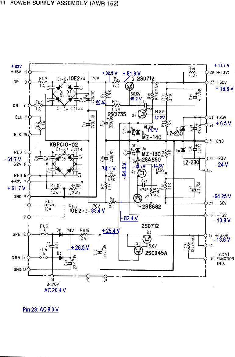

Picking up on the project again.
Since I have been unable to track down the error on the power amps, I backtracked to the power supply where I found a few issues:
pin 20,22 and 23 are way off:
pin 20 reads +11,7V should be +33V
pin 22 reads +18.6V should be +60V
pin 23 reads + 6.5V should be +23V
Power supply - schematic w. readings: Thumb 1.
Before this Q3, D9 and R6 were fried, but even after replacement, these bad values remain.
During diagnostic tests D10 and D11 have been replaced, but without any improvement/change, and until I can get hold on a D8 (Zener 14V) it is an unknown (doesn't seem to be available in DK, but I'll have a couple added to the back order I have with mouser: New 22000µFs 🙂 ).

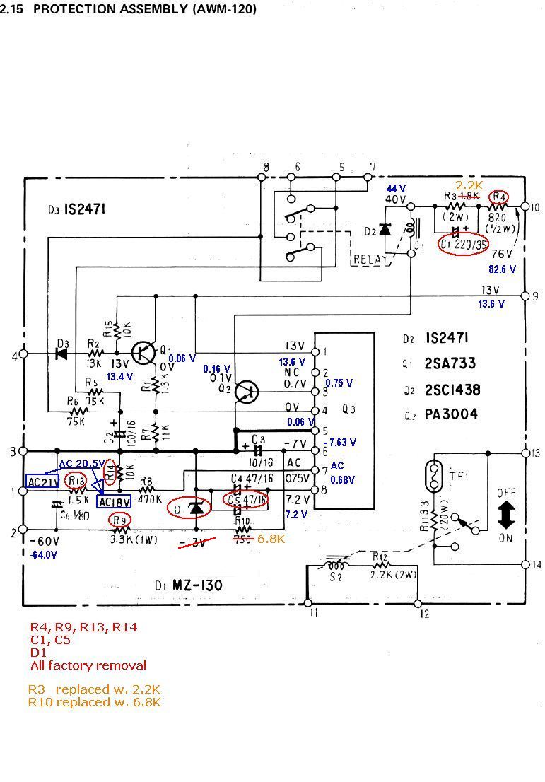

I did also look into the protection assembly, which has no less than 7 modifications compared to the Service Manual:
Protection assy - foil view w. modifications: Thumb 2.
The readings I get seem correct, the modifications taken into account, but I may be wrong?
Protection assy - schematic w.readings: Thumb 3.
I've checked and re-checked the power supply, and to the best of my knowledge all components are mounted correcty.
By now I'm dry for ideas,:h_ache: so I hope for a hint that will take me to the next step.
/Ole

Hi Ole,
Looks strange. Remember, we were fighting for -60V rail (pin 27 of power supply), which did not work?
From what I see at your drawing, it is ok now (showing -64.25, which is acceptable).
Now +60V rail (pin 22) does not work. Did you change Q2 or something in the upper side of the schematic?
Valery
Correct, Valey, D9 has been replaced, since the latest readings I have posted.
I guess I'll have to wait until the MZ-140 14V zener arrives before there can be any new meaning ful tests 😕
Yes, D9, R6 were fried, and Q3 was replaced once more, just in case (was new), which moved the faulty reading from pin 27 to pin 22 - sorry, I seem to loose track along the way between posts😀

Good news
Ahhh, finally some positive to report 😀
To cut it short the error regarding the voltage on pins 20, 22 & 23 is now solved. The culprit was a broken trans, namely Q2, which makes a lot of sense when you look at the schematic.
All voltages are now within +- 0.5-1.0 V.
I received the latest parts from mouser yesterday, and now the power supply has been allmost completely rebuildt. The only parts that hasn't been replaced are the D5 bridge and the ceramic capacitors.
Later today (or possibly tomorrow) I will reassemble the unit - the power amps have been unmounted, and I also have some new main caps to install.
