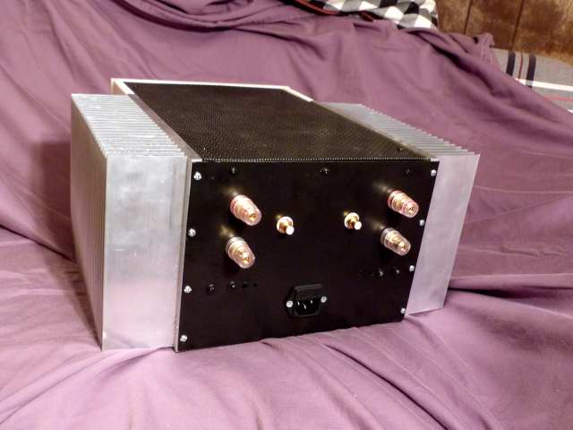

the pieces in not cut out yet 🙂 but i will cut out a piece of the top plate glue the grill under it. and glue a frame under that. then screw it all together.
Hi bobodioulass
Just found your amp photot, looks great. Can I ask where you got those two heatsinks from please?
Also looks like you went for 4 caps rather than 8 in PSU. Are they 30,000uf per cap?

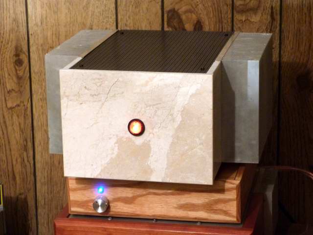

New F5 is born
Many thanks to Nelson for this great design. I just completed my build today and it is a worthwhile improvement over the RevC amp that I have been using. The improvements that stand out for me are improved clarity and depth of image, blacker background, and better base. This is my first experience with class A, very nice. The hardest part was building the case, I usually use wood because it's relatively easy, but this burning class A amp thing got me worried so I made it out of noncombustable components. Runs warm, but I can comfortably touch the heat sinks.

Is that a marble front panel?Many thanks to Nelson for this great design. I just completed my build today and it is a worthwhile improvement over the RevC amp that I have been using. The improvements that stand out for me are improved clarity and depth of image, blacker background, and better base. This is my first experience with class A, very nice. The hardest part was building the case, I usually use wood because it's relatively easy, but this burning class A amp thing got me worried so I made it out of noncombustable components. Runs warm, but I can comfortably touch the heat sinks.

The heatsinks are from heat sinks USA, the 10.04 profile and 7 inches long

Hi vdi_nenna,
I got the perforated metal on the top from Home depot, it was already painted. Also got the marble tile that I used for the front and sides from them. I attached the marble by drilling holes part way into the back and epoxying in threaded bolts, then bolted the marble to the metal frame. The downside is that this amp is very heavy.
What isle? 😀 I'll figure it out.

Yeah tell me about it...😀
