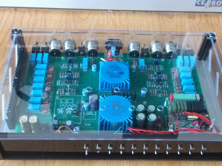

My UGS Preamp
I made this for three years. 🙂
2sk389BL,2sj109BL,ztx450,ztx550,remote contol,acryl-sash
