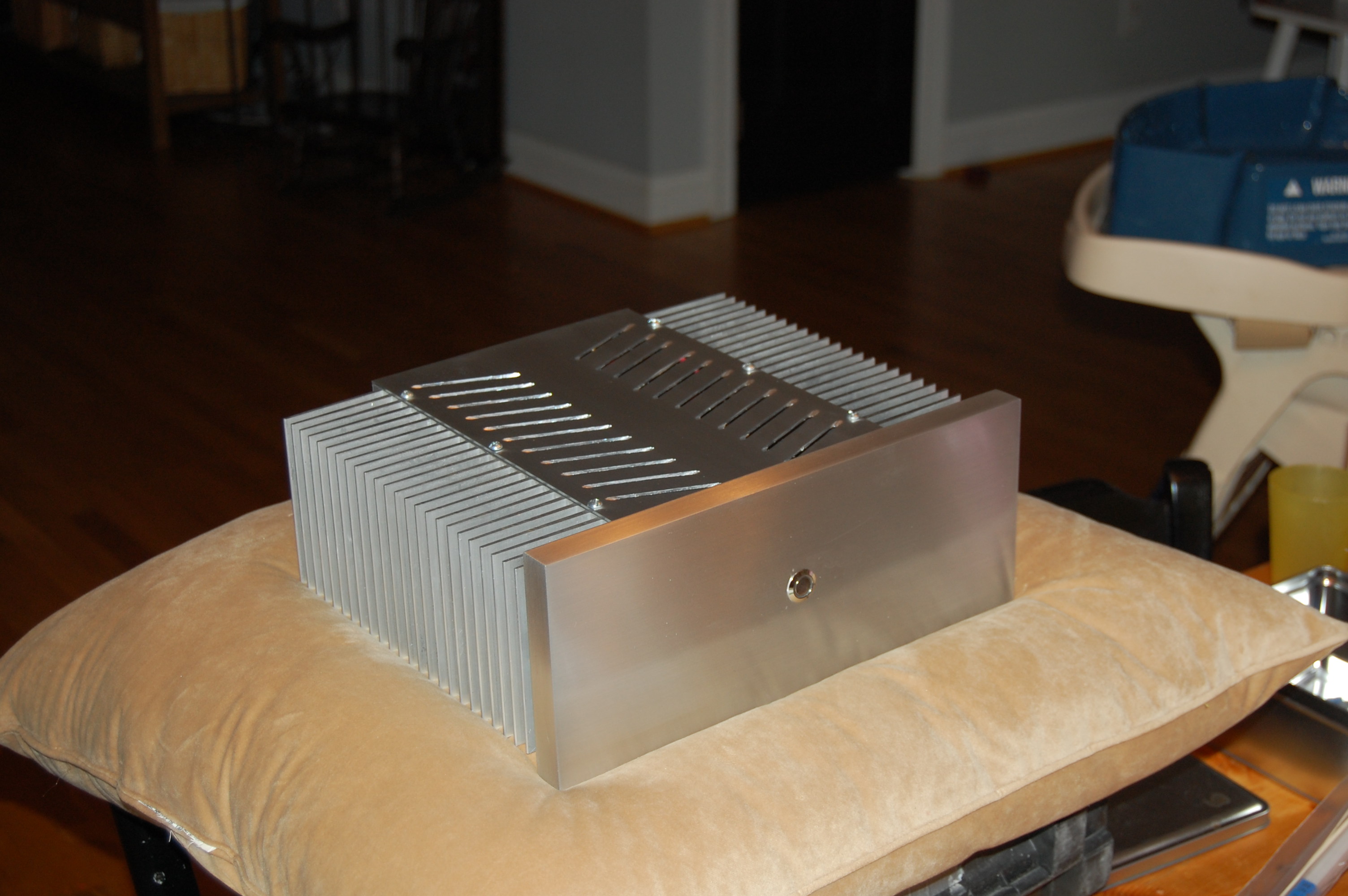

10.080" profile from heatsinks USA? 🙂
how did you do the top vents?
Yup. 4" tall. Amp is biased @1A . Perfect for high efficiency FR. Uses the AJ where it is strongest. The top was done with small 7 1/2" chop saw on 22.5° angle. Turned out real nice, i think. Auto enamel as top coat for a little shine. Looking for something tougher. Any suggestions.

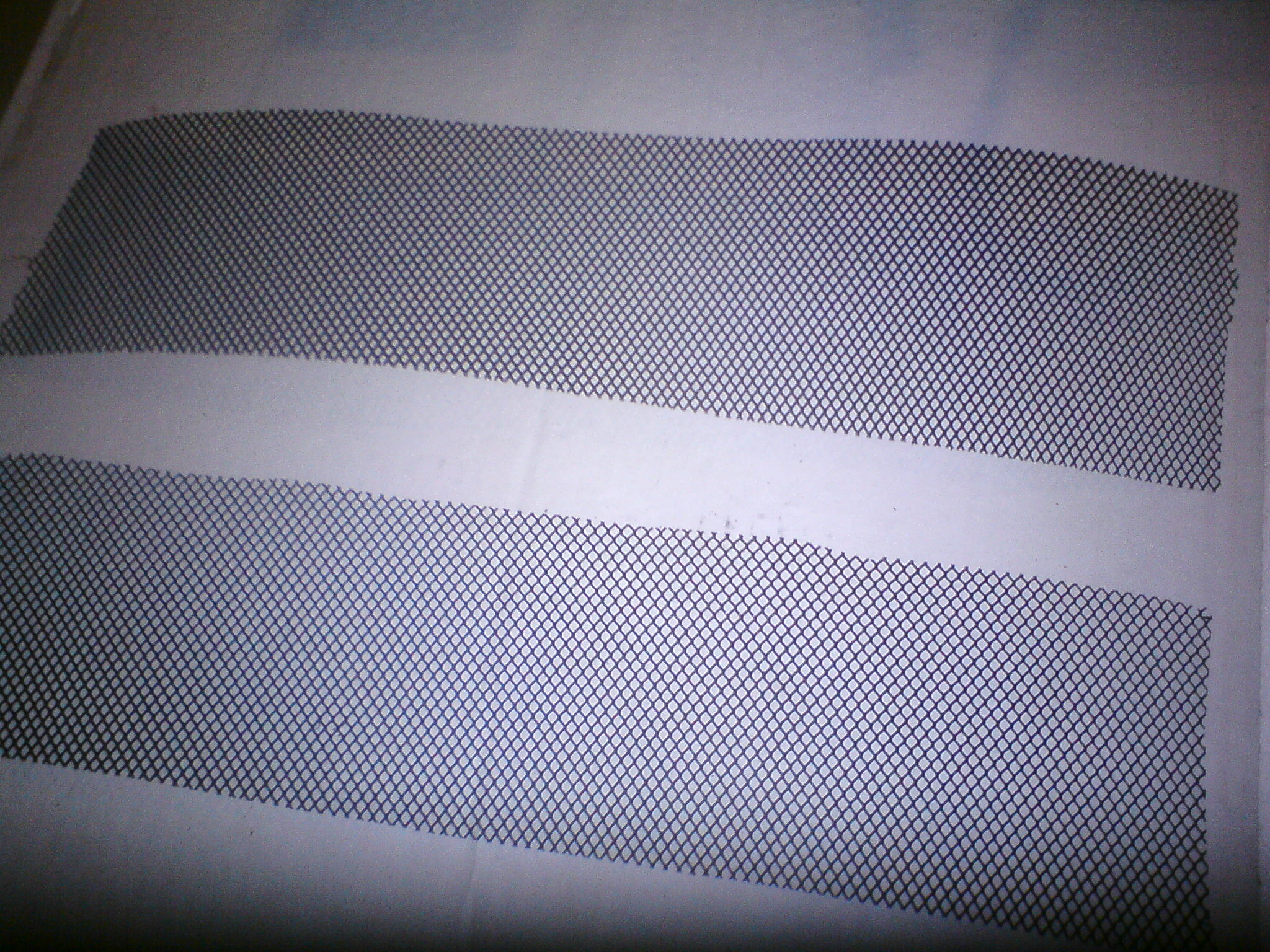

nice 🙂 i plan to use a papir basket as top vents 🙂
glued betwin 2 layers of aluminium that is screwed together.
