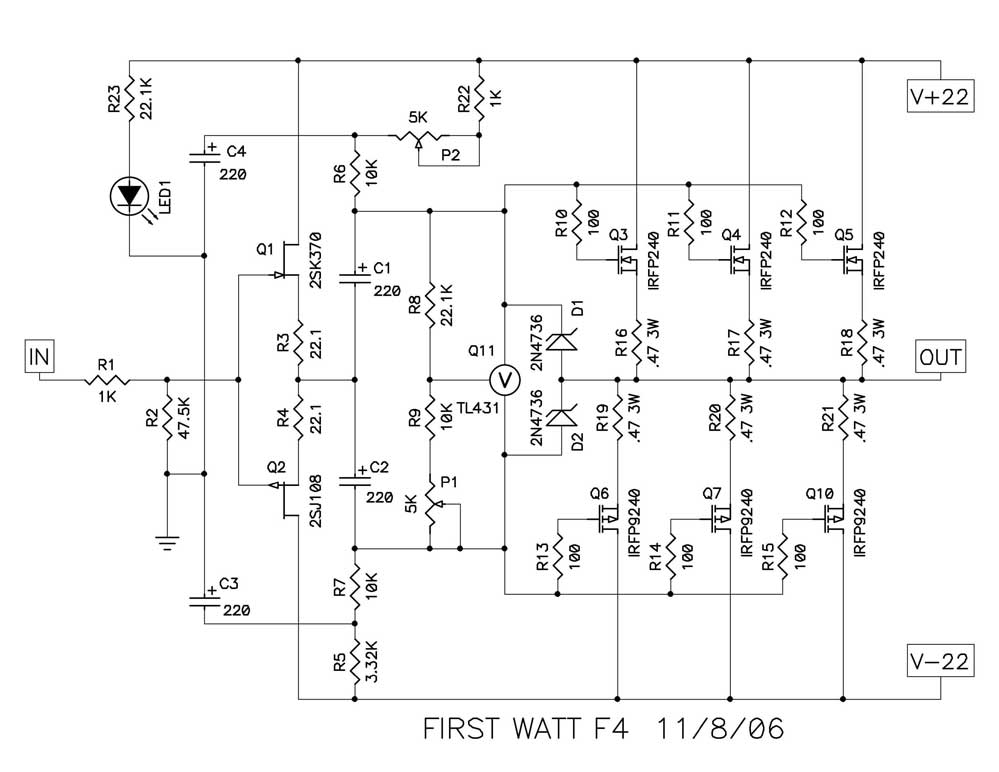

Huh...i googled pass amps...f5.. aleph...firstwatt...pass zen...etc and i do not get it. all these builds and talk of how but no schematics. a schematic is not a theory 4electure or a simplified inference. where are these elusive kept secret schematics?
after reading 1000 pages and having built an amp or two what is the deal?
Dont forget here - Technical Articles
Also, if you googled "Pass Aleph (or F5, f4, zen, etc...) schematic" and didn't find anything it's because you didn't hit 'images'.
thanks i found f5turbo on firstwatt. but i did hit images on my searches and didnt find none. are his larger newer ones available? passlabs dont have no schematics do they? not under downloads. I am spoiled by tubecad. thanks.
. .. ..... .. ... .... . ... .. .. . ....... .. .One day someone may post some in braille.
Here's one for F5. In TubeCad go to: File->Import->Braille
Edit: Apologies; It's actually the newer, larger one - F5TurboV3
Zen v4 - http://www.passdiy.com/pdf/zen-v4.pdf
F5 - http://www.firstwatt.com/pdf/prod_f5_man.pdf
F3 -
F4 -
Burning Amp 1 - http://www.passdiy.com/pdf/BA1 r1.pdf
Burning amp 2 - http://www.passdiy.com/pdf/BA2 r1.pdf
Burning Amp 3 - http://www.diyaudio.com/forums/diyaudio-com-articles/194809-burning-amplifier-ba-3-a.html
