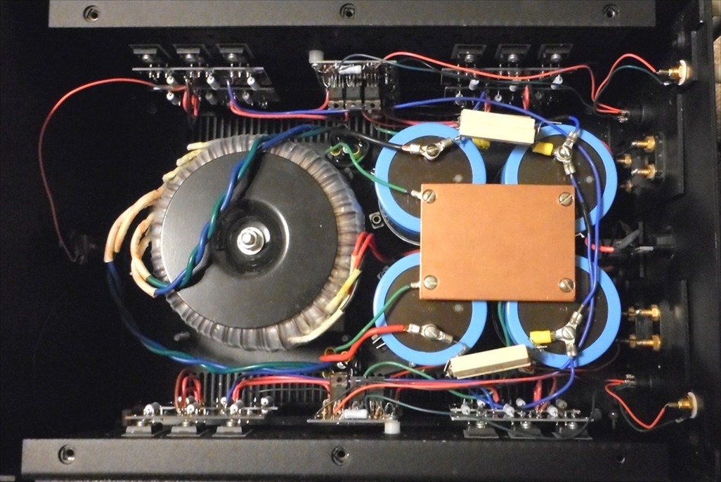

Didn't build it. Had Tim Rawson make it. The original transformer by Krell failed and was irreplaceable. It's an Aleph 2 clone with all Pass Labs boards. I fashioned the bus plate from 1/4 inch copper just because it looked cool. The fins are almost adequate. In warmer months it can start getting too hot, so it's my winter amp.
Mr Rawson must be a pretty smart guy.
Personally, i don't quite see how to get 2 times 300W dissipation from a KSA150 chassis, that was designed to handle 300W total at idle, aka 75W per heatsink.
(e.g., the official Krell brochure of the MDA300 model states 400W dissipation from 6 of the exact same heatsinks, same chassis as the KSA250, aka 67W per heatsink)
At least the front end boards have Mr Rawson written all over them.

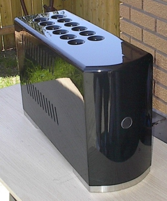

Wooden chassis
Here is my wooden chassis a40. Its been up and running for about 10 years and for the past 3 years it has been running 7 hours per day, 5 days per week with no trouble. I made it from a cut-down bed rail that I purchased for $3...
