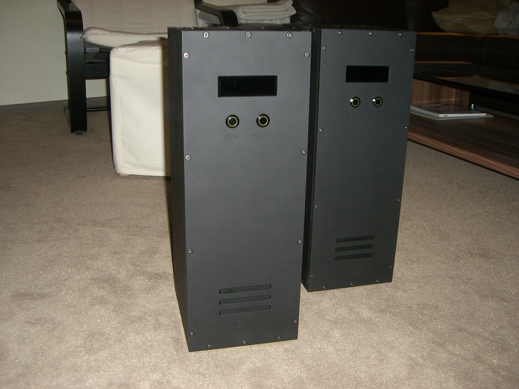

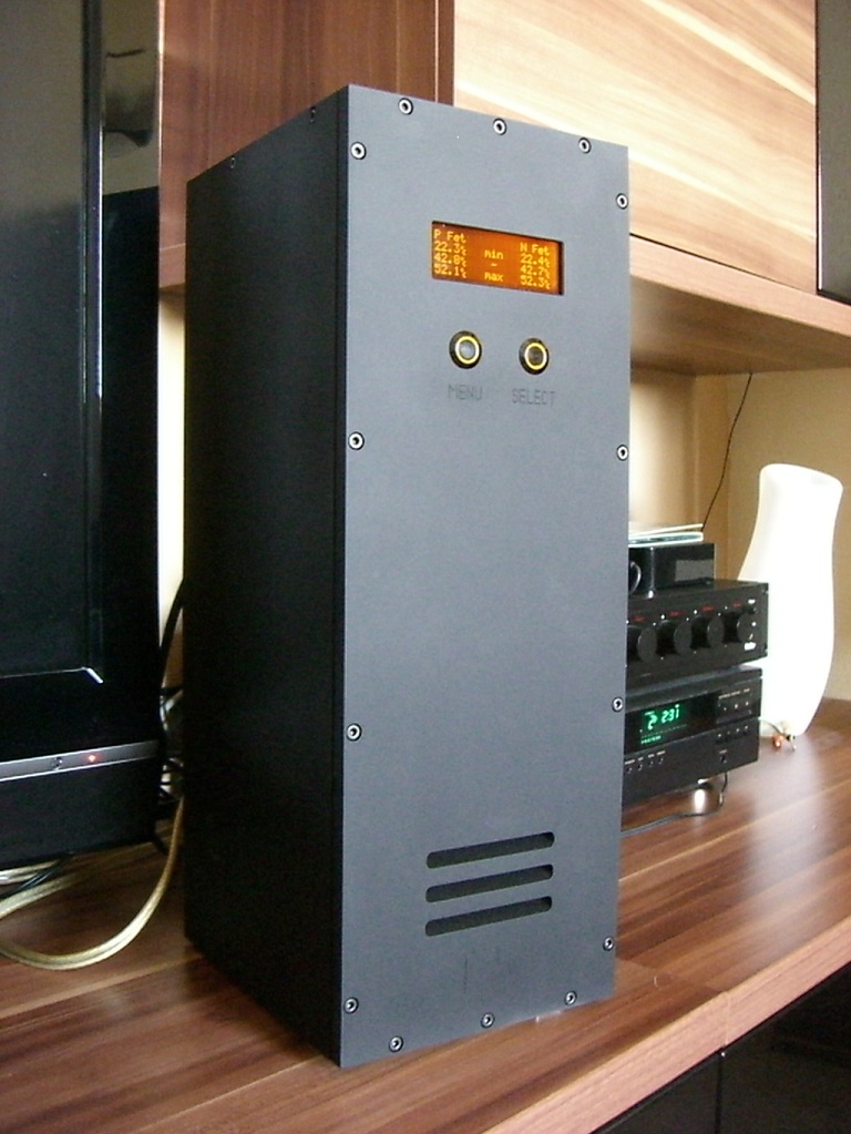

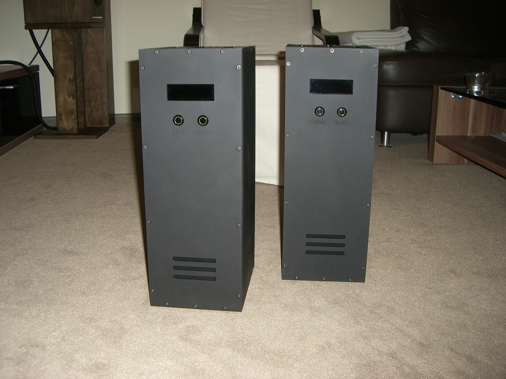

I (proudly 😉) present my two F5 mono-blocks.
Since semptember 2011 I worked on them- it is too much to tell, but now they are ready to make some fascinating music for me.
The case is made from 10mm aluminium, which is anodized in non-glare black.
Heatsink is the back of the tower case, it was CNC-milled to fit all the in/ouputs.
It was really hard work, I learned much about programming and working on some atmega's and displays, current-measure-IC's and mechanical things.
The PCB's are from the diyaudio shop, and they are perfect!
I have to make some pics from inside, but in the moment its a little bit chaotic.
They sound sooooooo nice, I am speechless.
THANK YOU SO MUCH EVERBODY HERE, especially NELSON! (and thanks to martin from austria for all the emails and tips!) 😉
(and sorry for my bad english...)

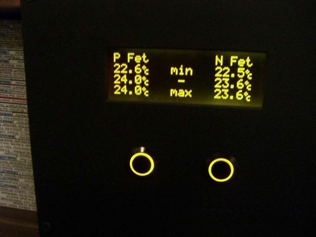

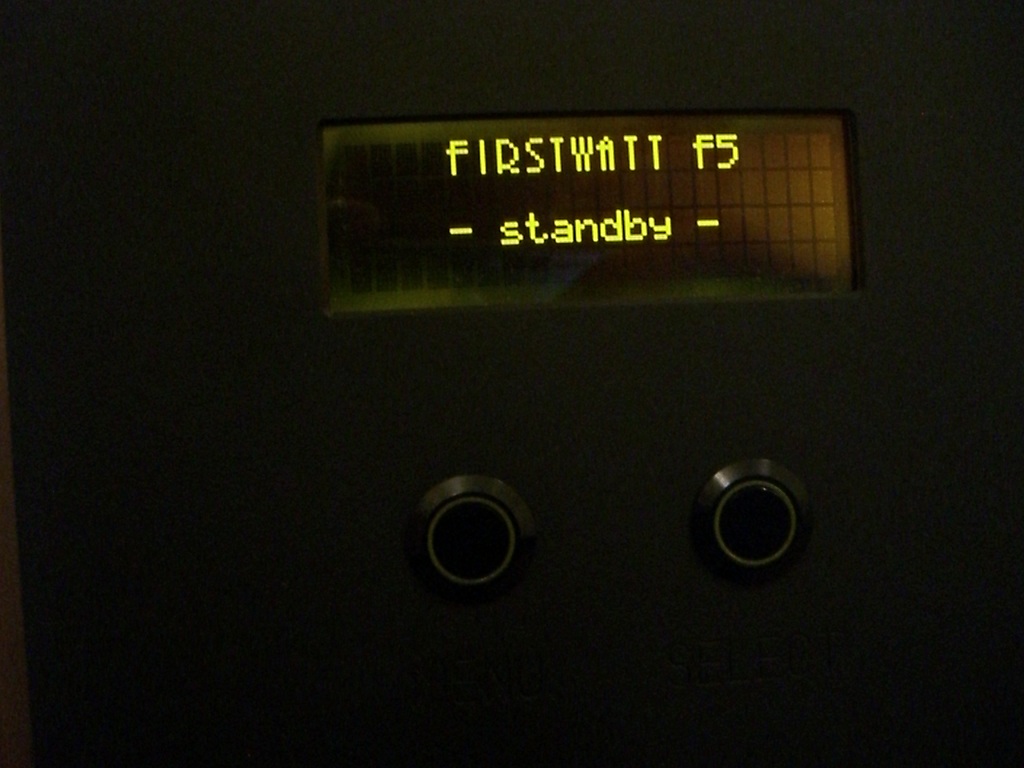

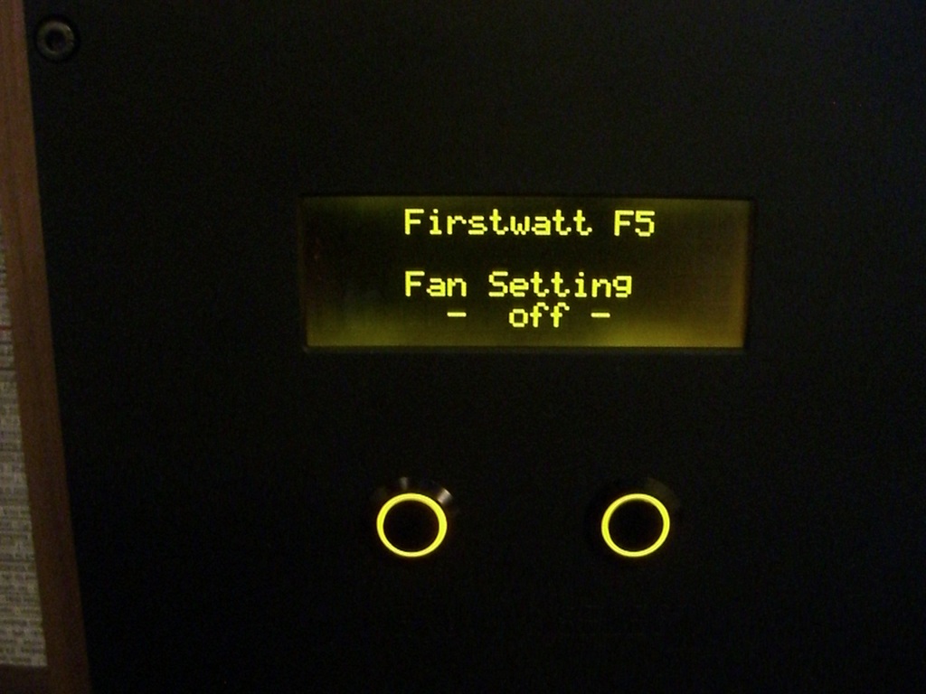

How did you do the cool displays? Is there a build thread?
hi everybody and thank you for your comments! 🙂
@NYCOne:
look at my thread here:
http://www.diyaudio.com/forums/pass-labs/198298-few-questions-about-f5-amplifier-3.html
(the video shows only the first steps of programming. some big software bugs are gone now...)
the displays are from ebay. I bought them from a guy in poland.
nice price, very good quality and different colors, too.
the switches are from a case-modding-webshop somewhere in germany...
cheers,
matthias

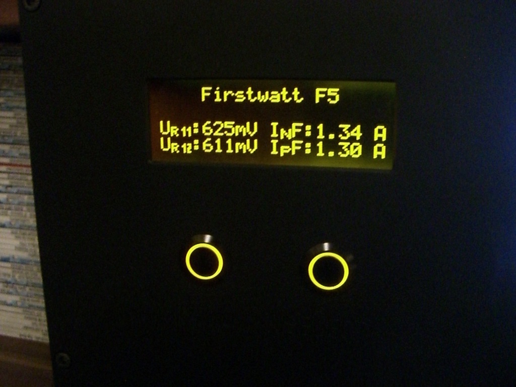

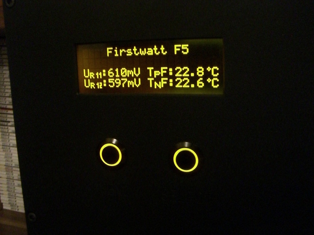

hi!
its very simple: you need to put the ACS712 in series to R11, and another one in series to R12. then let the software doing the rest! 🙂
ACS712 delivers about 185mV per ampere. as you know, R11 and R12 are 0.47Ohm resistors, so it is easy to calculate the bias with the controller.
I did it all with bascomAVR, a nice basic-programming tool for the atmel µC-series. If you need any help, feel free to contact me.

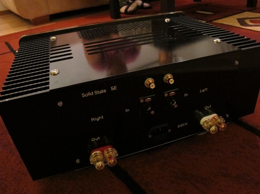

Very well done, and what a unique build!

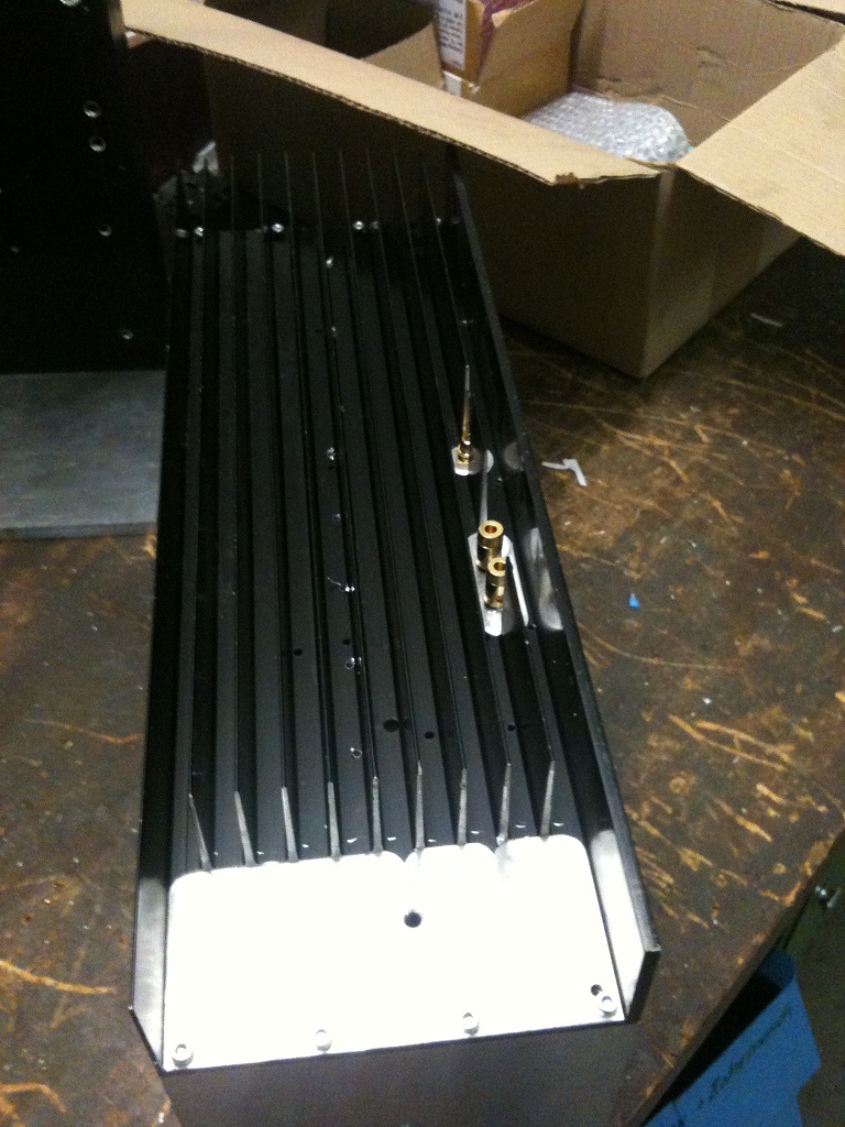

Do you have a photo of the back of the case? I am curious to see what the heatsinks look like.
hey!
ufff, only an old one, without the mainpower switch and the mains-connector. but with RCA and loudspeaker out.
I made it mirror-inverted, so the other case has got the connectors exactly on the other side of the backside of the heatsinks. (I inverted the amp-pcb and the capacitor-pcb, too 😉)
here it is:
here it is:

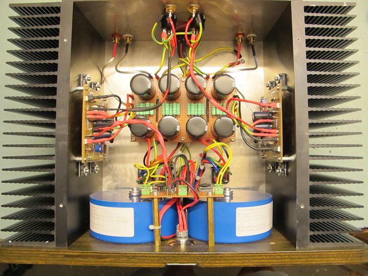

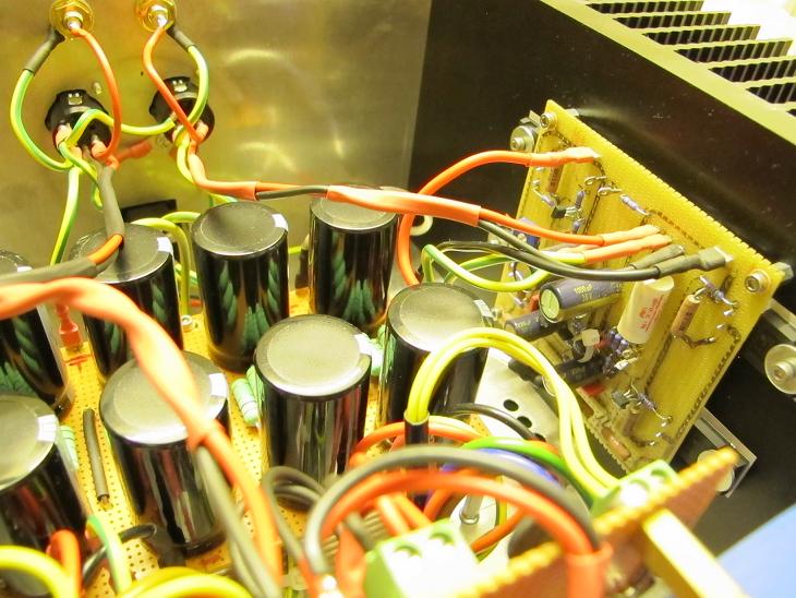

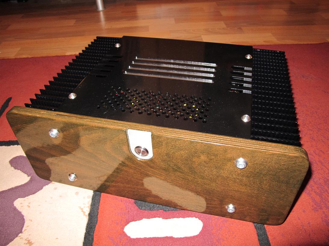

And another one
Here is my Aleph J clone 😀😀😀.
Same look as my F5 😀 ->
http://www.diyaudio.com/forums/pass...-your-diy-pass-amplifier-106.html#post2868496
But time all is DUAL MONO 😀.
All board are Point to Point wiring.
Layout is taken from the Aleph Wiki
