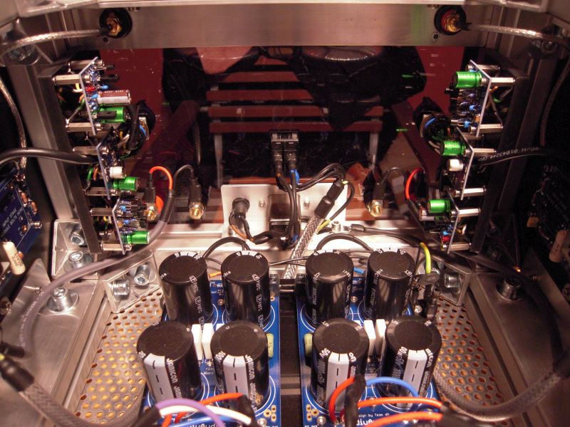

Dirk, your input switcher is great,
I hope the switching works well. I'm sure everyone on the M2x thread will be eager to hear your impressions, as your ability to do A/B(/C) comparisons of input boards will be beyond that of any M2x I've seen yet.

Hello Tim,
thanks for your appreciation!
I was thinking: How much time I would need to change the inputboards?
I also had the idea to put the main pcb horizontally into the amp and the Mosfets
vertical to the heatsink.
At the moment I am working on the aluminum and acryl to cover the case/
frame. So I have easy access to the inputboards. But when it is closed
that switcher makes it easier and faster to change from one inputboard to the other. Good for comparisons.
But hey! - The design of the boards is perfect!
Cheers
Dirk

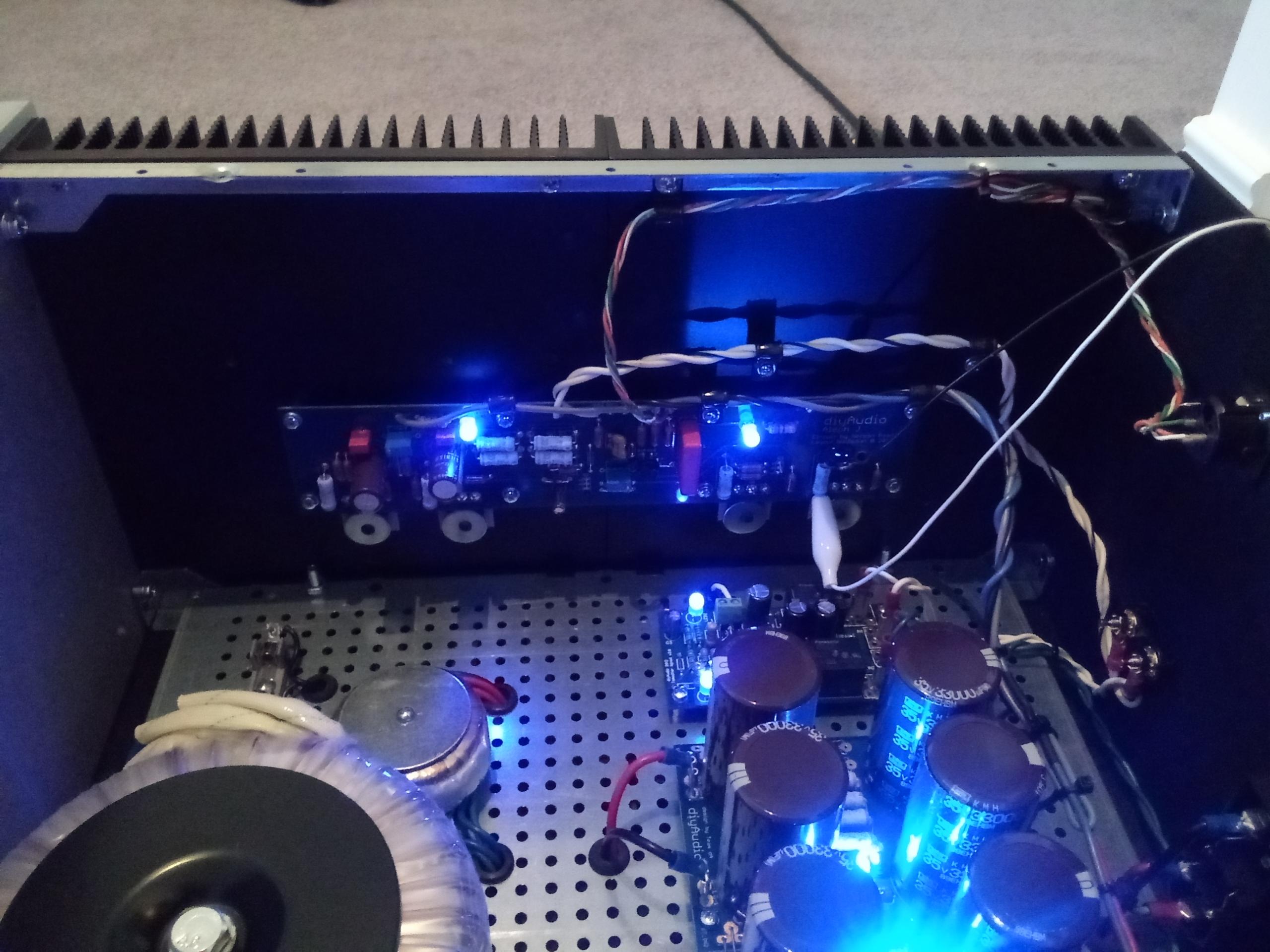

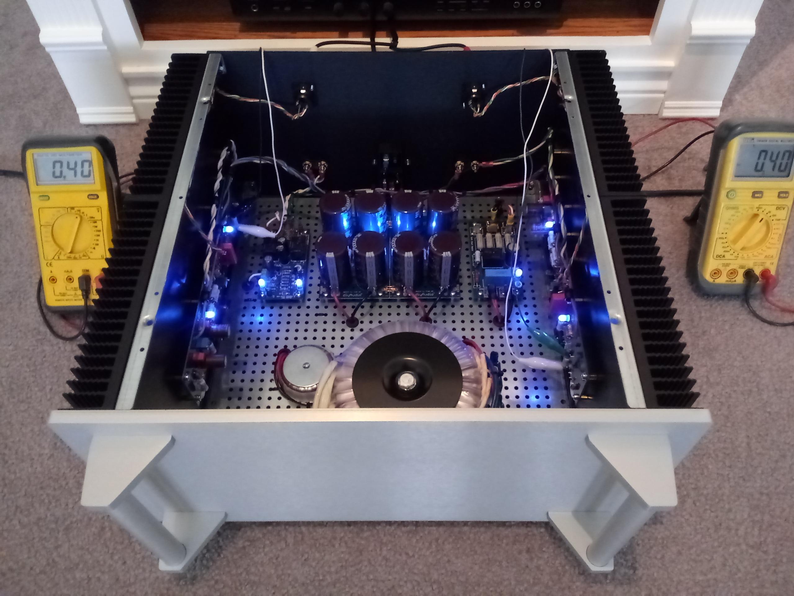

Alpeh J

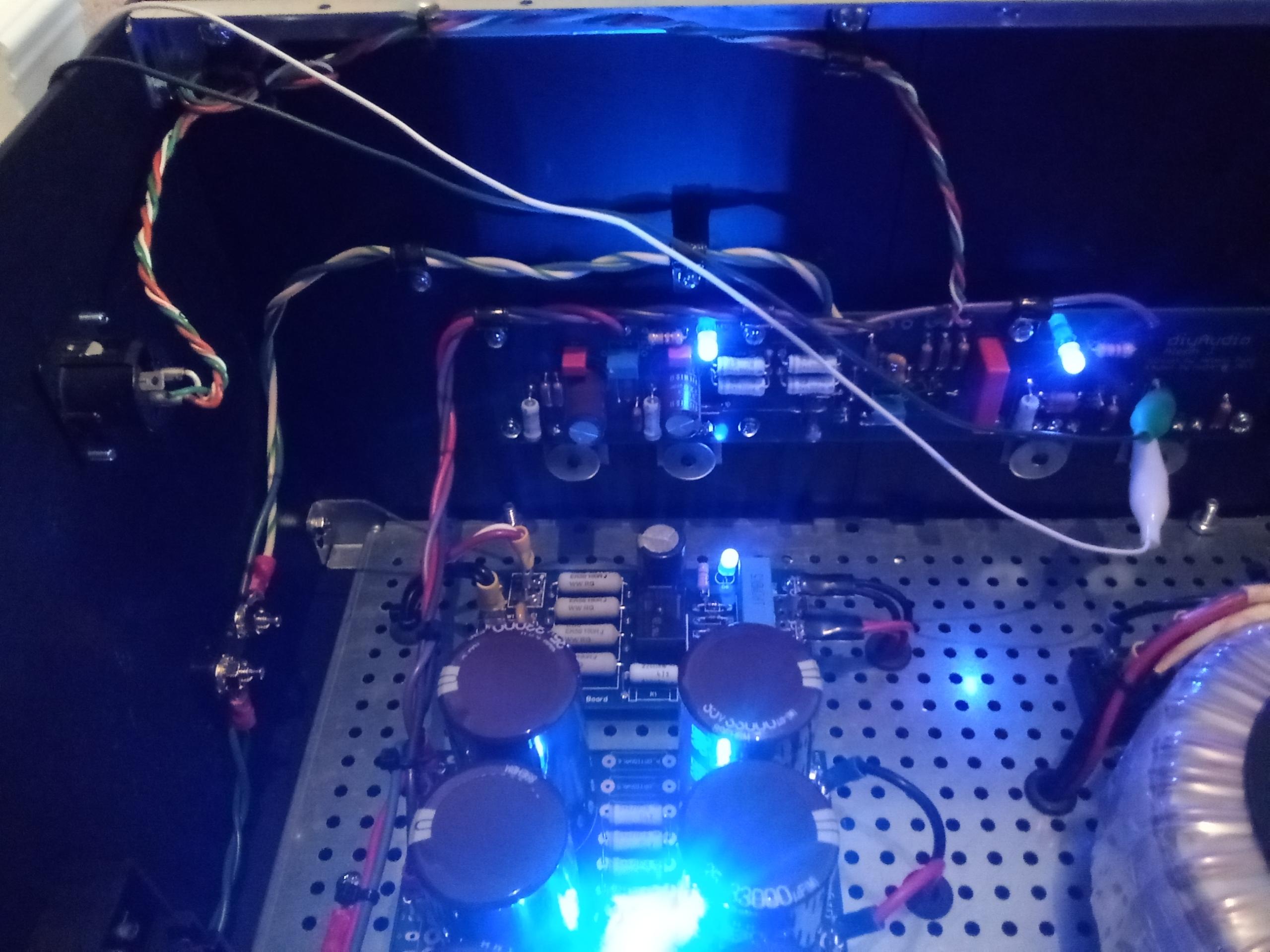

Just finished this last night. Relatively easy, straightforward build came right up with no issues and holding steady 40ma after 12 hours burn in. No hum no hiss on 96db speakers, looks like it's going to be a keeper...

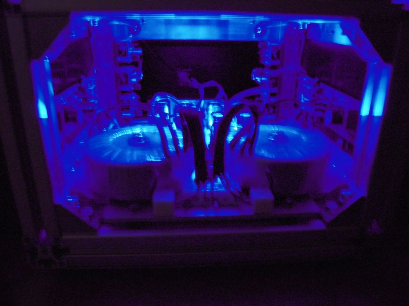

Hello ETET
looks very nice. I like the blue light of the LEDs.
Enjoy it!
Listen to the music...
Greets
Dirk

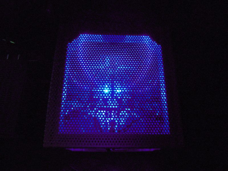

Dirk,
You have achieved a nice lighting effect. Reminds me of high end gaming PCs. 🙂

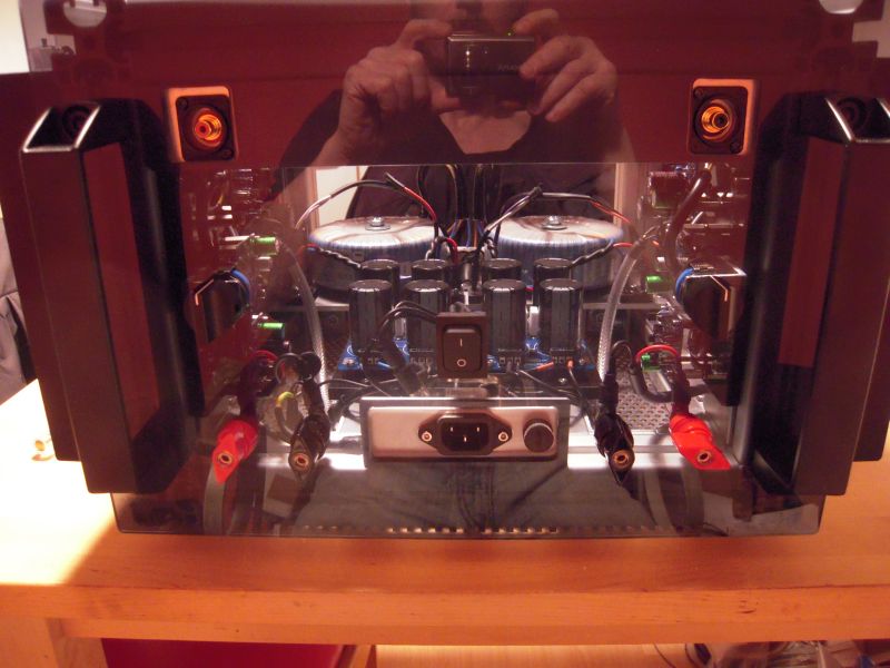

Cooking an M2X
Hello sound-gourmets,
the hooby-cook made a nightshift yesterday. Made the backpanel of the M2X.
Acryl translucent dark grey.
Drilling, jigsaw, file, sandpapers, polishing,.....
I feel like this
Cheers
Dirk
I feel like this
Cheers
Dirk

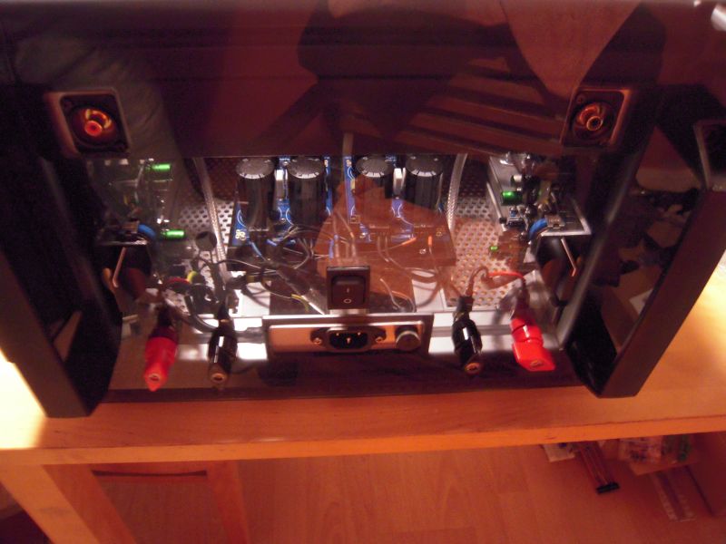

answer to SOV
Hello Sov,
I couldn't compare the inputboards soundwise. Yesterday I made the backpanel
and added the missing resistor on the Norwood board (thanks to the eagle-eyes
of Mark Johnson). And I changed the Resistor R6 and the trimpot RV1 on the
mainboard to get more adjustability of the offset at the outputs.
I measured - 44mV and - 49mV offset which is for me to high. Although I played
music over the M2X.
Waiting for my frontpanel.
Then more listening tests.
But I think I should describe that in the M2X-thread? This is 'pictures of your diy Pass amplifier' - thread?
Greets
Dirk
