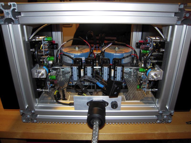

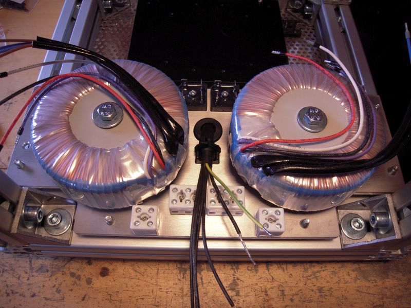

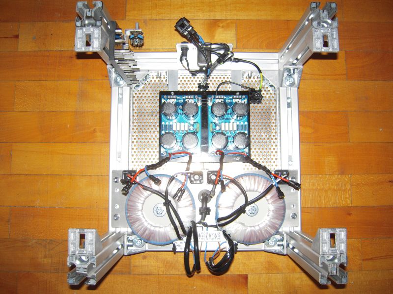

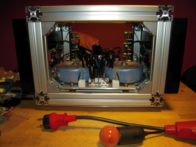

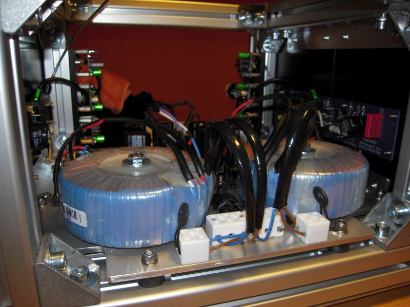

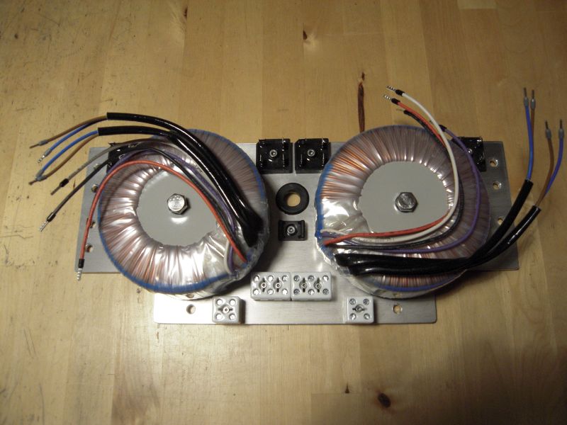

Hello diyaudio - members,
I`ve got a nice recipe for cooking a new amp - the M2X.
The south german hobby cook sends you some pics out
of his private `MUPPETS SHOW`.
Smorebroed rom pom pom pom....

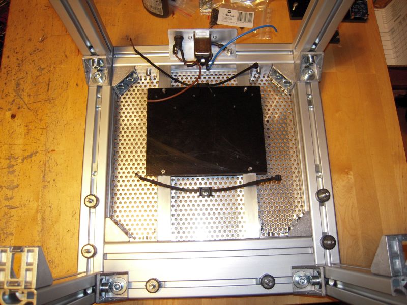

At first we use some fresh aluminum from the market and
build a little frame.
We need some volts and amps in our meal so let´s add two
SEDLBAUER-Trafos, nice PSU-boards from the diyaudio-
shop stuffed with some fresh fruits from Mouser, Conrad,
Voelkner and some other well known `fruit-dealers`.
Greetings from Dirk
Greetings from Dirk

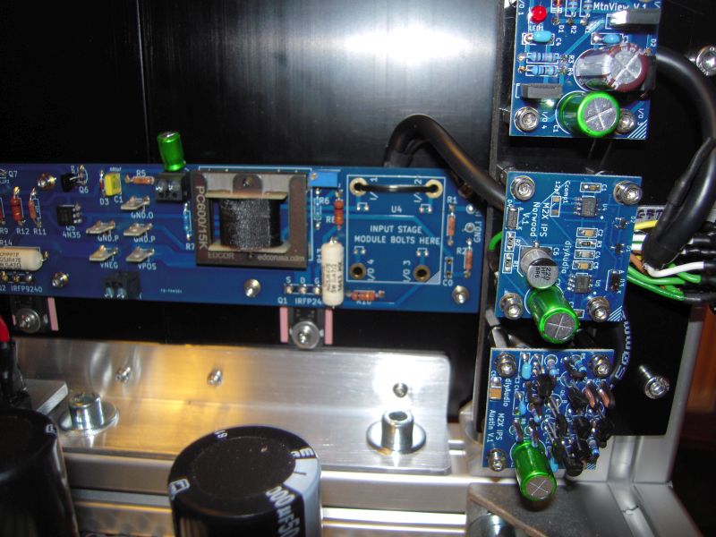

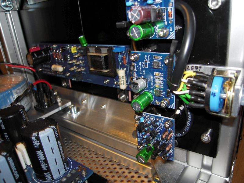

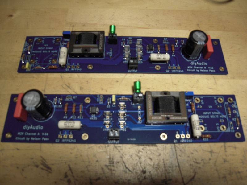

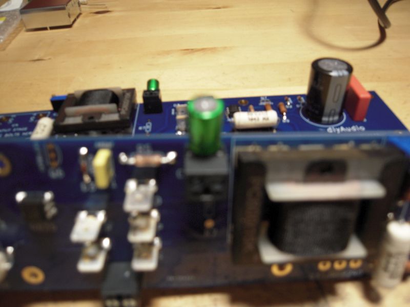

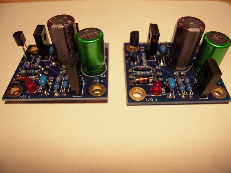

This wonderful meal needs some other ingredients - so lets have a look
on the other blue boards:😱

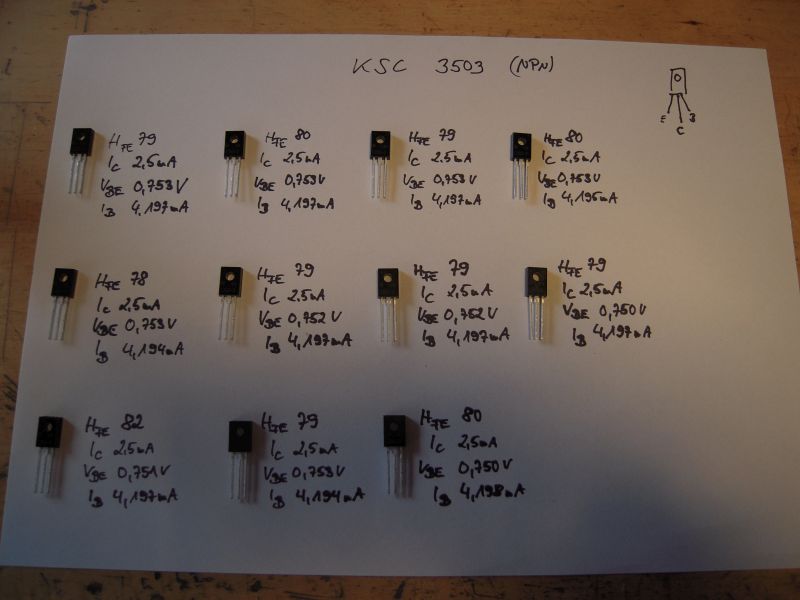

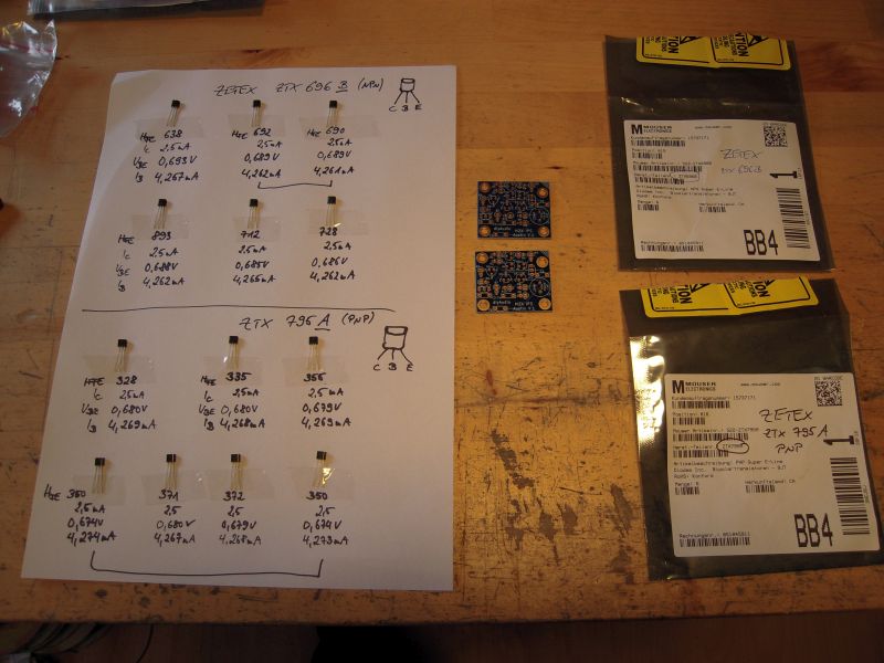

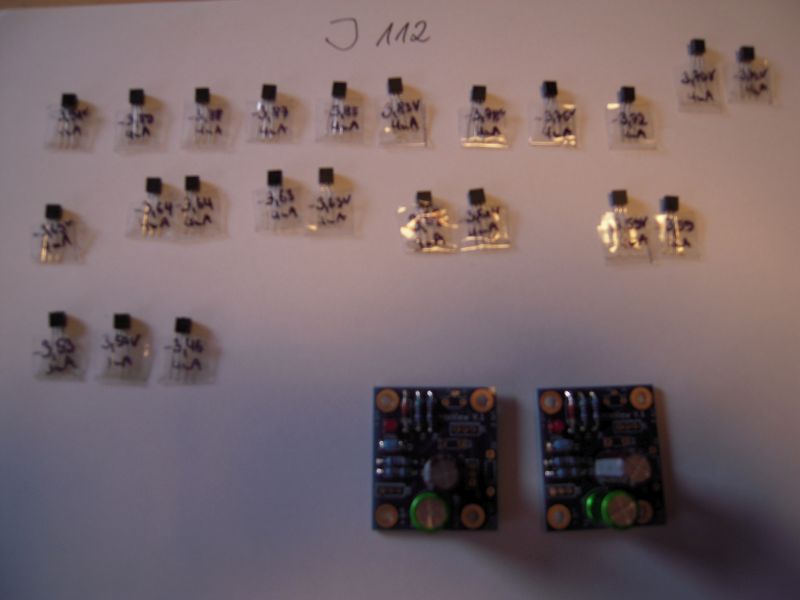

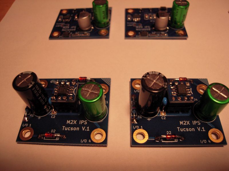

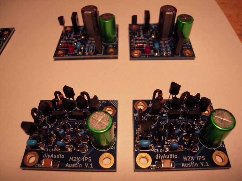

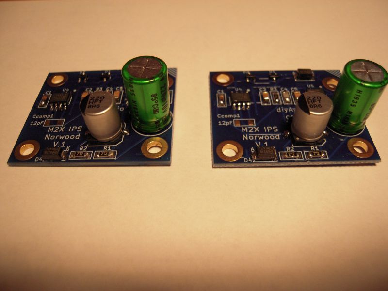

Cooking an M2X
input boards and matching transistors (although not necessary)

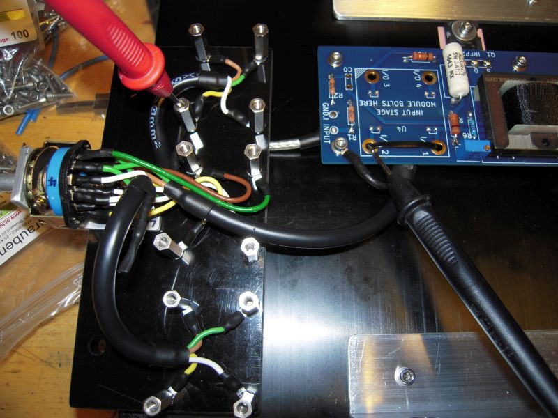

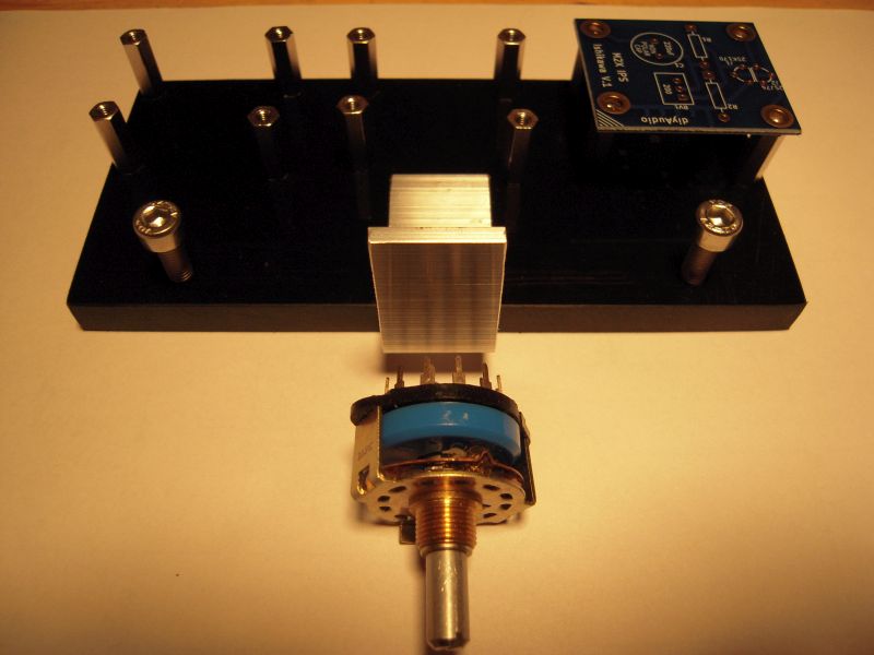

Cooking an M2X
I wanted to make another inputboard - sauce.....🙄
lets switch
lets switch
to Zen Mod
Thanks Zen Mod!
But I have to continue - pot is hot - and the menu shouldn´t burn....
Smorebroed ....
Thanks Zen Mod!
Smorebroed ....

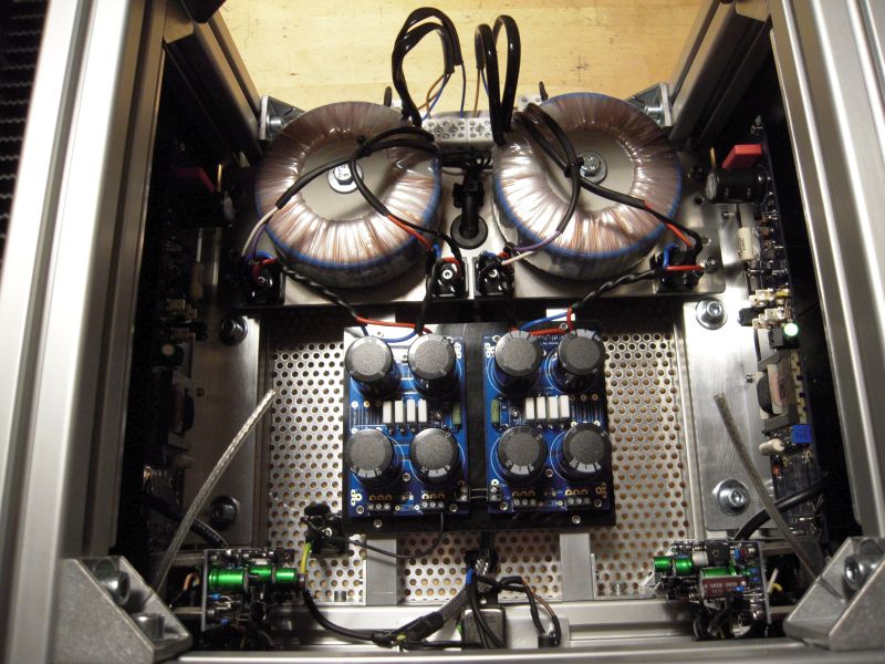

Cooking an M2X
We are coming closer to finish lunch...
The crazy hobby cook needs a break - burned fingers from hot soup
(waiting for some last ingredients - I hope the yellow submarine from
DHL will arrive tomorrow)
Good night!
Dirk
Good night!
Dirk

It is an unwise choice to omit Ccomp1 from your Norwood boards. Read paragraph 3 of the AD744 datasheet, and remember that Norwood is a noninverting amplifier with a gain of one; and if that's not bad enough, Norwood has some EXTRA phase shift introduced by the video buffer, that a plain ordinary AD744 standalone circuit does not.
https://www.analog.com/media/en/technical-documentation/data-sheets/ad744.pdf
answer to Mark Johnson
Hello Mark Johnson,
thanks for the hint with Ccomp1 on the Norwood board! 😉
I thought I read, that it should only be soldered in if a tube preamp is used.
But I read so much the last few weeks.
I will solder it in.
Have a good week!
Dirk
Hello Mark Johnson,
Have a good week!
Dirk
