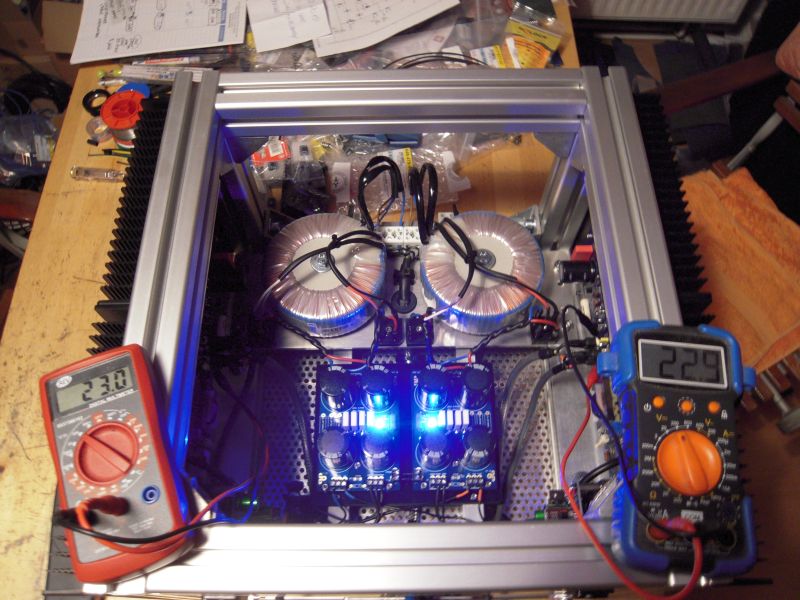

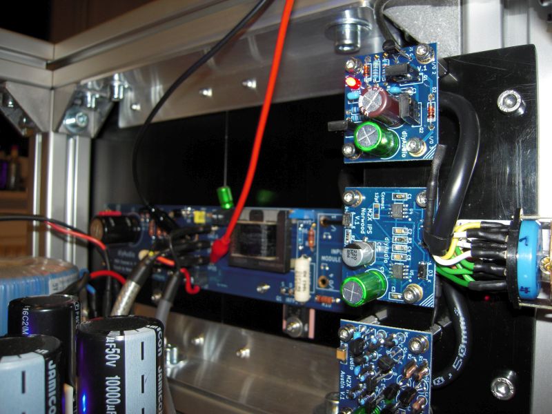

Hello members,
the M2X is playing music first time!
Thanks to Mark Johnson, 6L6, Nelson Pass and all other involved persons
giving us this beautiful soundmachine!
The first run is with cheap speakers (JBL Control 1). I wanted to be careful.
My first run is with the austin boards switched in.
Will avoid to use the Norwood yet. Thanks Mark Johnson for the tip.
Last second I read it. Perhaps I would have got fire in my 'soup'
Now I am testing / listening. Will report back.
Have a good night!
Dirk

Good you have some sound. Do you use 2x500VA toroid's for the project. Can you hear hum pickup from the Edcor's?

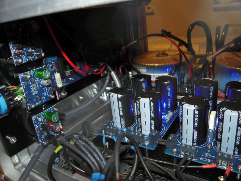

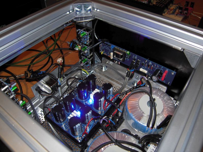

Hello Meper,
the transformers are from SEDLBAUER AG, Germany:
POLYTRONIK Rinkerntransformator - RSO 825046
2 x 18V / 250VA each
sec.windings in parallel - 18,0V and 13,89A each trafo
primary windings in line (2 x 115V = 230V) - inbetween the 2 primary windings of each trafo is one CL60 inrush current limiter.
These Trafos have shielding between the windings (primary - secondary)
and a Thermoswitch (120°C).
I have some very light hum. I am still testing. I have also a small metalcase
to shield the EDCORs. Wanted to try first without.

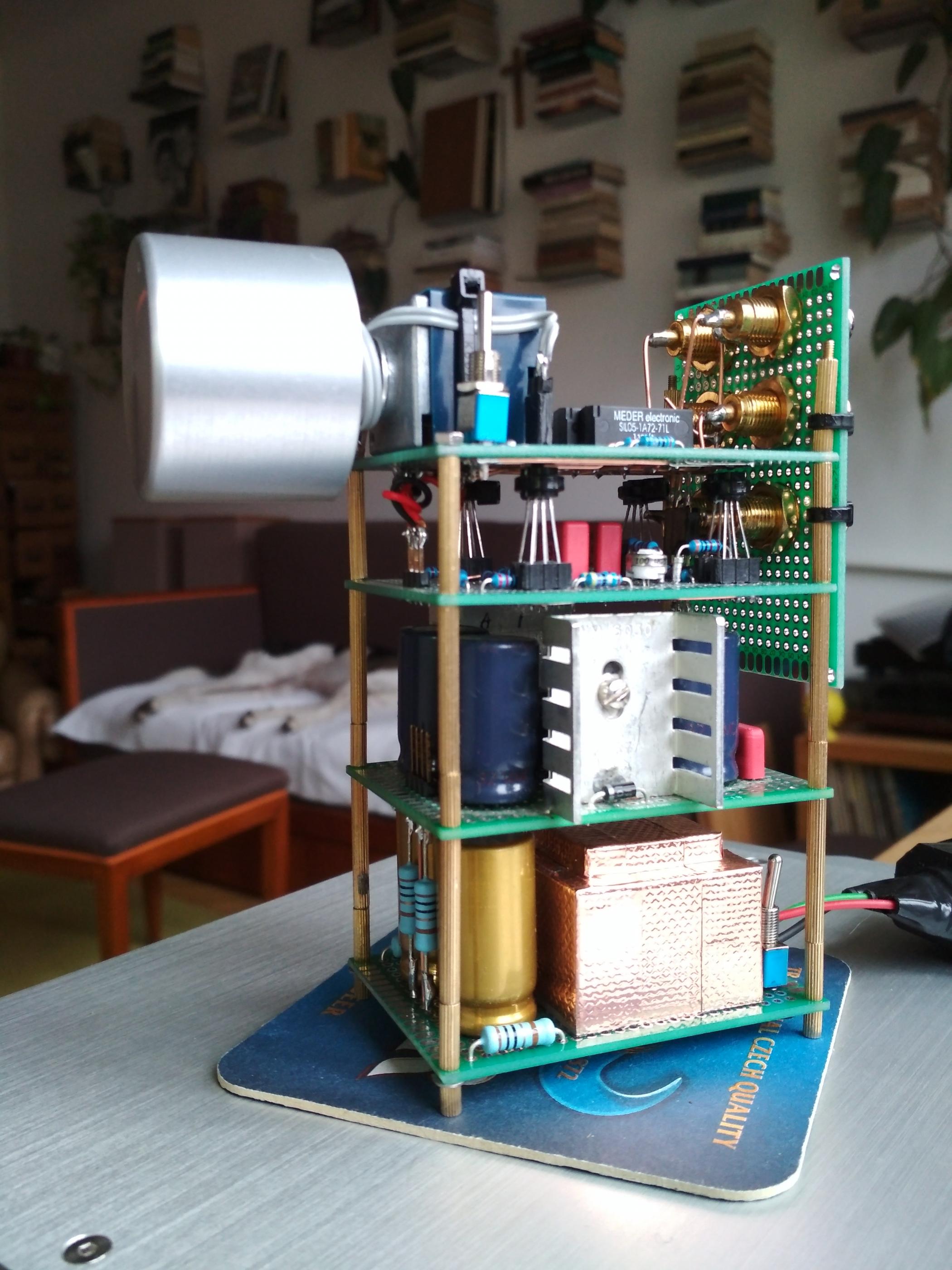

Hello ROOKAKOMA
this is a nice little soundmachine!
And a coppershielding around the transformer - I like that! 😀

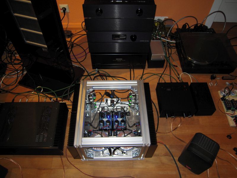

cubicincher,
Congratulations on your build.
If you would not mind sharing, what are the dimensions of your chassis?

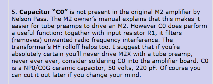

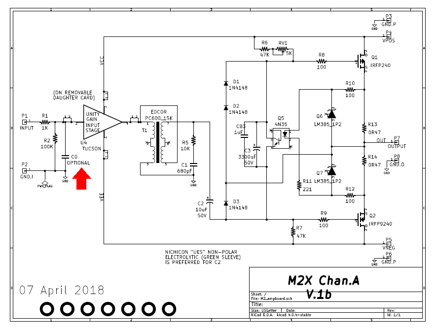

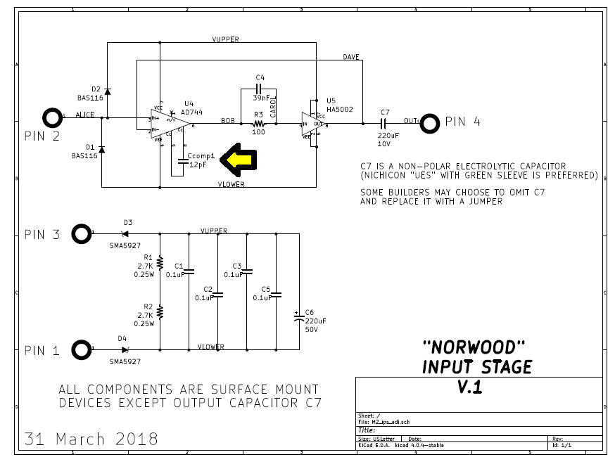

I thought I read, that [Ccomp1 on the Norwood IPS board] should only be soldered in if a tube preamp is used.
No, that's a mistake. "C0" on the M2x main board is optional, and Nelson Pass did not include "C0" in the original M2 amplifier sold by First Watt. This is called out on the M2x schematic AND in the Notes For M2x Builders at the top of the M2x thread.
Ccomp1 on the Norwood board is a compensation capacitor and is mandatory for proper circuit function.

answer to Mark Johnson
Hello Mark Johnson,
that was my mistake. I should not interchange informations about the Norwood inputboard with infos about the mainboard! Exact reading is a necessity.
Thanks for your attention and your good eyes! 😱
I add the Ccomp on the Norwood - I already purchased it with all the other parts.

answer to zman01
Hello zman 01,
my case measures:
width: 38cm (aluminum frame / case)
width with cooling fins: 46cm
deep: 40cm
height: 28cm
I hope that helps you.
Greetings
Dirk
