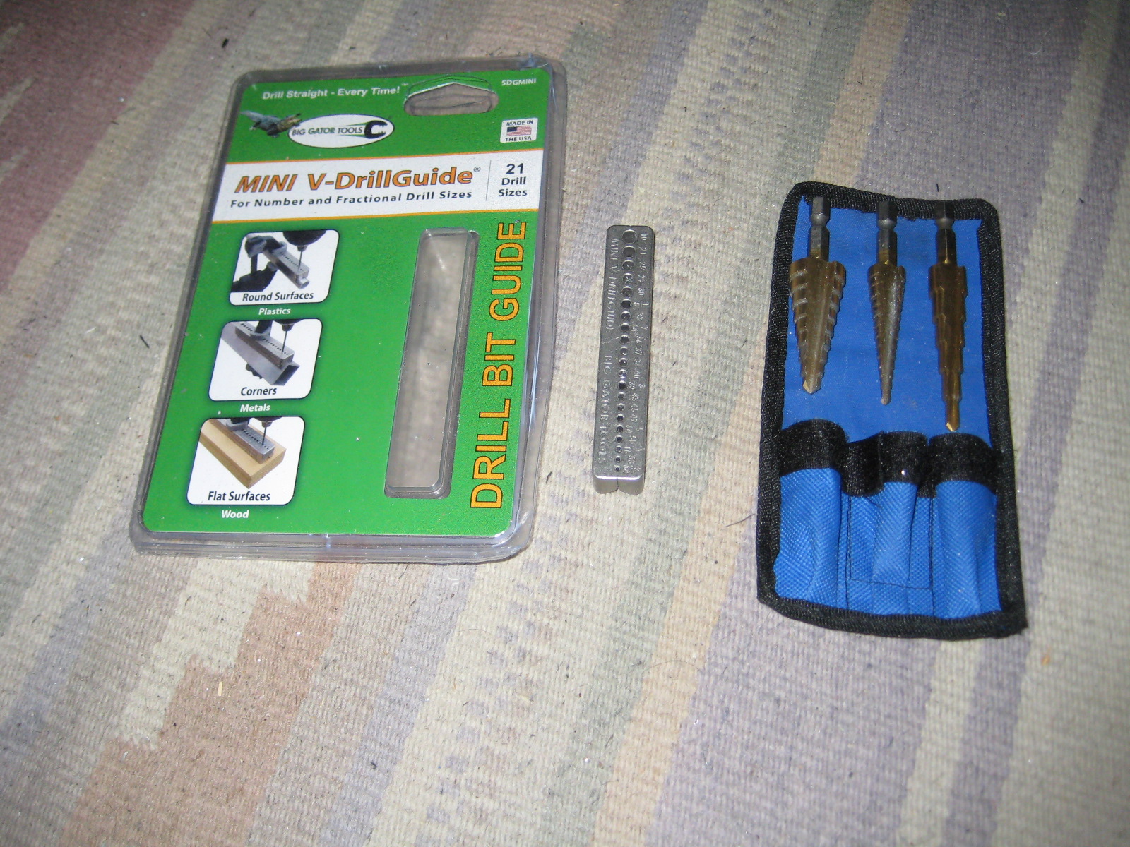

Stepped drill bits are great for drilling larger holes in aluminum. The largest bit in my set is 19mm but I have seen them as large as 35mm. These bits drill perfect circles in aluminum and thinner steel. I have used them to drill ventilation holes in bottom panels, connector holes in back panels, and holes for round led switches in front panels.

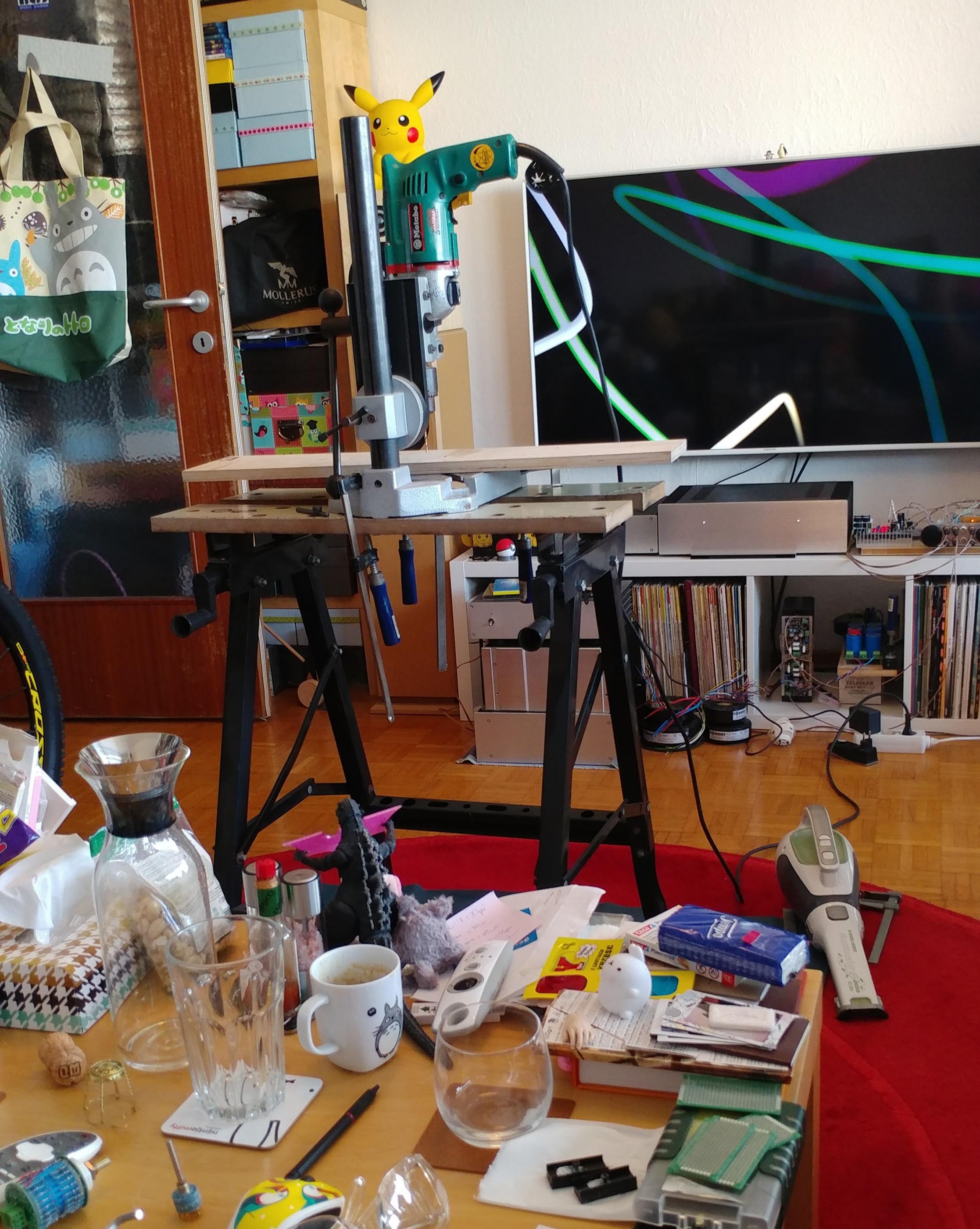

Another very useful drilling tool if you don't have a drill press is a drill guide. I use a drill guide to help in drilling and tapping heat sinks. It keeps the drill bit and tap perpendicular to the surface of the heat sink. It requires a bit more work but I don't have much choice since I have no room to store a drill press.
The drill guide is very nice…..will get a similar. I have a hole saw set in bimetal. Will try them first in aluminium to see if they works.
Bimetal hole saw will work fine on aluminum. Just run it a bit slower than you would with wood.

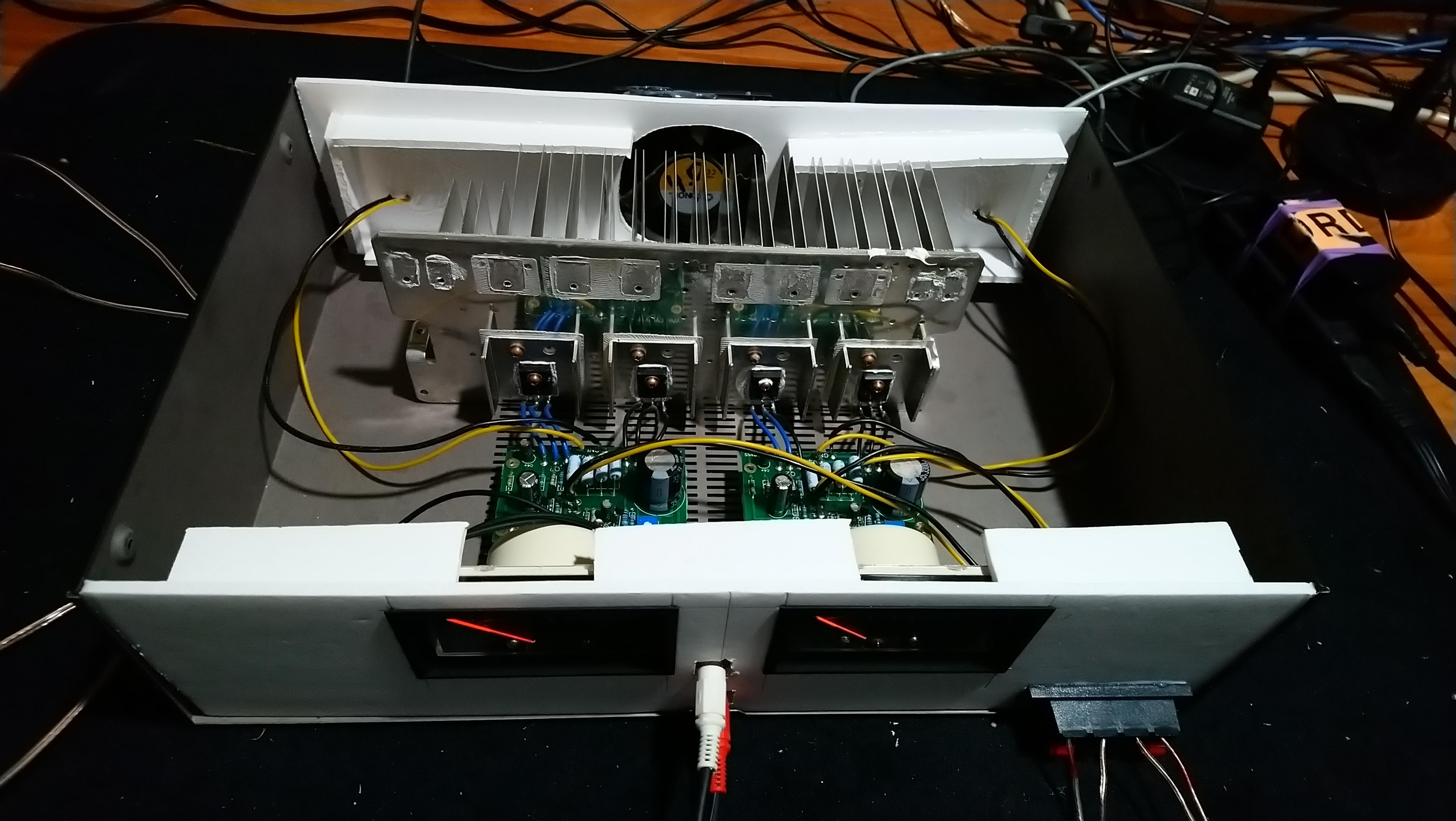

Since this is pics thread...this is ACA I made today, we got snow day. This is my 4th ACA. Sounds sweet. Thanks Nelson.
Is that foamcore board? Do you have cornu spirals too?
Adason, that's too cool. I've never see VU meters in foam core. I love it!

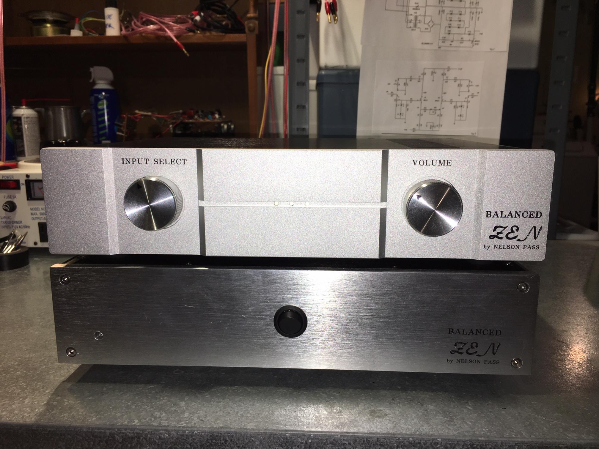

Elwood, your Balanced Zen is a looker!
