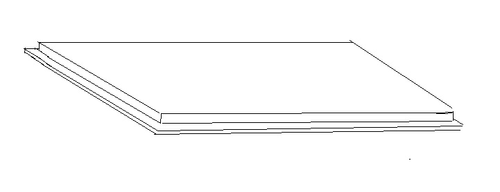

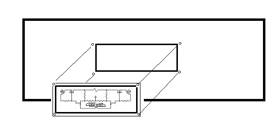

One last round of amateur graphic design...I did one with the FW logo that was suggested earlier by bcmbob. If I did decide to do the engraving I would do one of these two. However, it's possible I might not choose the F5 to be under the hood for good so maybe just printing it out on a plastic cling sheet would be best. Hell, I could just make sticky cling sheets for each Pass diy amp circuit. 😀
I like the first watt, you could even do Passdiy
You could do a bunch for each amp circuit on dark Plexiglas (backside painted black and etched), and add a little back lighting. Then you can match the logo to your mood.😀 Some acorn nuts or other special hardware might look nice.:cloud9:
Do you mean something like that?
http://img.alibaba.com/photo/514636510/acrylic_LED_signboard_plexiglass_billboard_for_bar.jpg
Could be amazing, cut out an square on the front metal panel, then engrave your plexi sheet with a CNC or whatever and then screw it from the inside so you can make your plexi piece a bit larger than the cutted out square so the edges will look fine.

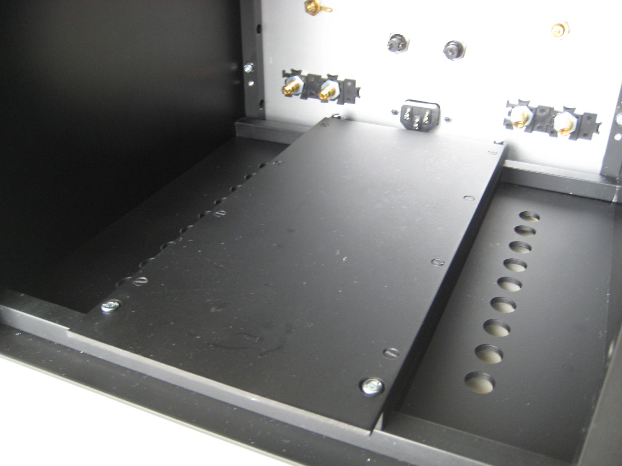

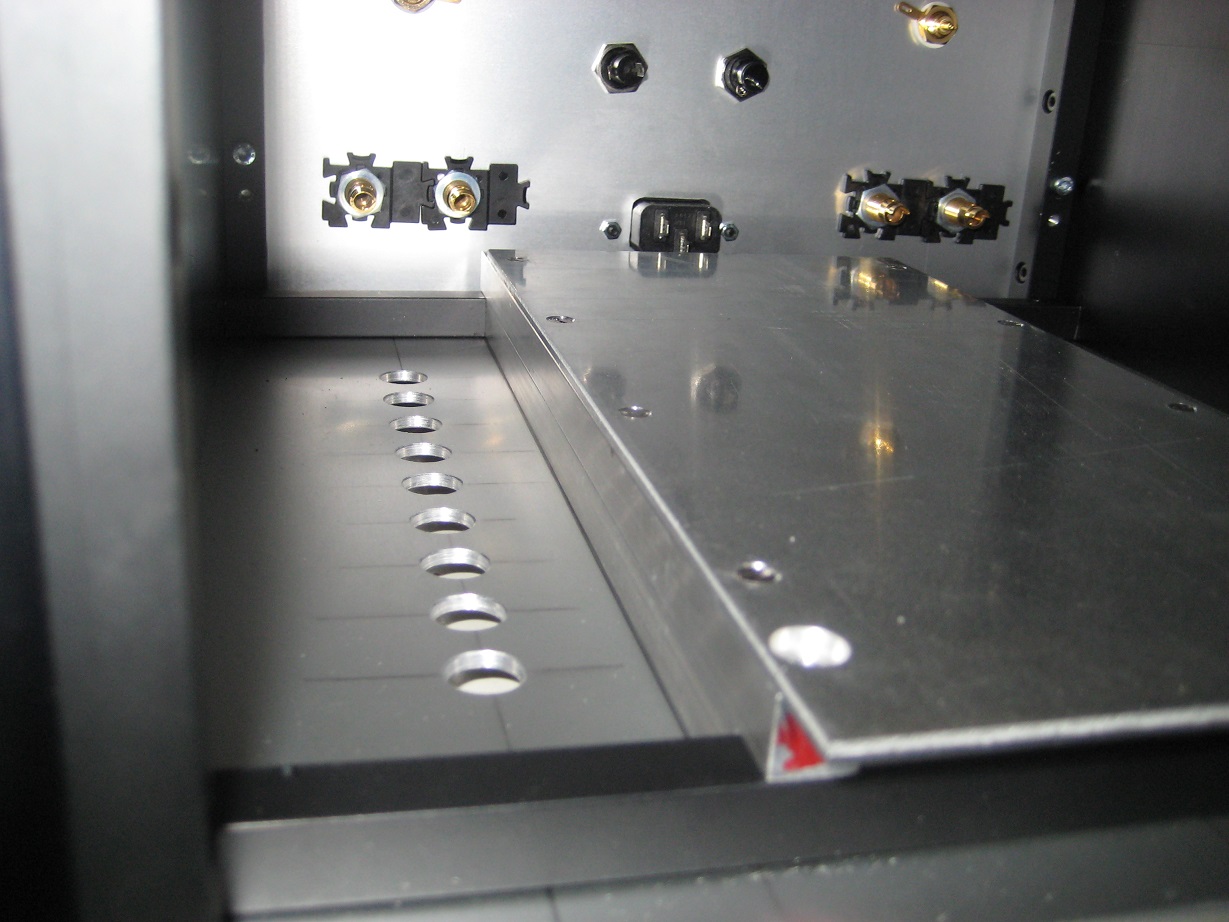

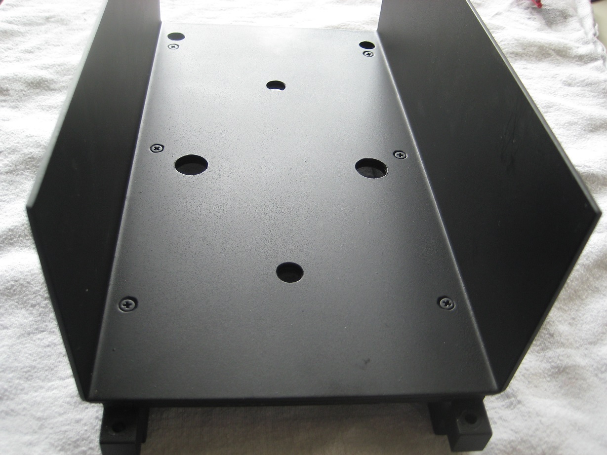

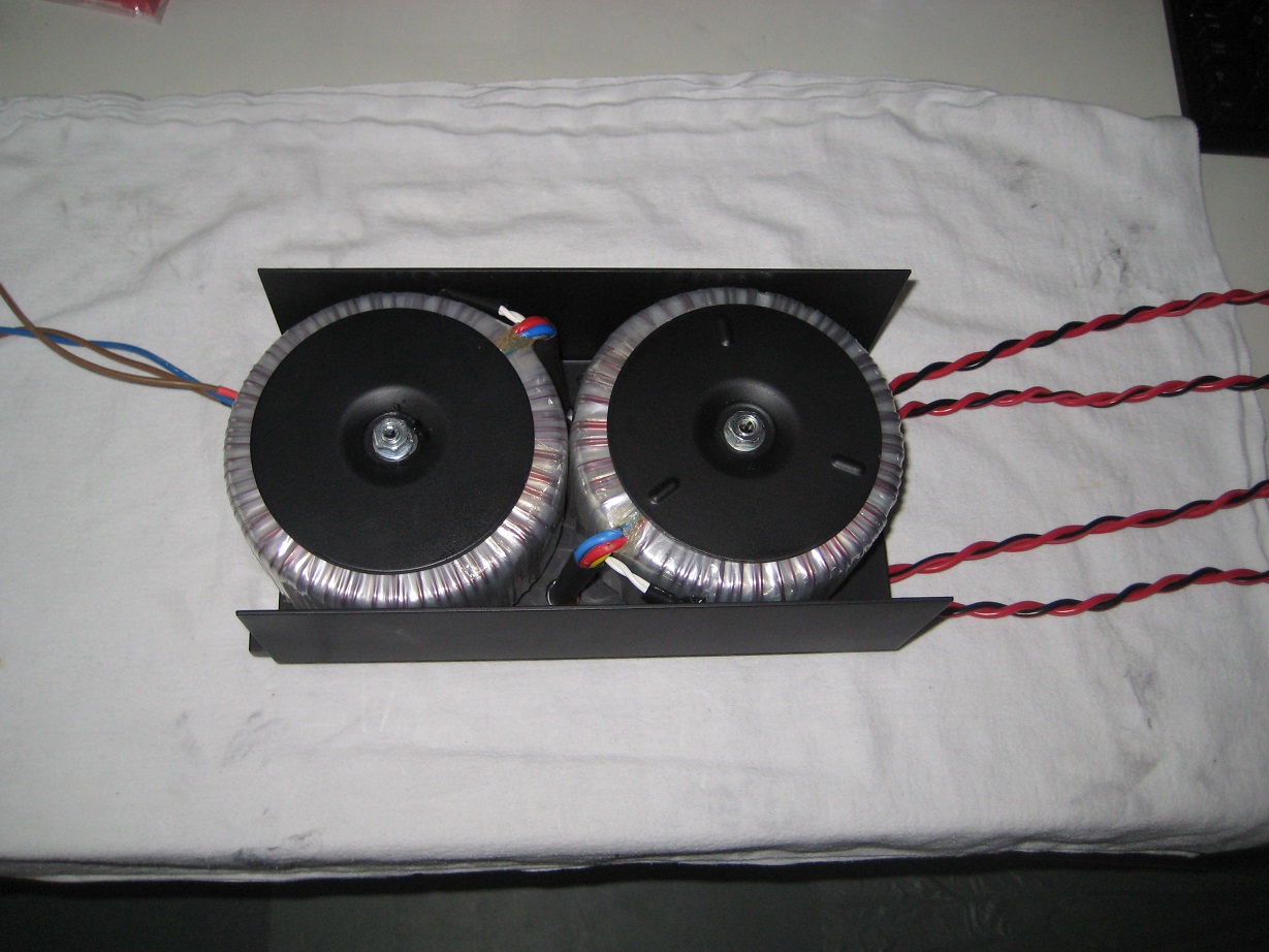

But as you can see on the pictures I have made a shielding sub-chassis for the trafos. It is not, as the rest of the case of aluminum, but made of steel plate 2mm thick.
So the input section doesn't see the trafos.
The sub chassis with the trafos and rectifier diodes can be removed separately from the case and also prevents bending the bottom plate from the weight of the trafos.
Walter

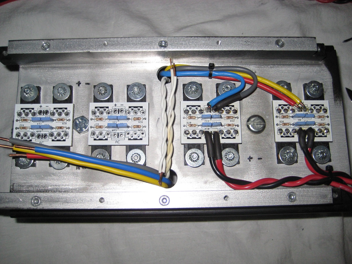

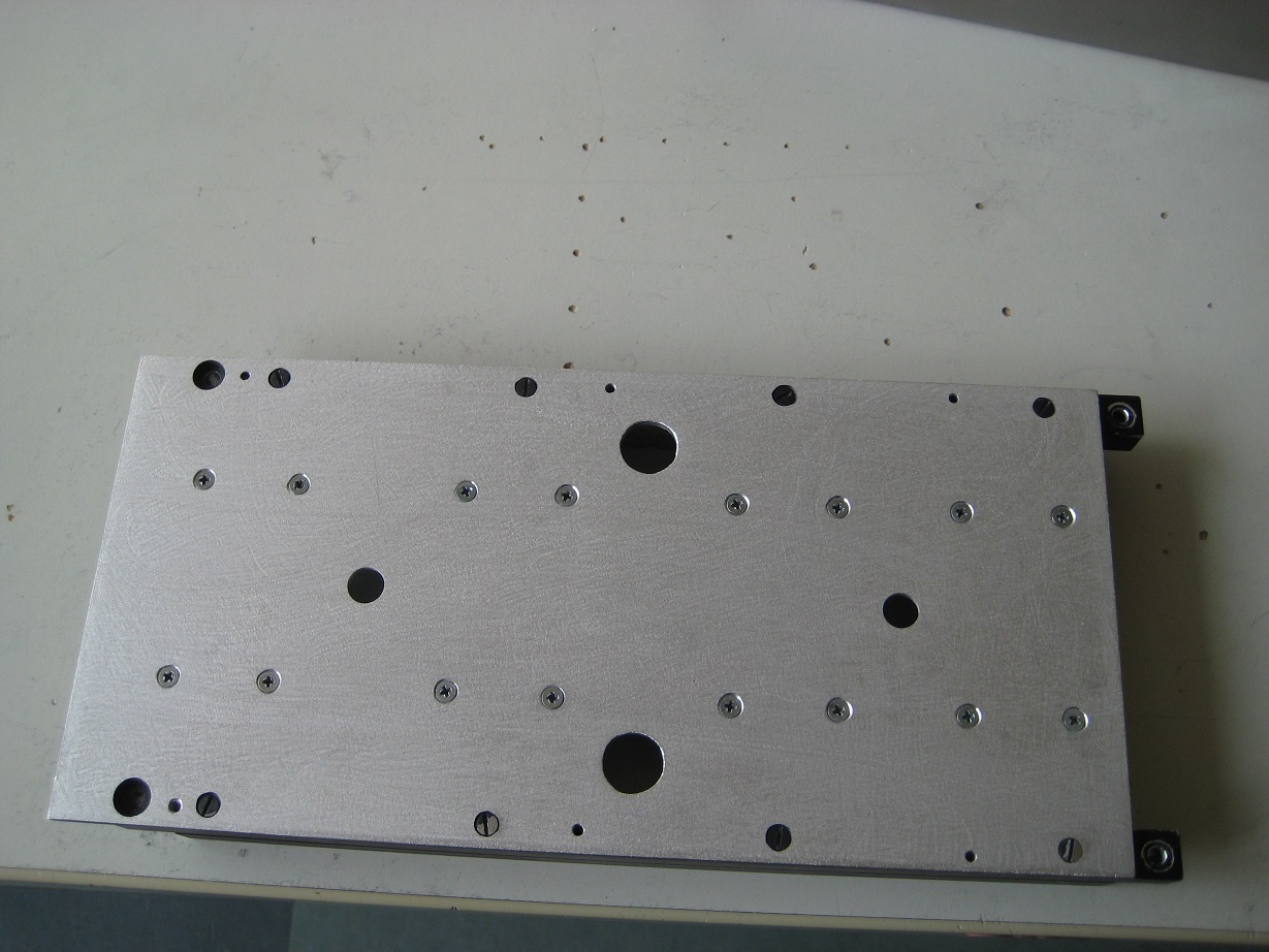

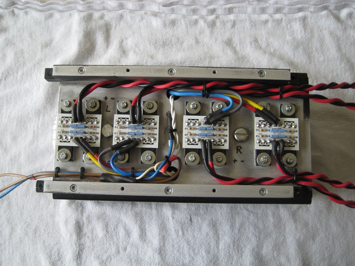

Walter, have you isolated the sub chassis from the chassis bottom plate with rubber feet? I have looked hard but don't see the rectifiers anywhere. I see your logic in keeping output wires and wires from the PSU to the board as short as possible. What AWG wire did you use? Any chance you can post an additional picture showing the rectifiers? Thanks.
Hi nashbap,
Here are more pictures during building process... it will give you an impression how it evolved.

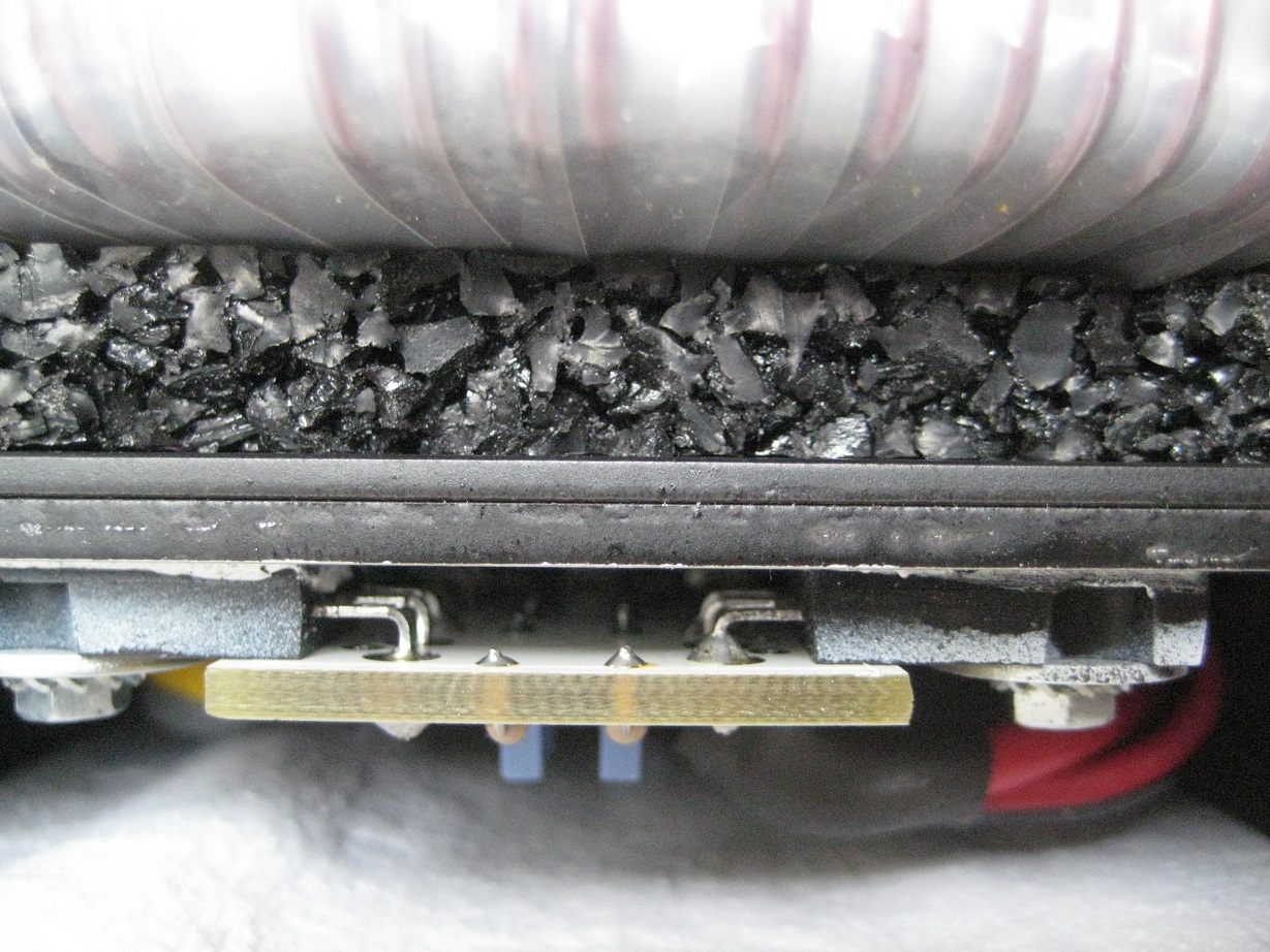

First I wanted it, to just hold the transformers, and hide the'' noisy' rectifiers.
Later on there was some discussion on DIYaudio if the diodes wouldn't become too hot. So the U-shape metal would bring some extra coolness and also shielding for the transformers.
The rectifiers are not getting hot, by the way... the output MOSFET's are the ones, producing all the heat 😀😱
It would have been nicer to also isolate the whole sub-chassis with rubber feet, but I didn't do that.
Walter

So it looks like the rectifiers are in a tray under the two transformers. Right?

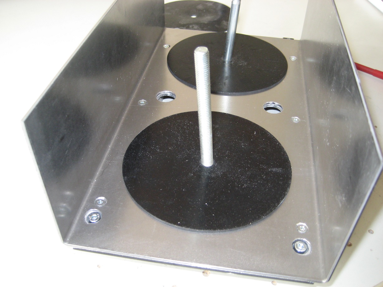

Flexibly mounted transformer will vibrate.
How much vibration I don't know.
Solid core copper lead outs will suffer fatigue, if flexed.
How long till they crack, I don't know.
You are building in a design flaw that WILL AFFECT reliability.
Change the leadouts to flexible !!!!!!

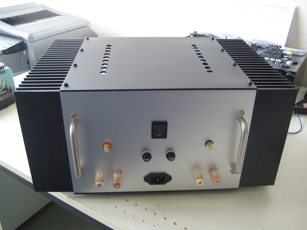

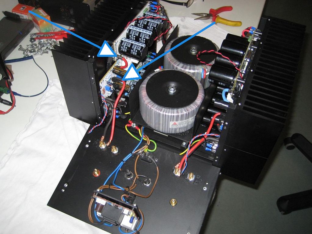

Are the points (blue/white arrows) in this picture soldered with heat shrink, or posts with removable coupling? They are very smooth/uniform and don't look like they are soldered. Looking for a tip for one of my builds. 😉
WalterW.
They are heat shrink tube, they hide the melted, pulled back isolation when you are soldering thick wires 😀 I like to work with shrink tube, gives a nice professional look.
I thought soldering will be the best, where high peak currents could be expected...
Walter
