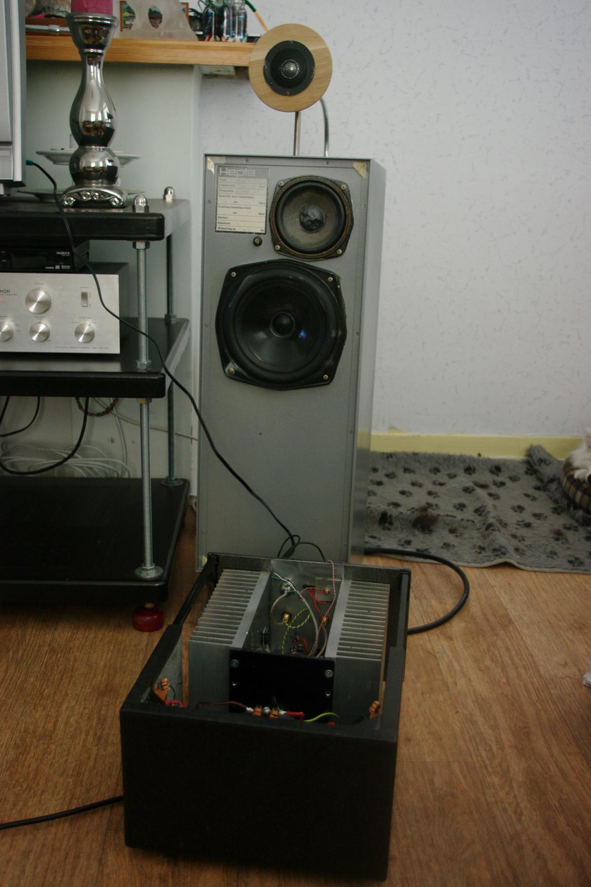

So it looks like the rectifiers are in a tray under the two transformers. Right?
What was your reasoning behind using 25V secondary output transformers and not higher, maybe around 34V?
Where did you buy the Toshiba Mosfets and the Jfets from? I read a post from Tea-Bag mentioning "The FQP variants (FQP19N20C and FQP12P20) are still available via distribution" Did you consider them?
That's a tremendous amount of fantastic machine work you have done!
Thanks nashbap, no machine work just a little Bosch hand drill 😀
Yes, the rectifiers are under the transformers.
The 25 volts give about 32 Volts DC rails which is enough for me, around 100 Watts max. in my 4 Ohm speakers. With my 5 Amp bias around 50 Watts in class A.
No I didn't consider those MOSFETs, I bought the Toshiba MOSFET's rather cheap from NicMac, perfectly matched.
EUVL did also recommend those Toshibas, and I highly respects his work and opinion. Even Pa mentioned the 2SK1530's and 2SJ201's in his F5Turbo article.
JFETs are from Spencer...

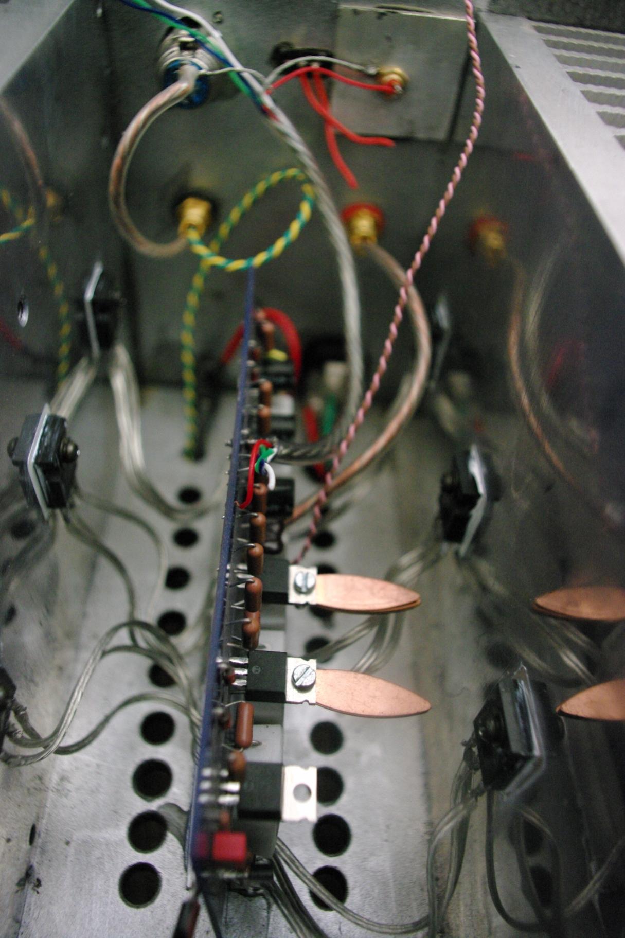

They are heat shrink tube, they hide the melted, pulled back isolation when you are soldering thick wires 😀 I like to work with shrink tube, gives a nice professional look.
I thought soldering will be the best, where high peak currents could be expected...

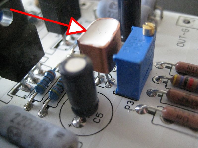

a metal condom??? yeah whell, what the heart is full of right.
but i see copper and on the left side corner i see a cut in the material, that is what got me thinking of a heatsink.
So, it's a DIY heatsink for a TO92.
Check my pictures on the Pumpy thread for serial manufacture ones (also copper)
Hahaa, it's a DIY heatsink for two TO92's😀
The 2sj74 and the 2sk170 are thermally coupled that way... a bit... best I could do...😉
nice. i don't know when or where, but i remember seeing aluminum blocks for thermal coupling of 2 TO92's. face to face, back to back and face to back, they had them all.
a DIY heatsink for two TO92's)
My mistake, then it's a twin sleeping bag (and a used one on top)
