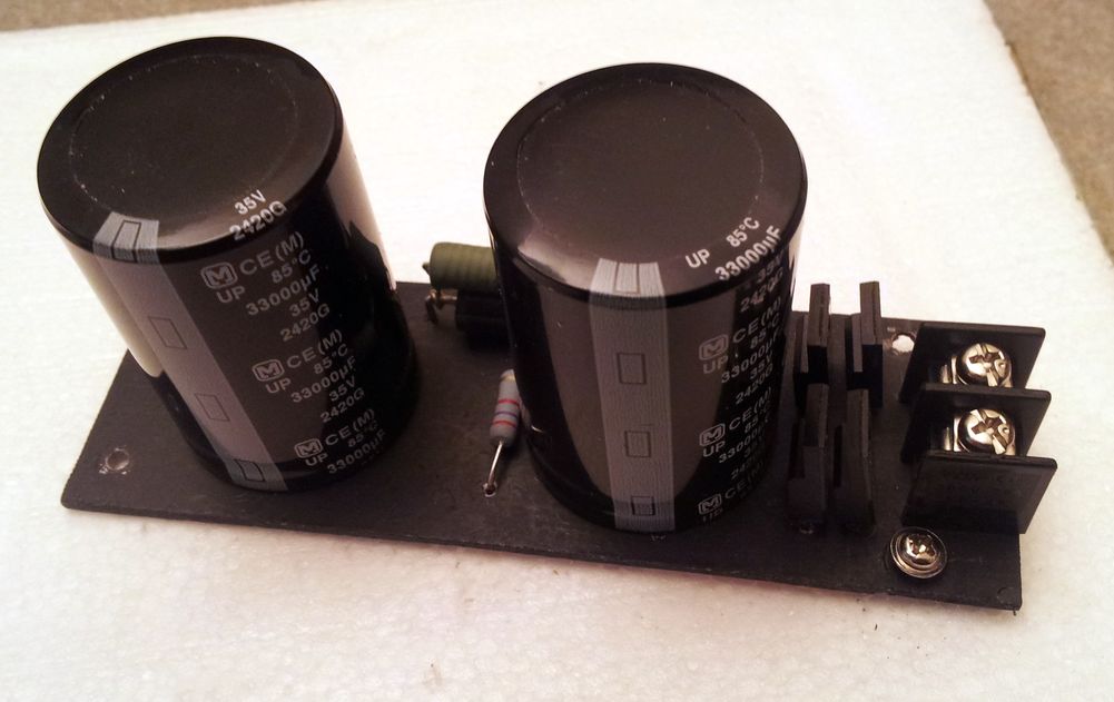

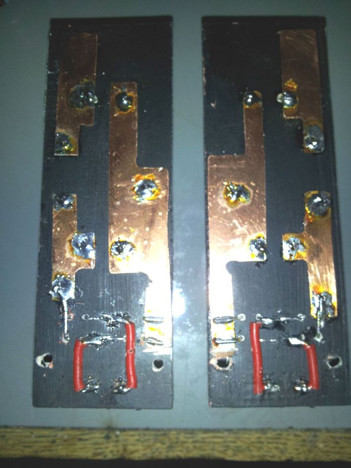

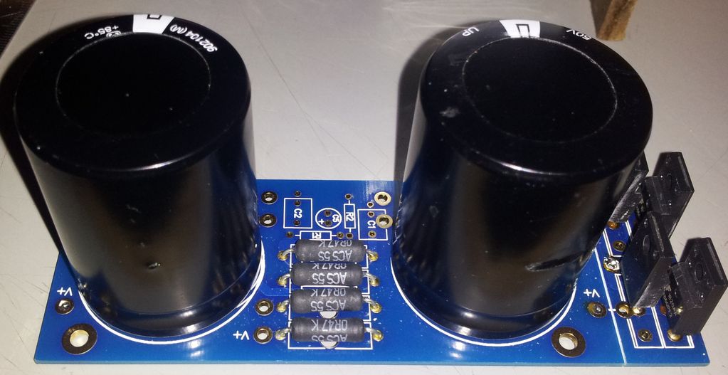

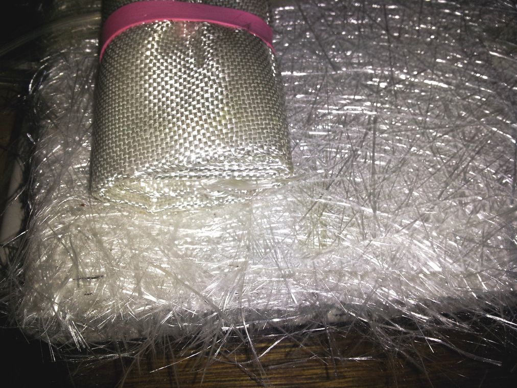

If you'r getting antsy, and you have the materials. take a shot at DIYing your PS PCBs. I used some auto body repair leftovers to make fiberglass boards and just sprayed them with flat black paint. Could have used perfboard but didn't like the appearance. I covered the cloth/resin/bondo sandwitch with Saranwrap and clamped it between two pieces of plywood then trimmed the excess. I'm making another set (copy of Peter Danilels board) for a Burning Amp project this weekend. Beats waiting fro the mailman.:)
