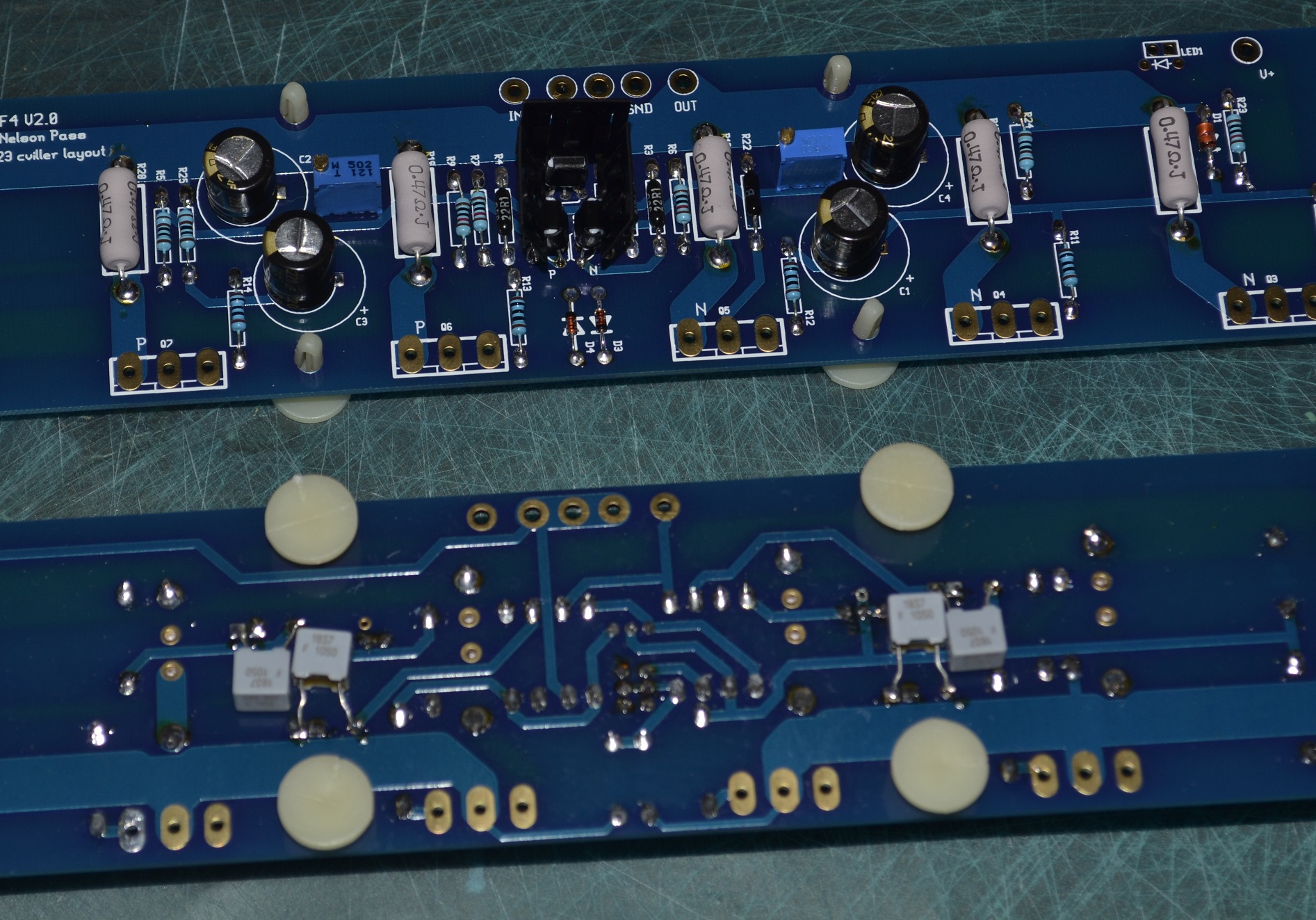

I see that you have used 470uF capacitors for C1 and C2, where 10uF was specified in NP's F5T V3 schematic. Any reason you used that value? Is this dependant on the PSU configuration?
That capacitor is just a decoupling cap, and not critical. I used a 'high end' type capacitor, Nichicon Muse.
Somebody at the forum told me that it's nicer to put a quality cap over the big computer grade electrolytic capacitors....
Walter
Walter
OK, so basically even a 220uF would work in that spot? I thus assume that NP specified 10uF just because 'he had them in stock'.
The local decoupling has a quite different duty from the smoothing capacitors.
High quality decoupling that is specifically selected for that duty is very likely to achieve best performance from the amplifier. That is best measured performance and best sounding performance.
I like the muse caps AndrewT is very correct in his statement. If the small value muse is as close to the circuit as can be the inductance of the wire or trace will be before it and can be a small help rather than a problem A clc rather than c c l then load. Granted a small inductance but still best placed before the last cap.
My problem is not with the quality of the decoupling caps to use. There my preference is usually for the Panasonic FC or FM caps because of their better temperature rating than the Muse caps.
However, how does one determine the best possible value for the decoupling cap? Using an oscilloscope on the rails to see which ones filter left over noise after the smoothing and rectification the best? Listening tests, or both? In other words, how does a designer like NP decide which value to use on a specific circuit, as I have seen values from 10uF to 470uF used for this purpose, and sometimes it is bypassed by another 100nF cap also, sometimes not.
The size of the caps will determine the frequency range at witch the caps have the lowest impedance.
The circuit topology determines the sensitivity of the circuit for power supply impedance as a function of frequency. Hence different circuits use different cap values.
Having looked at various NP designs I see the recurring use of standard component values like 10u and 220u caps. Wayne tends to bypass 220u caps in his designs with smaller caps in the signal and power path. NP tends to do that less.
Personally I favour ballanced designs and they have minimal ground currents as well as easy decoupling from rail to rail for signal current.
Yes Andrew, I understand what you are saying. BYPASSING is the wrong term technically to use. What I refer to is putting a smaller value cap in parallel to the the electrolytic, where each handles a different frequency band if one can put it that way. I was using layman's terminology, sorry for the confusion it caused.
I actually did use "Bypass Caps" on my 220uF decoupling caps.
I used 220uF Panny FM's and each one got a Vishay 1837 .01uf.
I don't know what difference it makes but I figured it couldn't hurt.

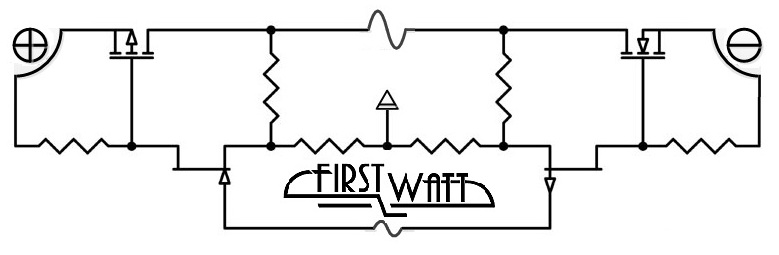

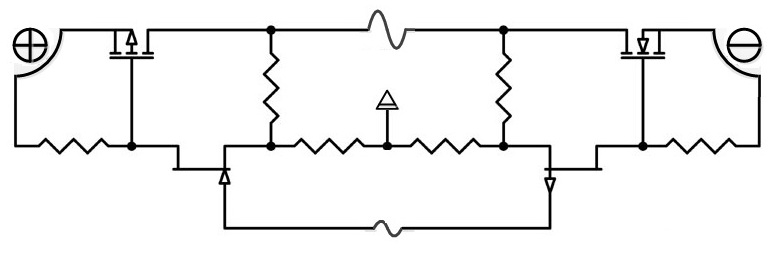

One last round of amateur graphic design...I did one with the FW logo that was suggested earlier by bcmbob. If I did decide to do the engraving I would do one of these two. However, it's possible I might not choose the F5 to be under the hood for good so maybe just printing it out on a plastic cling sheet would be best. Hell, I could just make sticky cling sheets for each Pass diy amp circuit. 😀
