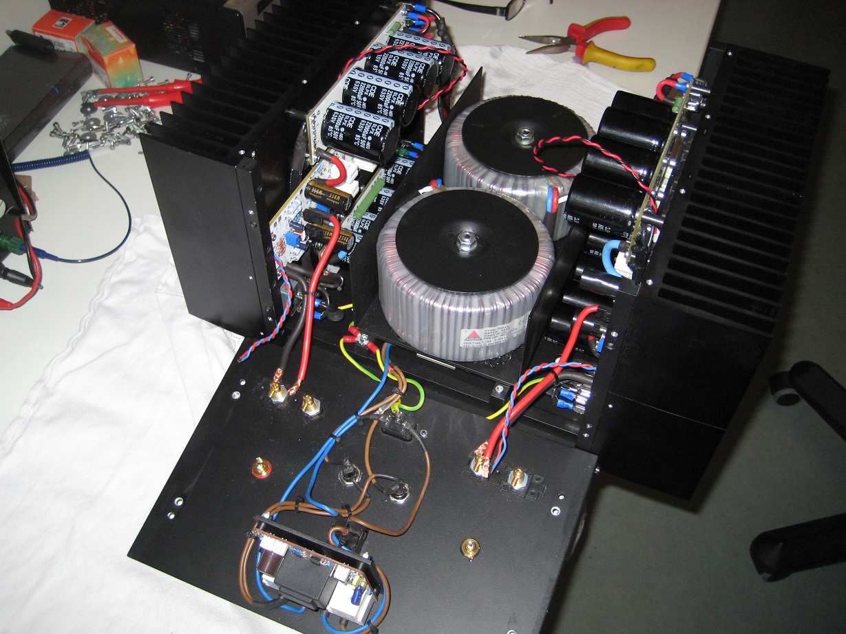

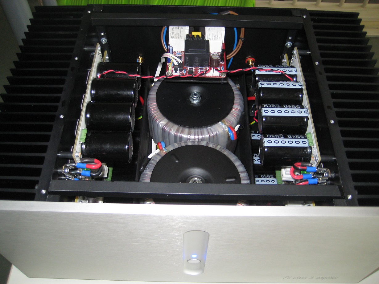

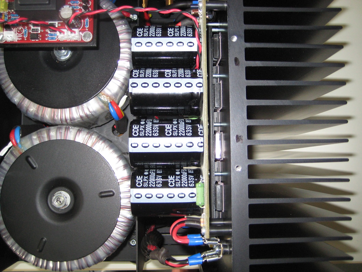

Finished F5T v3
Finally finished the v3.

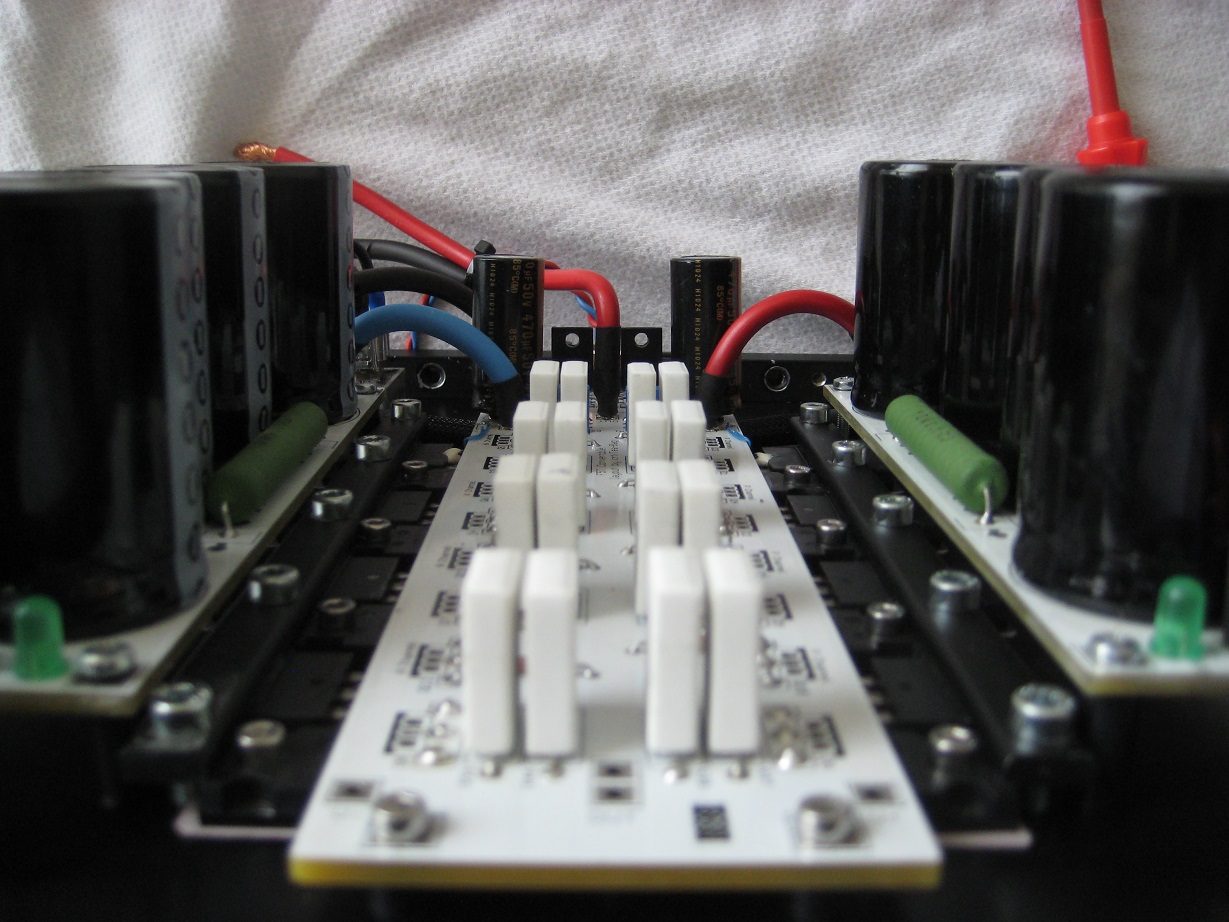

It's exactly build according the Nelson Pass circuit except for the (better?) Toshiba MOSFETs in the output stage.
In the version 2, I biased the MOSFETs at 1,25 A @ 32V, which resulted in very hot MOSFETs. Around 70 degrees Celsius.

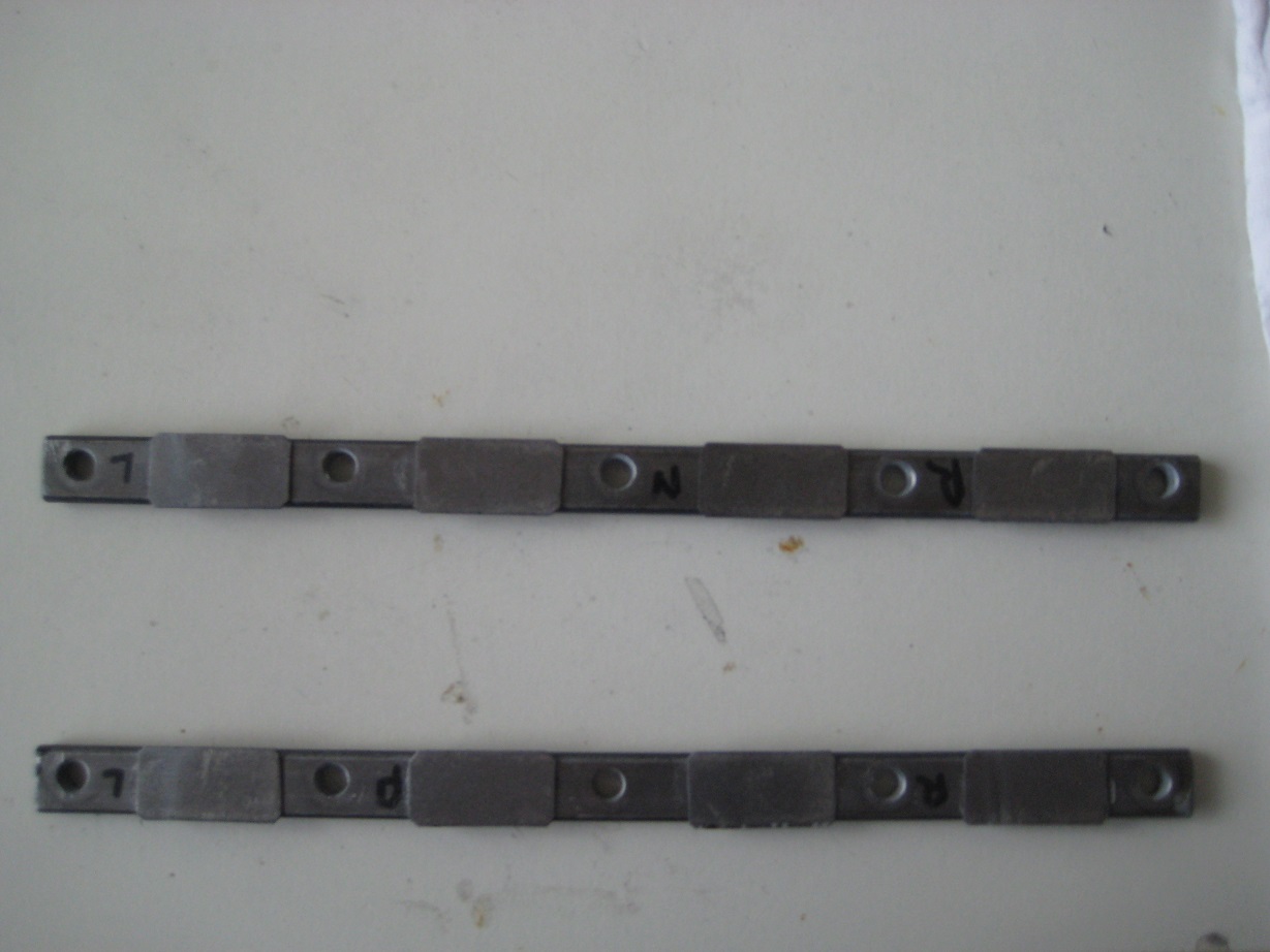

Now I've doubled the output devices, so half the current for each device, and used Kerafol instead of mica and goop. Also clamped the output MOSFET's and yes, now I have only 5 a 6 Celsius difference between the heatsinks and the output devices.
Kerafol 86/82 under big pressure rocks !
Heatsinks max out around 58 C with 0,225A per rail bias and the MOSFETs are around 62 C.
Can't use 2.5 A bias per rail since my T ambient is around 25C this time of year 😛

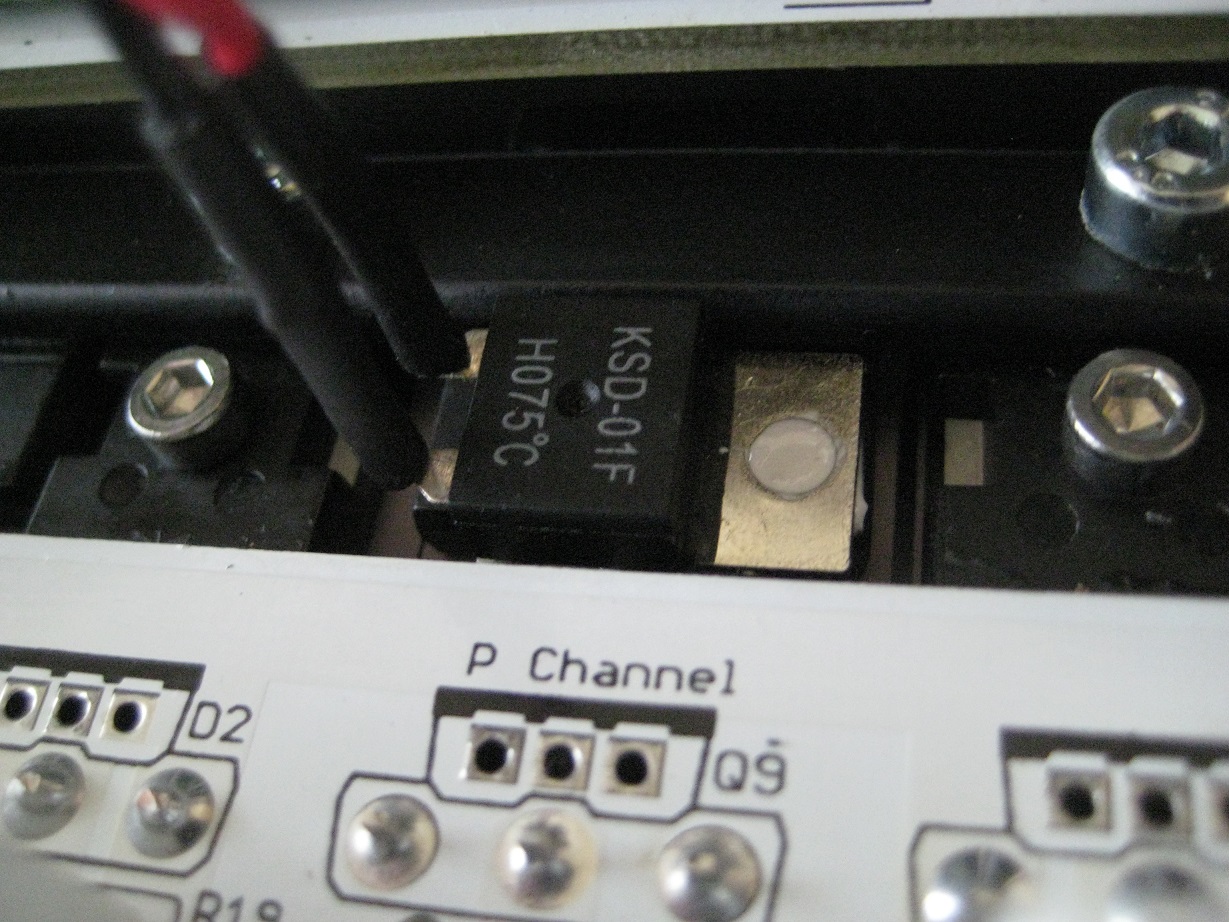

I also implemented a thermal protection by glueing 75C switches on the Toshibas.
Didn't need too implement C3 and C4 for stability.
The amp is dead silent, and it sounds so great !
During the rebuild to a version 3, I constantly listened to my standard F5 ( which isn't bad!) but this v3 has definitely more body, bigger soundstage, more bass and sounds a bit more detailed and relaxed, yes.
Attached are my last pictures for this project.
Now it's time to build a set of high end speakers... suggestions are welcome...
Although I already ordered the ACA PCB's and the beautiful red chassis for a little desktop computer class A Amp ( or maybe for my son) , I must say the Aleph J pre-order PCB's in the store are tempting 😀
Would like to hear how a single ended class A will sound 🙂

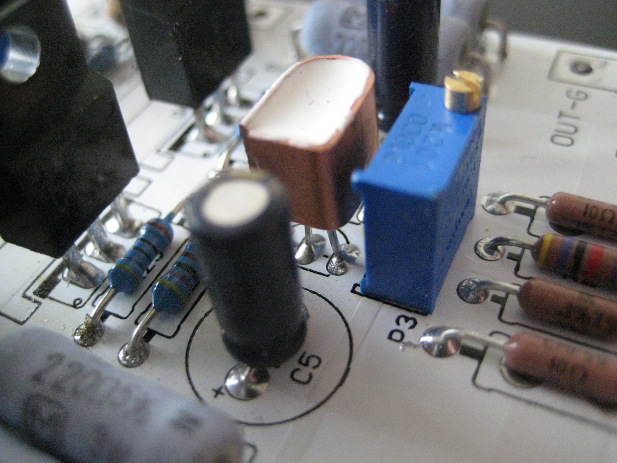

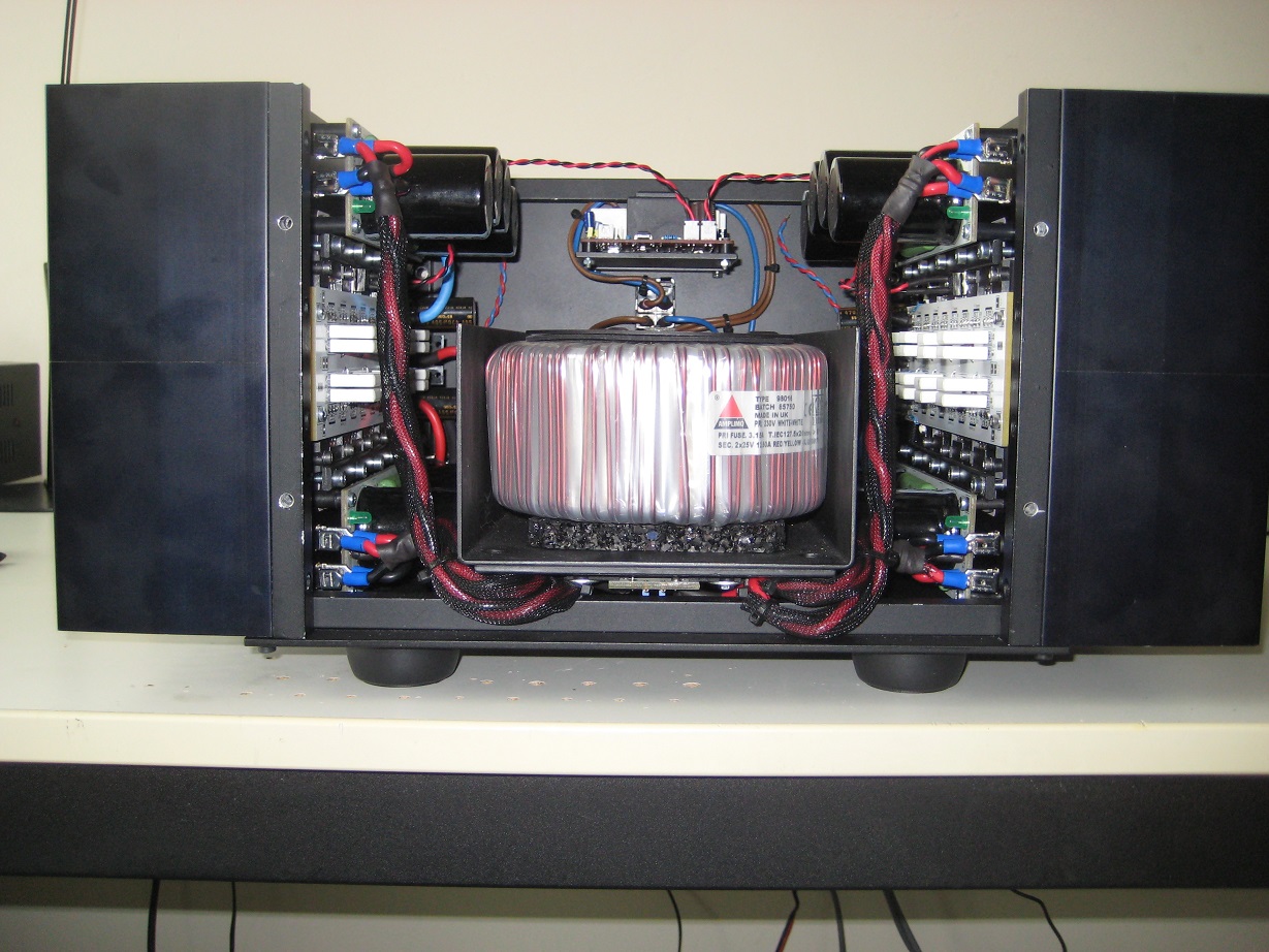

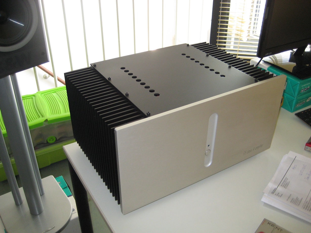

Very nice where the chassis come from ?
I build it myself, see picture and earlier posts. The nice frontpanel is from Hifi2000.it
