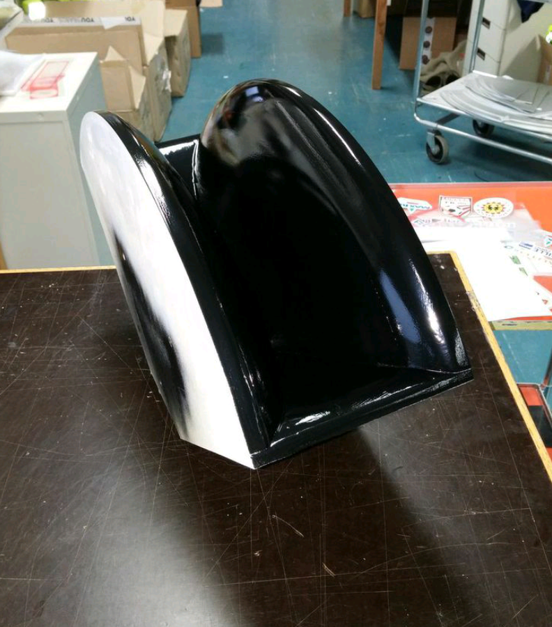

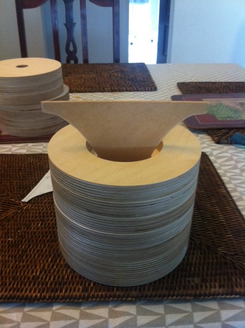

Hi 🙂
I have not had much time to hifi lately, finished one pair of tube amplifier in June 🙂
I tested som 3d milling yesterday, made some 480fl horns for a 2 way speaker project, not to much sanding needed
I am gonna finish the 290 horn project after this 🙂

Hi 🙂
Sorry I am not going to publish any files, they wouldn't nesesery be very useful either.
Every operator has to finde their solution, this is generated 3D files for enroute 5.1 pro done my way.

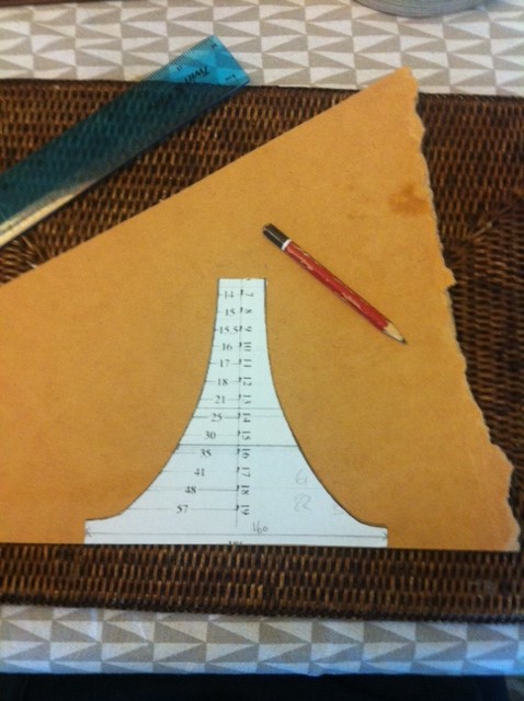

Well, not sure i understand your answer as not familiar with 3D CAD yet but I would like a real model to practice, not build a factory, and the IP is from Mr Arai btw. I believe the CAD file is independant from the routing for the CNC or am I mistaken ?
May someone help with a Yuichi model, 480 or 290 ?

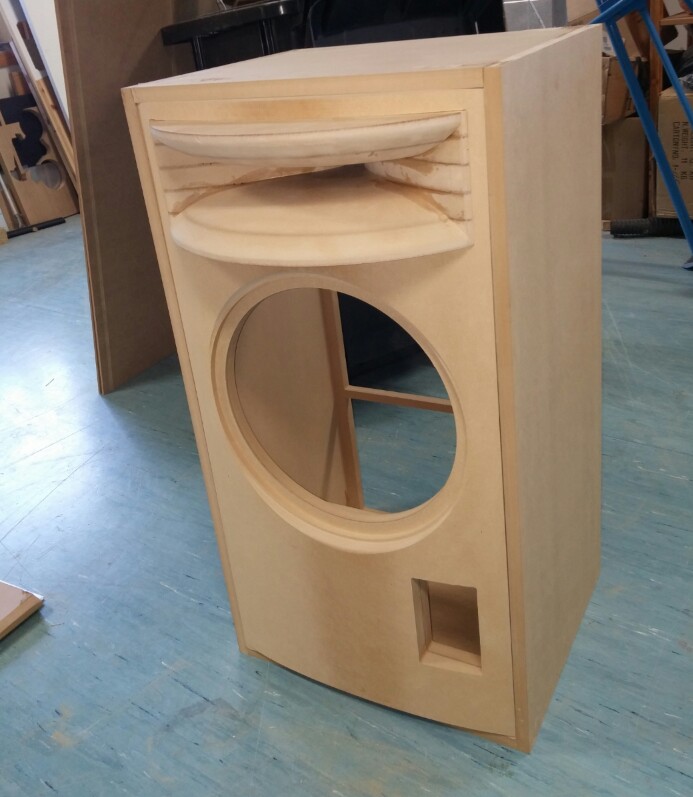

I want to build Yuichi 290 just to try to hear the difference between this and Volti FC260 that I have. I have BMS 4592nd-mid 16ohm compression drivers. I cross around 380hz. I think with the Yuichi 290 and BMS this wont be a big problem.
One advantage will be pysically lowering the height of midrange and tweeters for me. I have klipschorns. When I replaced klipsch original squawker with the voltihorn, the new voltihorn was placed inside the klipschorn top hats. I will bring down the midrange and tweeters around 10cm's when I take the tophats off and place Yuichi directly on top of bassbins. I also wonder if Yuichi has a wider sweet spot.
Anyone had an experience with both? Or any experience with BMS and Yuichi. I would also be very happy if anyone could exchange cnc plans or a precise cad cutlist with me.

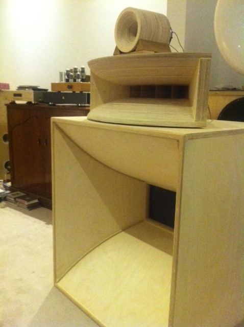

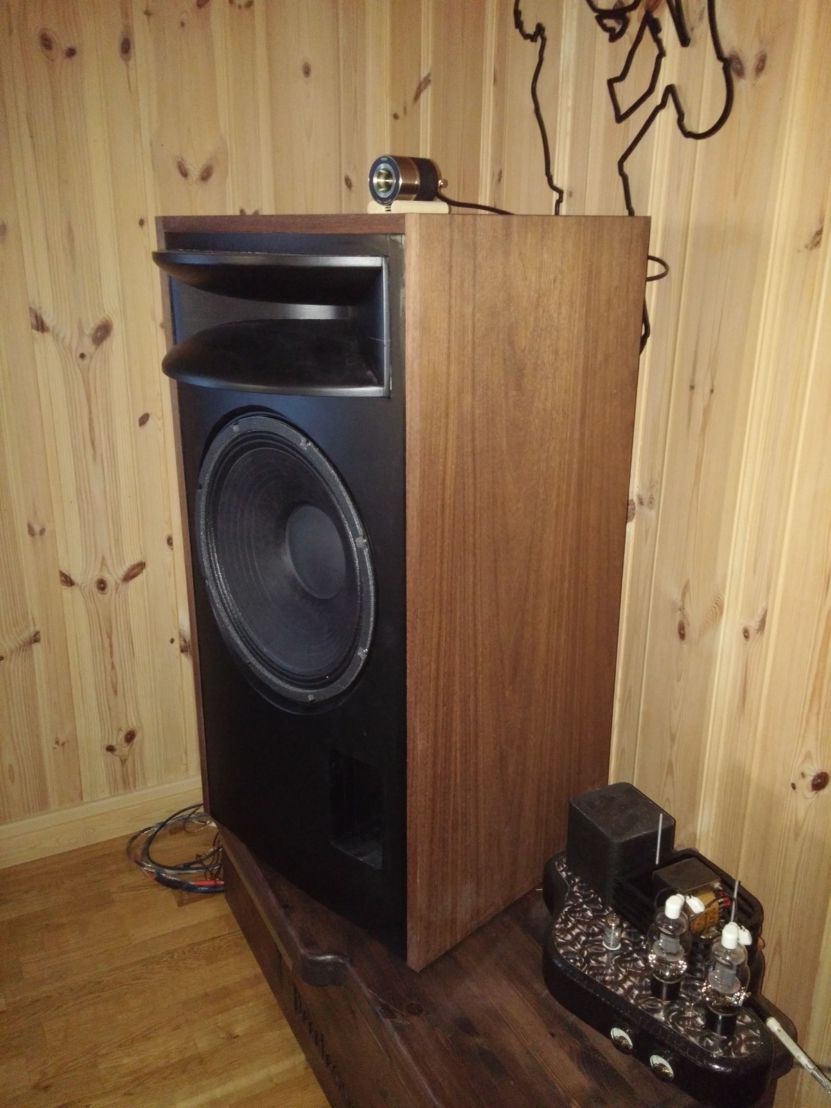

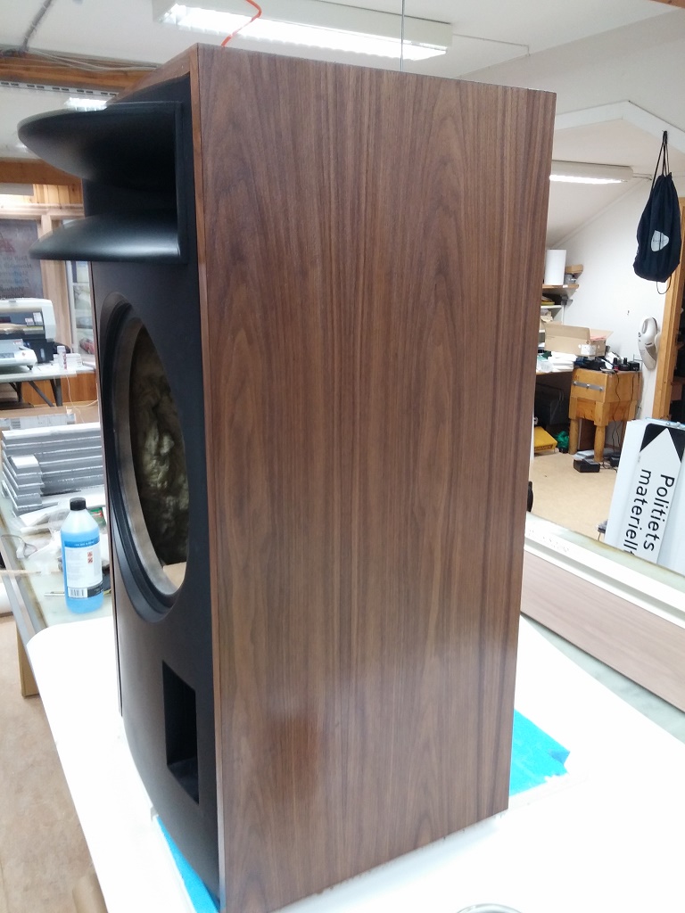

Very smart looking...congrats.Finaly some testing, the Wood are oiled twice...

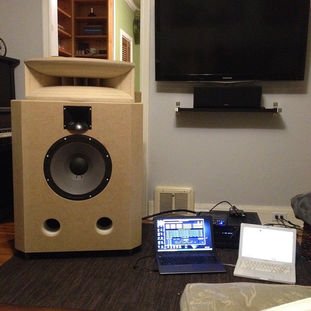

Lovely looking three-way...I like how you've integrated the tweeter in the bass cab. What drivers and xover are you using? Regards. Andrew.Just finished up my Yuichi 290a. Don't really have much to base it off of but so far it sounds great. Second one is half done and should be finished by the end of the weekend.

Please excuse my ignorance, but shouldn't the baby-cheeks tweeter be rotated to give a wider dispersion instead of the existing vertical pattern?Just finished up my Yuichi 290a. Don't really have much to base it off of but so far it sounds great. Second one is half done and should be finished by the end of the weekend.
Can't really tell if that's a JBL 2404, but they supposedly have 100° x 100° dispersion.
http://www.jblpro.com/pub/obsolete/2404.pdf
The horizontal and vertical off-axis plots look fairly similar.
