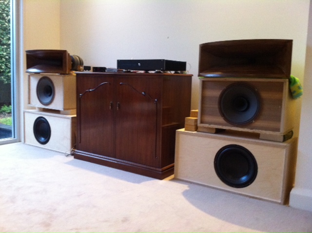

what drivers are you using in the horns and have you got any measurements from them?
or, what is your full set up with these?
i was considering radian 850pb with the 1.5" mouth with AE TD12M in something like this.

exactly that, i love that youtube channel and that's the exact design i'm thinking of trying to clone. tbh, there's a dozen systems on there i'd happy try and clone.
Your suggested combo is first class.
If I built a 'simple' two-way, I'd use the AE driver. My set up is different, as I'm exploring a 3 or 4 way.
I have Altec 288 1.4 inch drivers....MASSIVE, and very very good. These are oustanding vinage drivers, operating well from 500Hz.
I've enjuoyed a few horns...Faital Pro (Cornscala) and Stereolabs stone horns from Germany. Both good.
Also, I've recently enjoyed borrowing some massive Altec 805 multi-cells, plus the 'smaller' br-radial Altec 511.
I've enjoyed Faital Pro comp drivers, Selenium, small format Altecs, plus this current large format 288.
I've built doezens of horns for Tannoy, Klipsch, Lowther etc, including my radical own C-Horn design.

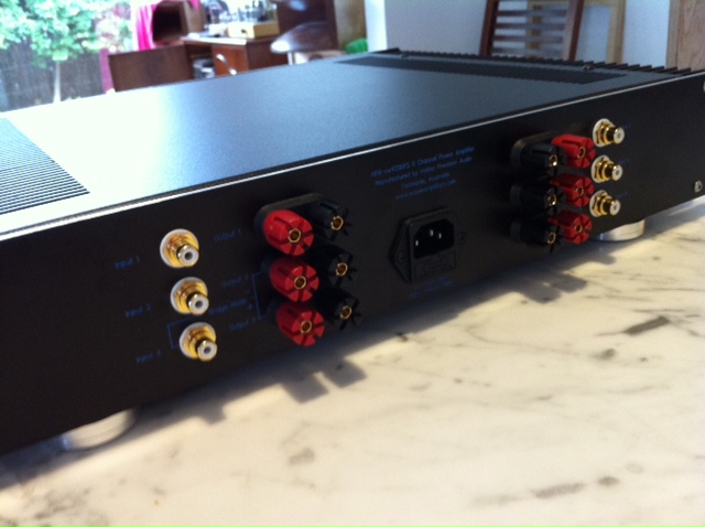

Tomorrow, I take delivery of a new sixh channel custom amp for my multi-way...so I'm excited about that.

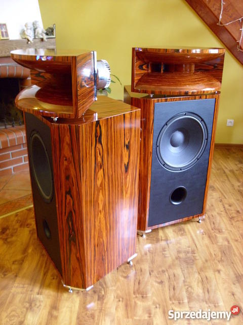

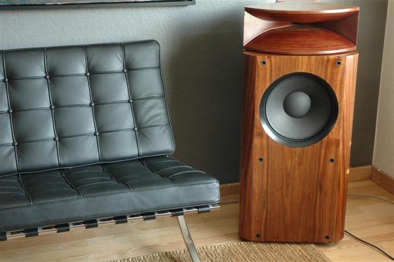

I like the following pics for inspiration...

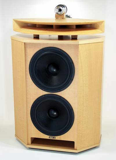

The drawing with the bloke standing in it reminds me of the bass cab used in the Visaton horn kit, Monitor 890.
MONITOR 890 MK III
The Yuichi is 63cm wide...so might be perfect for a similar bass unit like the Visaton.
MONITOR 890 MK III
Does anyone know which mid driver is used in that Visaton... the specs don't tell.
DR 45 N - 8 Ohm

Just took delivery of new six channel Holton Precision Audio ap...very very good...real powerful bass and evenness. Happy in the extreme. Using L-pads on horns...while Minidsp attenuates the bass and mid bass.
