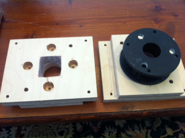

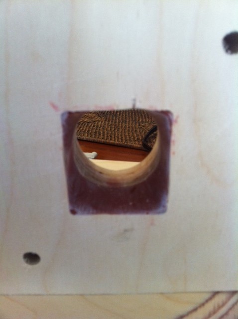

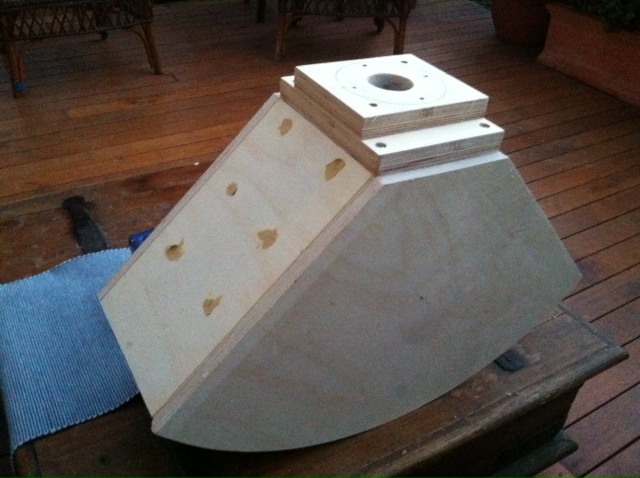

With one horn 'completed,' I worked on the adapters this weekend.
Added some putty, did some sanding etc. Coming together....

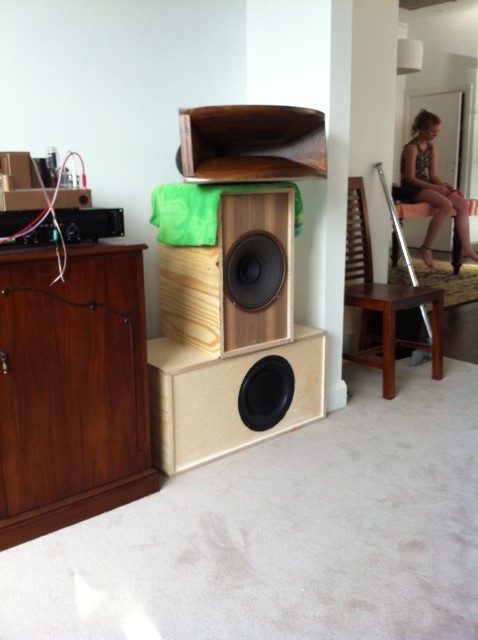

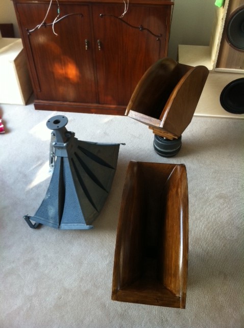

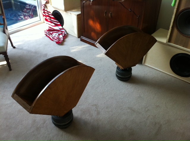

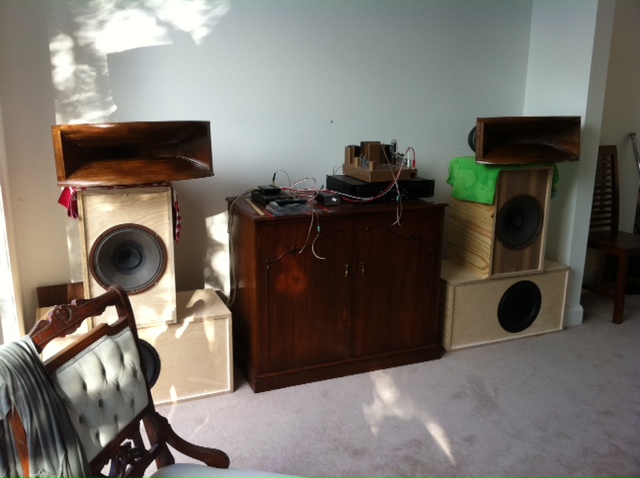

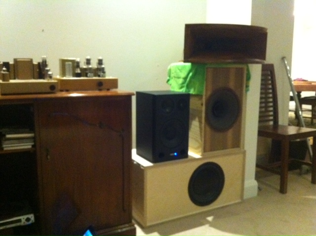

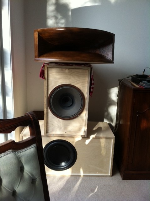

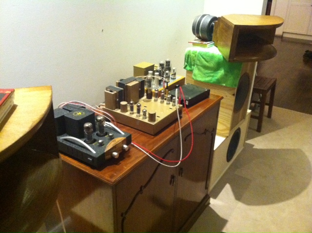

Well, finally got back on the tools this weekend to complete the second horn.
Have stained the horns in a Cabolts walnut, with gloss.
Quite a hard job sanding and preparing. If I do another pair, I'd stain prior to final assembly.
Still don't have my new amp, but initial presentation from the horns is OUTSTANDING...I'm very happy. Plenty of detail and superb sound stage. No metal ringing like Altec 511 horn.
I chickened out and did not fit the fins to the horn throat...reading that sound stage depth can be improved without fins....like TAD and Fostex horns.
New six channel amp to arrive soon.....can't wait.

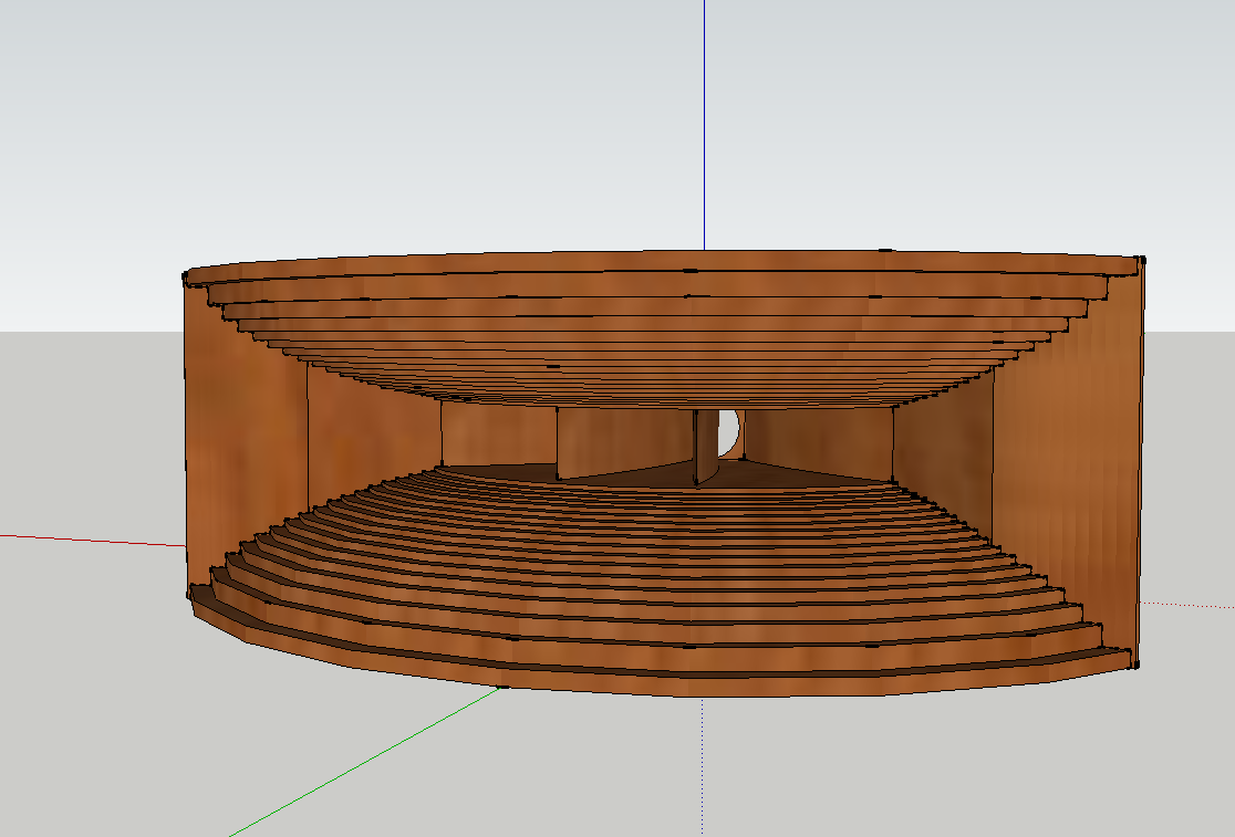

Maybe 45-50 hz.
Would be over the top though, and very difficult for room placement...for correct flair it would need to be very long.
Why not aim for mouth diameter around 43 inches (110cm). This would slightly larger than AG Trio mid bass.
Then, what materials to use...!? CNC'd layers of MDF rings?
One of my all time fave pics is the jeff Jackson 90cm horn in mahogany laminated pieces.
