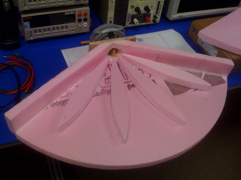

maybe if you use polystyrene foam
make a square plywood box, put foam inside, and start shaping 😀
Then don't use the pink foam. Jams any tool but a hot wire.
Don't stop halfway through, or that just makes a mess.
http://www.diyaudio.com/forums/multi-way/153831-styrofoam-smith-horn.html#post1958688
OTOH, if you had a jig to turn the wire or workpiece....
Only helpful suggestion to the OP is maybe cut the outside throats in half.
Because it's one less partition and one less odd shape to set up a jig for.
If you are cutting half partitions (flat on one side) make no diff...
See flat wall down center of outside half-throats.
Maybe smoother transition to flat wall at 2nd radius?

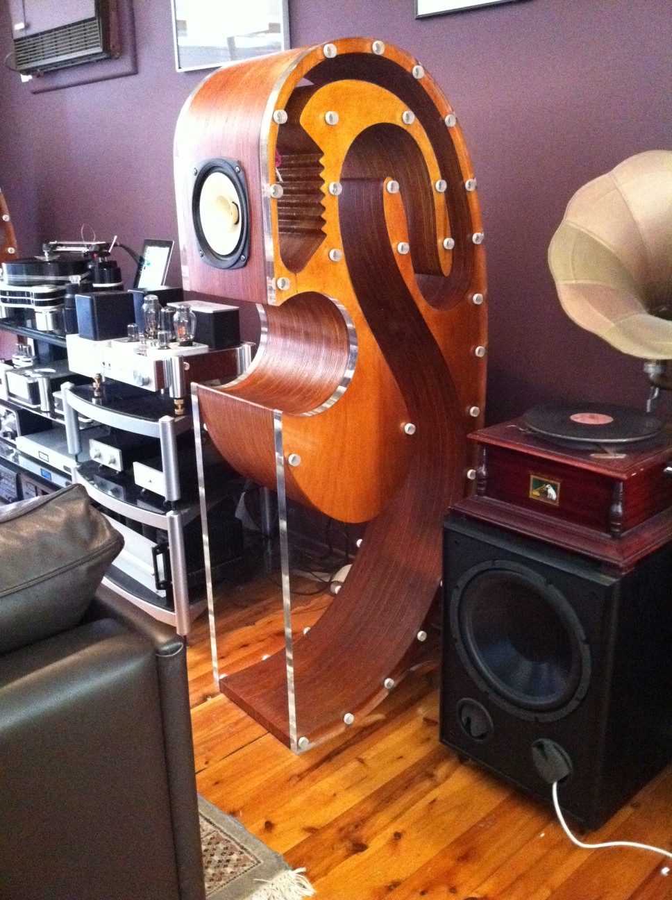

Most of my projects are over engineered. For the C-horn, it's a long 3 meter horn path...so reasonable cabinet height is required. The ply internals can be lighter than MDF. The acrylic sides are 25mm, and weigh 25ks each side (single piece).When you consider what the cone weighs, 100Kg might be overkill...
A heavier horn I built is for GOTO....
Have also built massive tapped horns and Bill Fitzmaurice subs...all fun stuff.
The Carfrae is another massive speaker I build.
a GOTO bass horn - Audio Voice Acoustics
Carfrae Little Big Horn from Creation Audio | Hi-Fi

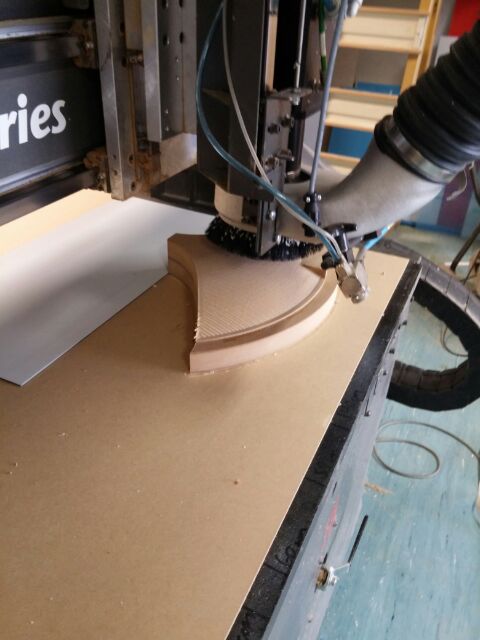

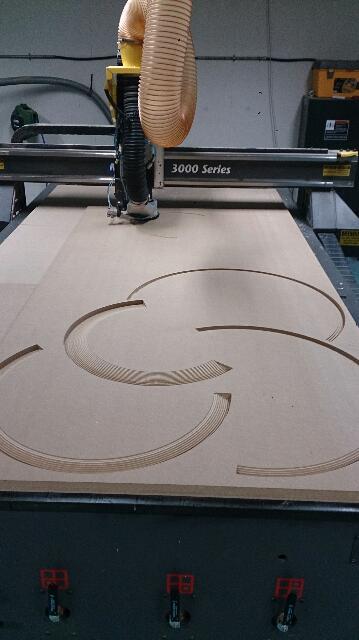

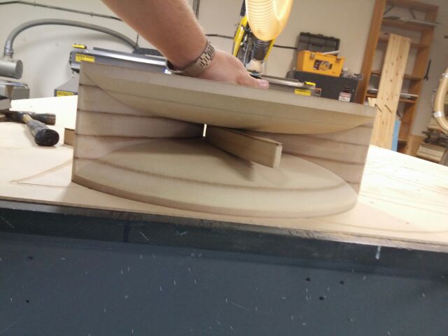

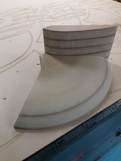

I did a test yesterday in 19mm MDF
I could have done a better resolution in my step down....
It's going to be a lot of sanding 🙂
Today I ordered a upgrade from Enroute 4plus to Enroute 5 Pro 🙂 when I learn how to use it I guess it's going to be less hand work...
That looks good.
Gee, my 'step downs' were 19mm each...!!!
You'll sand that down in 5 min...and no need for electric plane.
My CNC guys said they could create the step down profile to 1mm...which would be ideal.

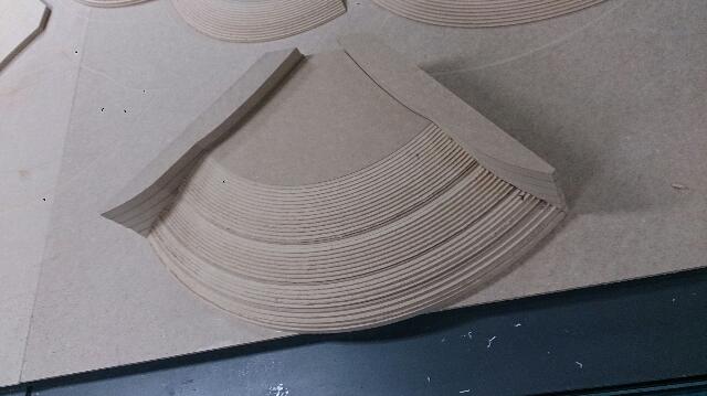

Hi 🙂
I have not had much time to hifi lately, finished one pair of tube amplifier in June 🙂
I tested som 3d milling yesterday, made some 480fl horns for a 2 way speaker project, not to much sanding needed
I am gonna finish the 290 horn project after this 🙂
