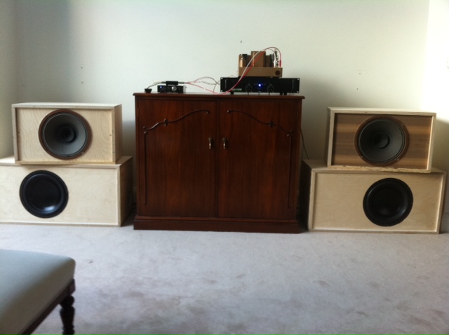

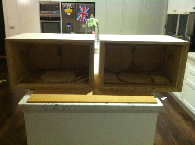

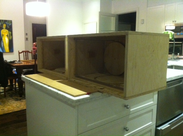

Mid bass cabs now built to final baffle stage. Dimensions approx. 63cm wide x 35cm tall x 40cm deep.
Birch ply used on the bulk of the panels, with odd shapes of ply added inside for bulk and reduction of standing waves. Extra bracing still to be added.
Heavy buggers.

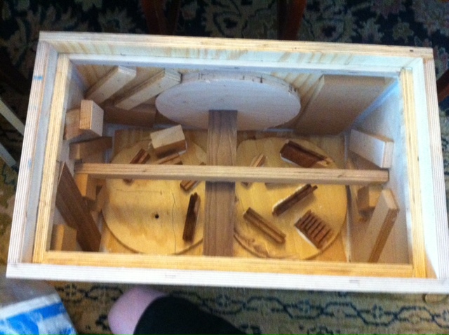

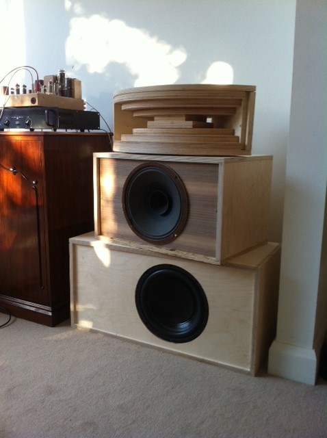

Today I finished the mid bass and tested the first driver, Magnavox 12-inch (full range). This sounded absolutely fantastic. The cabs had added pieces of wood pieces glued in, plus 3 walls lined with wool fibre.
Alnico magnet, high sensitivity.
MiniDSP set with 150Hz xover for the Lab12's....and 150Hz for Mag's.
The Leak valve amp sounded best on the bass module (vs the "pro" solid state 100-watt amp). For fun, using mini class D small amp for the Magnavox. This system would kill most modern systems...and I haven't even sorted out the big Yuichi/Altecs yet. Can't wait.

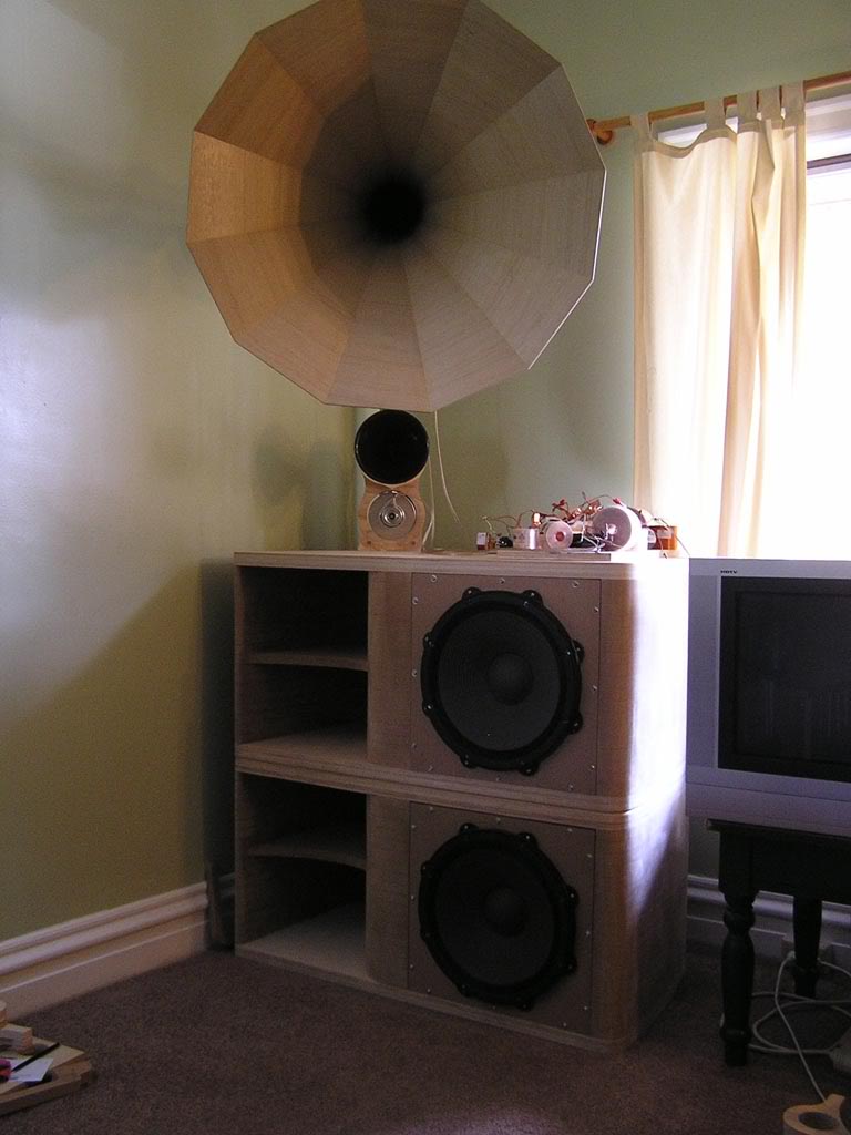

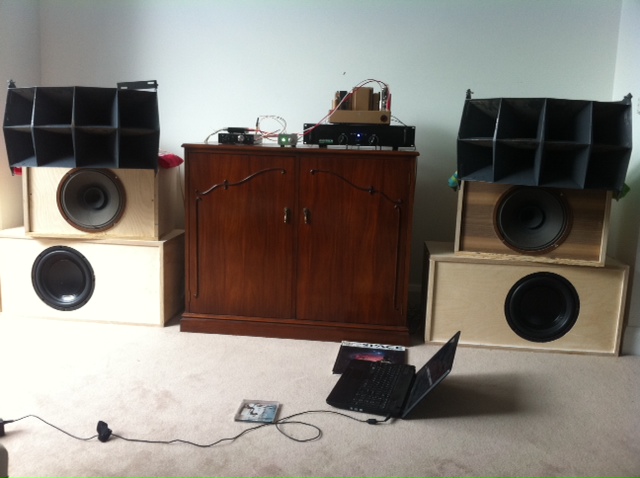

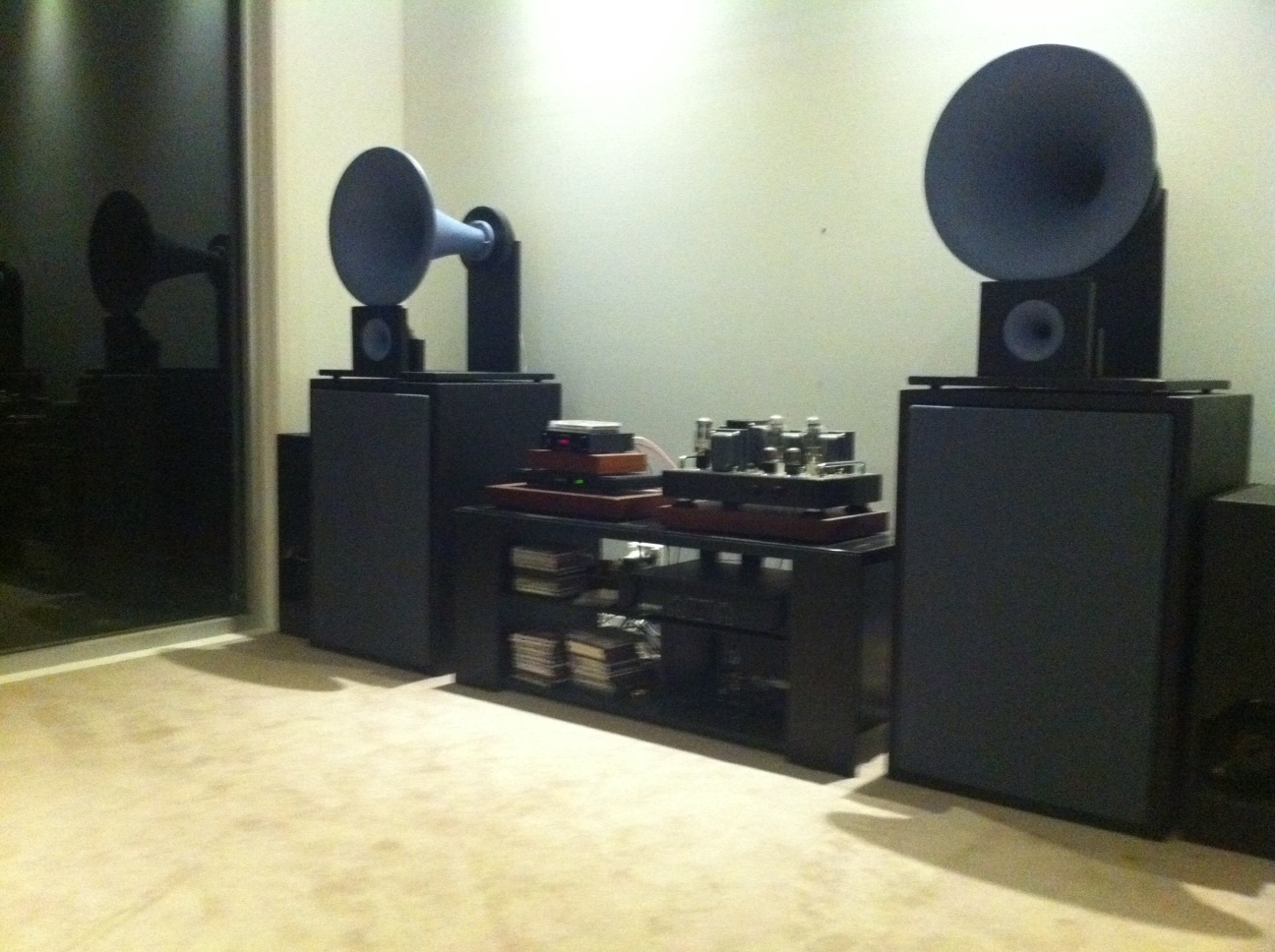

Today, I added back in the Altec horns and 288 drivers....getting to sound very good indeed...three amps all trying their best....the scale is very good. Crappy electronic cap on the horns at 500Hz...and MiniDSP for Lab12 bass (150Hz), then 550Hz for the mid bass.
I'm quite wrapped in the little Class D amp...not powerful, but very clean.
Have Mark Knoffler cranked up loud....
I should be outside with my electric plane and sander to get the large curve made on the Yuichi horns...but I'm petrified....!

Yeh, 12 inch vintage Magnavox alnico.

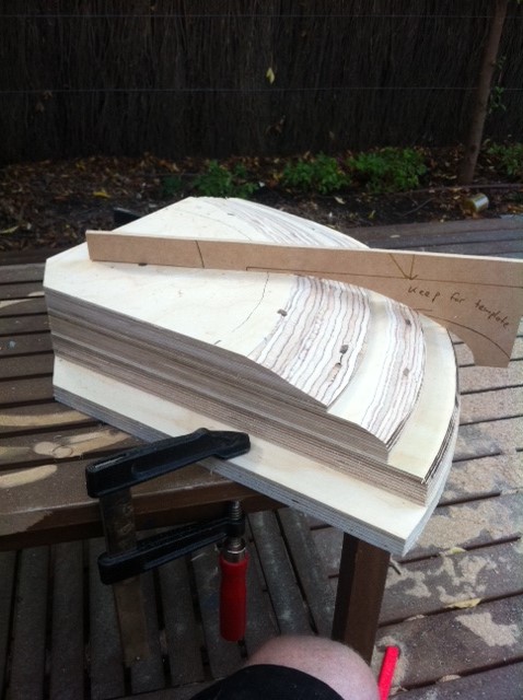

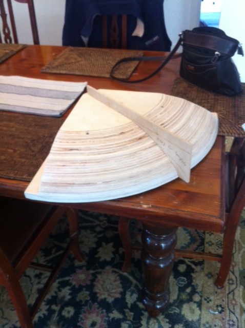

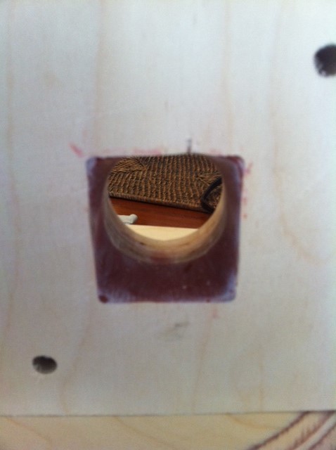

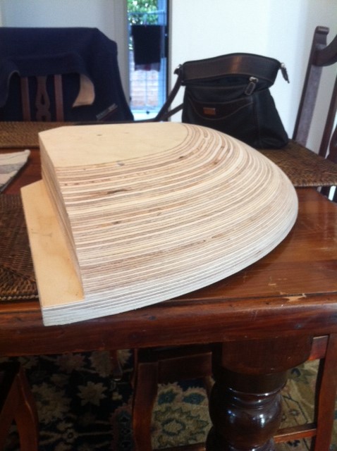

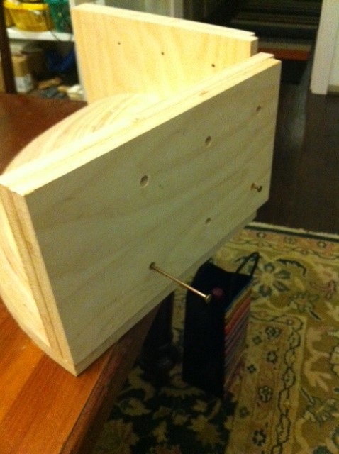

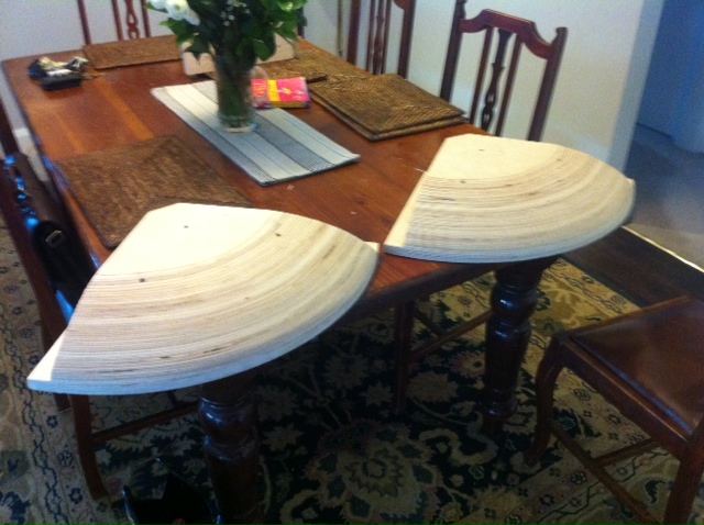

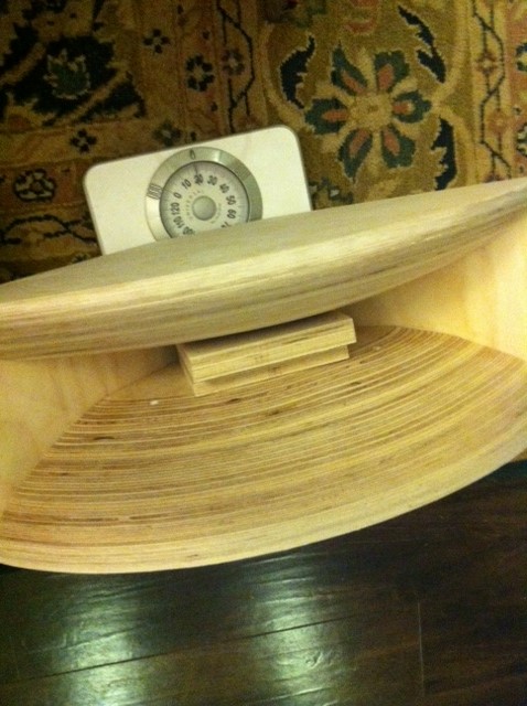

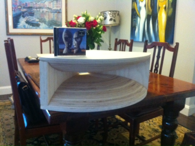

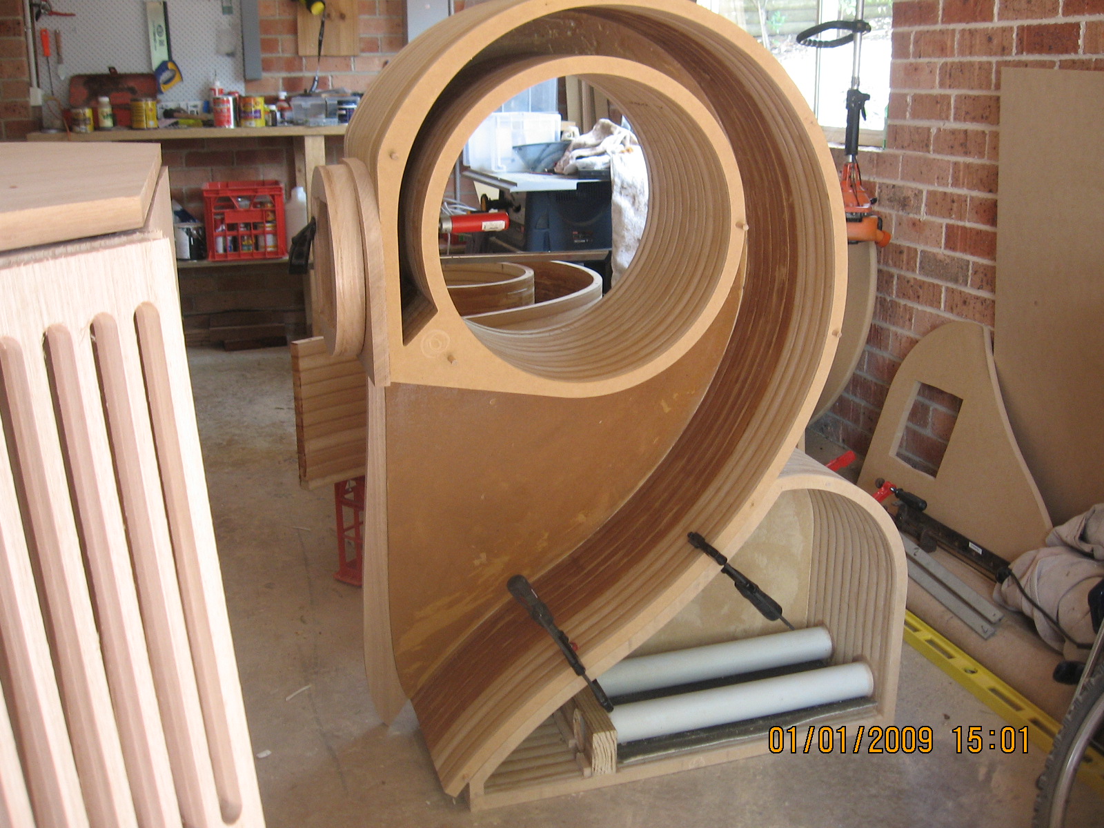

Much relieved to have finished planing and sanding one horn section...took about two hours...quite hard...but got there. It will be next weekend before I get to the other three.
Have filled the horn adapters with resin/bog, then filed and sanded to get the right (and difficult) round to rectangular shape. A little bit of standard putty to fill any holes will finish that part off.

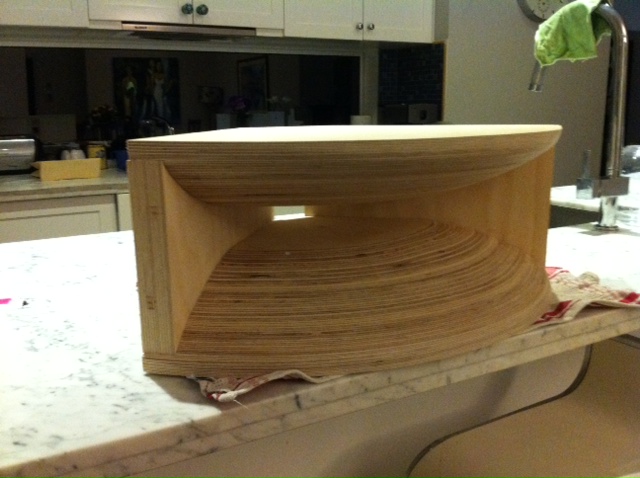

Just curious as to which version of the 290 Yuichi did you use with the 288's... 290, 290S or 290FL are the ones that I see on his website. Thanks for the pics, it must have been a lot of work and it sure looks nice.
It is the 290s...this has straight sides, though the last 20 cm inside is curved out a little....I'll do this later.
I chose this version because it is easier to build. Actually, using CNC, the standard 290 model would have been easier, as I would have cnc'd the curved sides in layers. Anyway, I've already drawn up that CAD plan for possible future use.
Certainly helped having the fins cnc'd.
Andrew

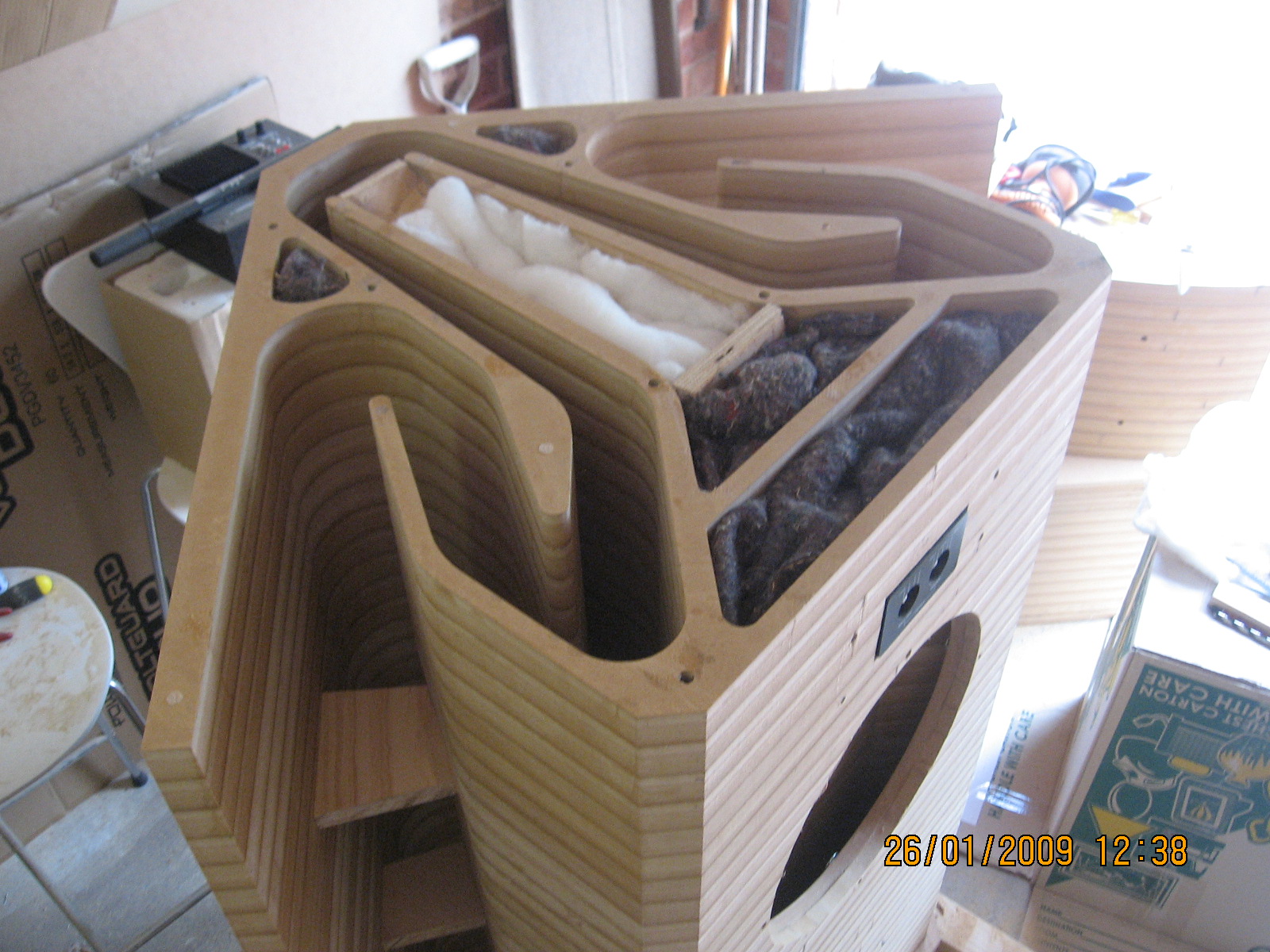

Ah yes, I remember seeing your horns when I last used a pair of FE108EƩ. Are you still into rear loaded FR?
The Yuichi looks similar to my lower mid horn (hypex/LeCleach) at the mouth. Hope you like it.
I still love BLH's for sure. Just last week I was lucky to buy back my very first build, the medallion II horn. With fostex 206E it really is a great speaker.

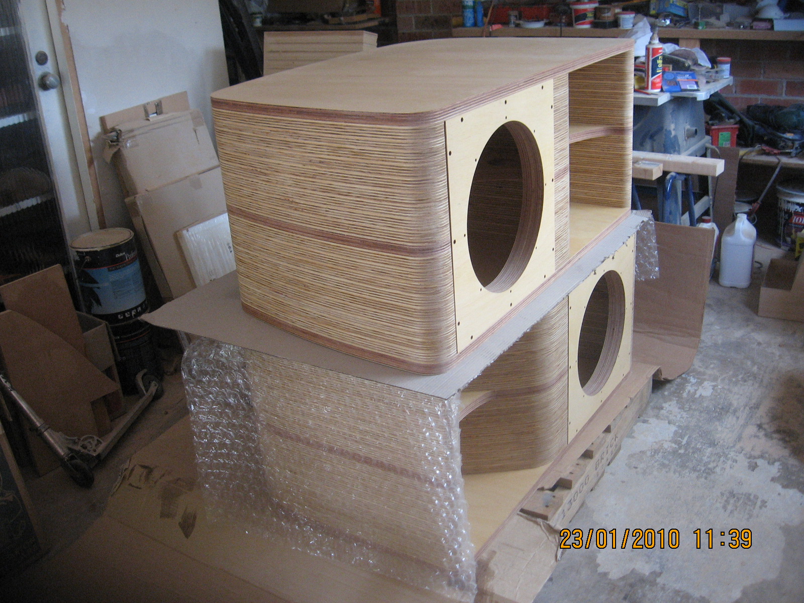

In terms of BLH's, I have built medallion, carfrae, big fun, plus my radical own design, the C-horn. Was also the co designer of the new lowther Hornet here in Oz.

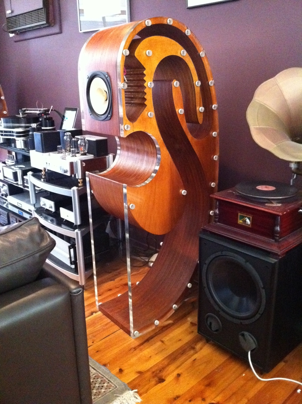

Also, I've enjoyed Tannoy rear loaded horns, having built a few GRF's...both the 'smaller' Rectangular version and the large corner horn.
I have also designed bass horns for GOTO USA, based on this modern version of the Jensen Imperial...
Of late, though, I've really enjoyed front loaded horns...and have built Klipsch Cornscalla (Bob Crites) using two way Faital Pro components, Altec Stonehenge with 604 from Great Plains Audio, Altec 620 with 902 and 416 components, plus a three-way horn of my own design using composite stone horns from Stereolabs (Germany).
The current Yuichi/Altec multi-way/multi-amp design is a culmination of my past 10 years of building/dabbling.
