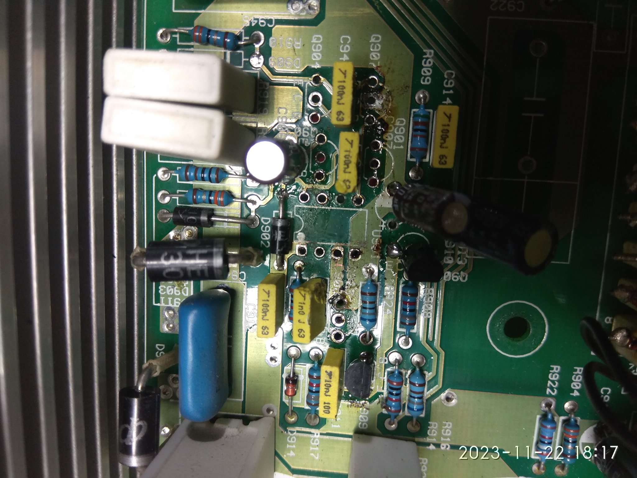

if the supply works with light bulb but burns up when connected directly i would look for a fault in the output amplifiers.
Sorry i must clarify that smps(second time repair attempt) was under test WITHOUT any load.Amplifier disconnected!
I have also test power amplifier for shorted output power transistors.
Sorry,one more time.
SMPS working ok Without load(light bulb connected). This has been tried ,repeating on-off-on many times.
SMPS burn instadly Without load(directly connected to the main).no light bulb.

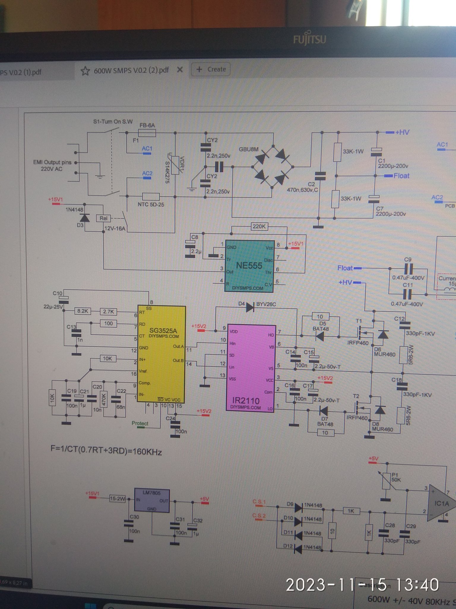

Yes, it is a vexing fault…. The waveforms of post 54 say it all - if the burn up also happens with NO Load. It’s only running around 80% duty cycle, so unless those off times get just stupidly spread out the converter itself will run fine. Not even requiring a resonant mode. Those effects are load dependent.
Whatever the problem, it’s happening right at start up, and the resistance of the bulb limiter mitigated it. If something is happening out of sequence at start up (perhaps forcing both IGBTs on for a few microseconds) it’s going to be very hard to capture. In that case, slowing down the start up is the only way. If the “NTC” has a shorting relay it’s probably really a “PTC” which emulates the light bulb. You may just need more hot resistance to be safe. It sounds like that IR chip was just a bad idea from the start, and that an old TL494 and separate high/low side driver chip - from IR - would have been better.

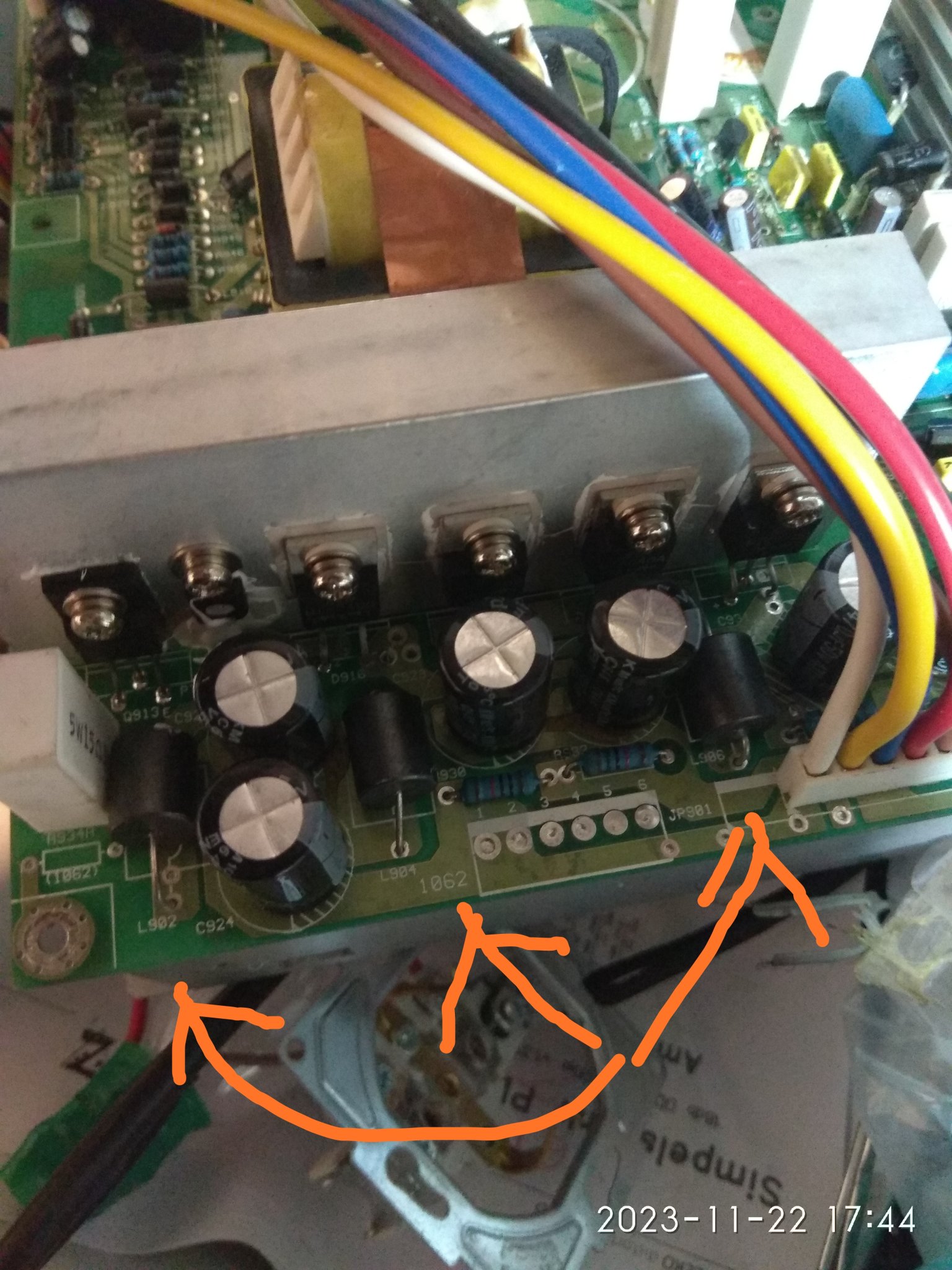

Another possibility is that the 3.4 uH in the transformer just might not be enough to allow empty capacitors on the secondary side to charge safely the FIRST time. This would also show up at extremely heavy load, as the charging pulses would get to dangerous levels. Normal light loads would run with no problem - AFTER successful start up. This is just a design problem. The solution would be a softER start up, and putting about 20 uH in between the secondary rectifiers and the caps. That will slow the charging down. It’s a LOT easier on the rectifiers and caps too. You lose a little peak power (supply drops a little faster under load) but no RMS power (it drops to the same level at full load, dictated by the duty cycle). That duty cycle looks like about 80% to me - which should allow a sloppy, hard switched circuit to work safely.

Speaking for modifications what's your opinion if i place a small circuit around LM555 to control the relay,given more time delay at start up?
Like in this circuit.
I would limit the peak CURRENT to lower value at start up, rather than just giving it more time.

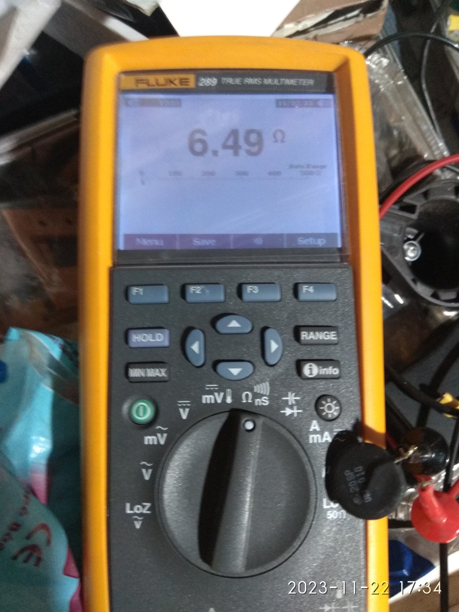

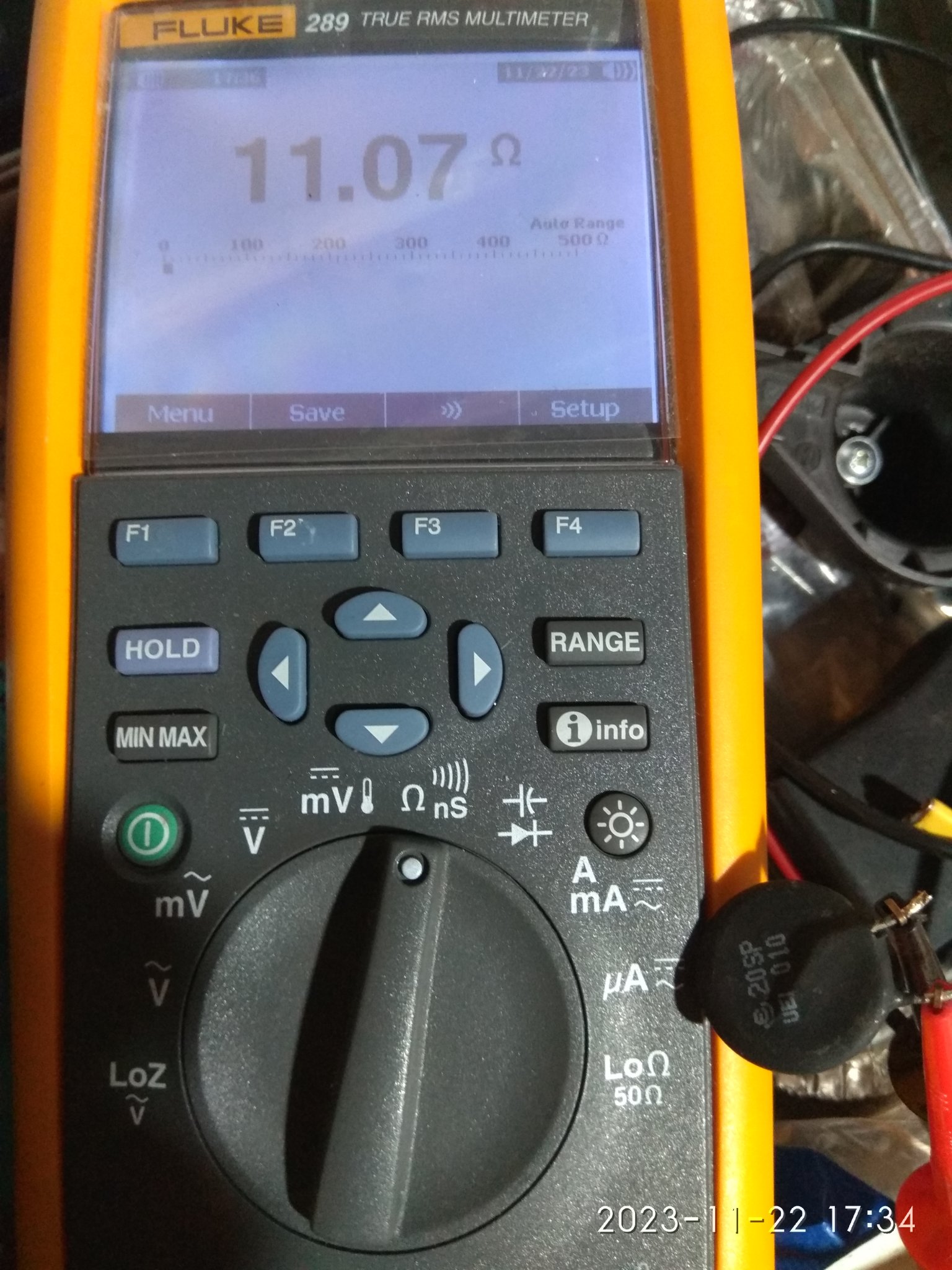

Sorry,thermistor is an NTC type.
Checked.
Cold is 10 ohm.
Lower resistance as go hot.
Another modification...10ohm/5w resistor in series with the thermistor?
Checked.
Cold is 10 ohm.
That is designed to limit the peak off the MAINS for charging the 340V bus so you don’t fuse the switch contacts. That in no way helps with start up surges in the converter, which is what apparently is happening.
Caps are pretty small, and it does use filter inductors so the designers at least thought THAT through properly. If nothing there is fried it shouldn’t have excessive draw off the secondary. I’ve seen them use 4700uf and no inductance save the leakage reactance in the trafo. Ive blown hexfets across the room doing that myself without a ramp-up in the converter duty cycle. Got to be a problem with the switching controller chip section itself.
