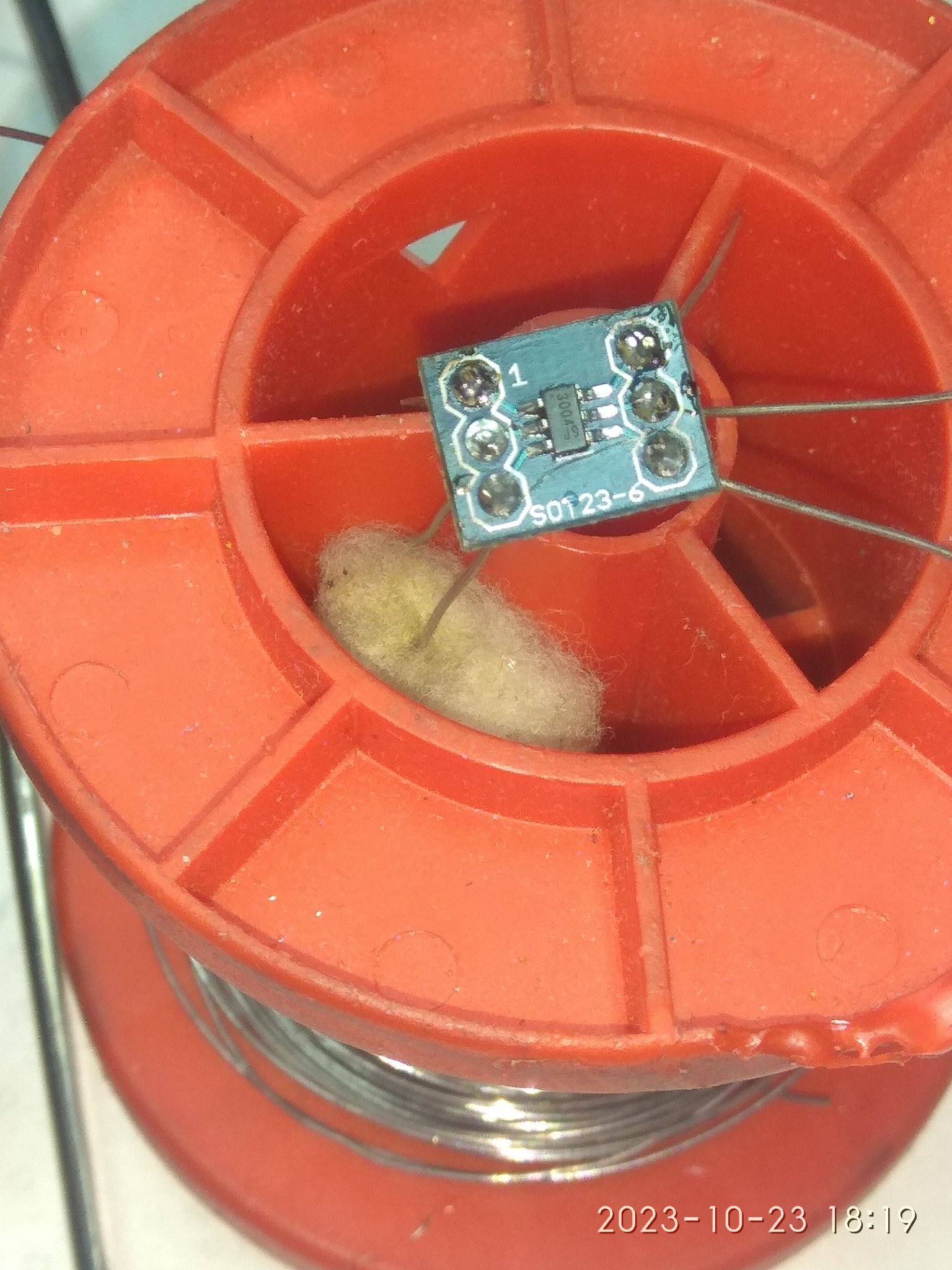

I will order both and i will try to use the sot23 as i see that is designed for the job "The ZXGD3004E6 is a high-speed, non-inverting single gate driver designed for switching MOSFETs or IGBTS."
If this will be very difficult to solder,i will use the SOT89.

https://gr.mouser.com/ProductDetail/SparkFun/BOB-00717?qs=WyAARYrbSnbMtAdXyeHyNw==
This adapter will be usefull

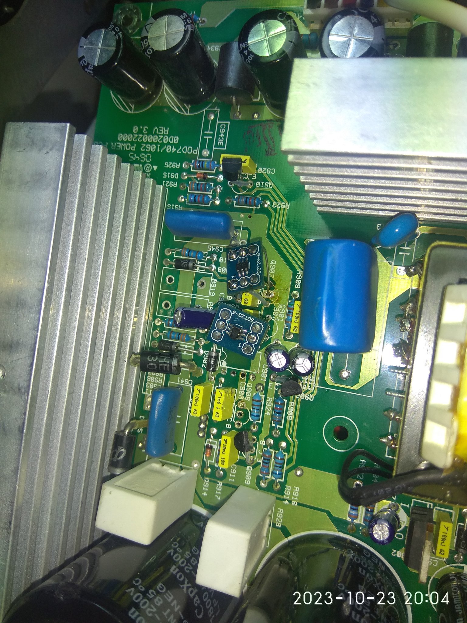

one option to replace the NPN PNP with a sot26 smd from zetex, they have gate drive packages NPN and PNP in one package capable of driving igbt's with 2A peak currents. for example ZXGD3004E6.. made for the heavy lifting..

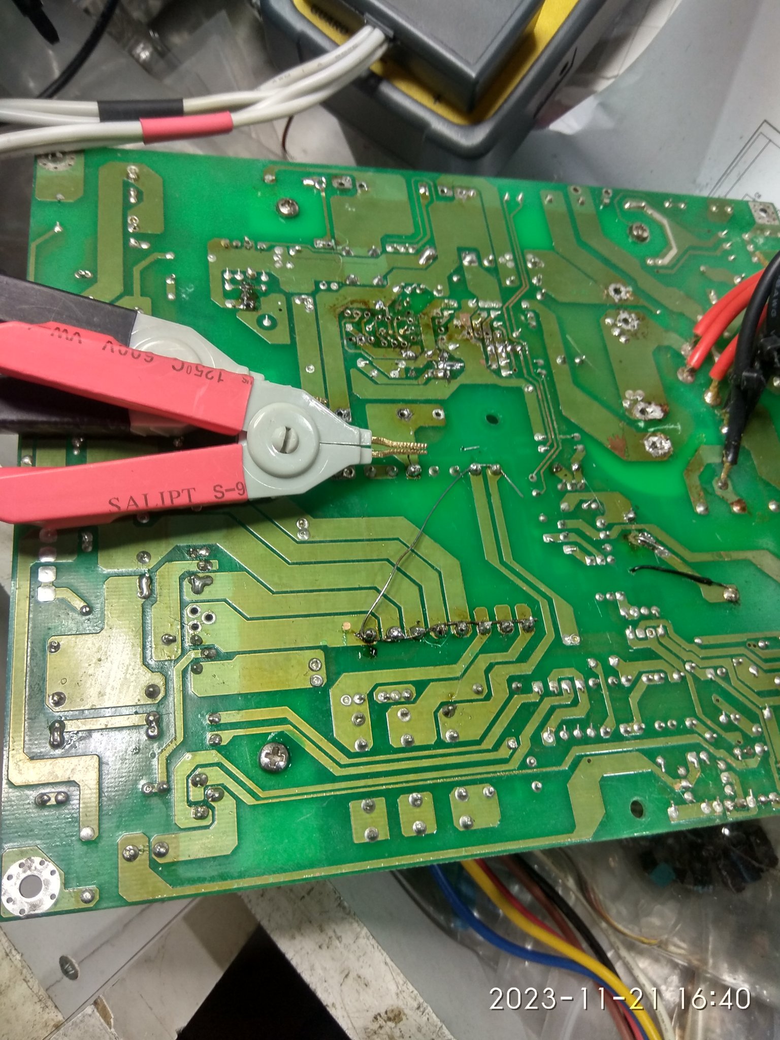

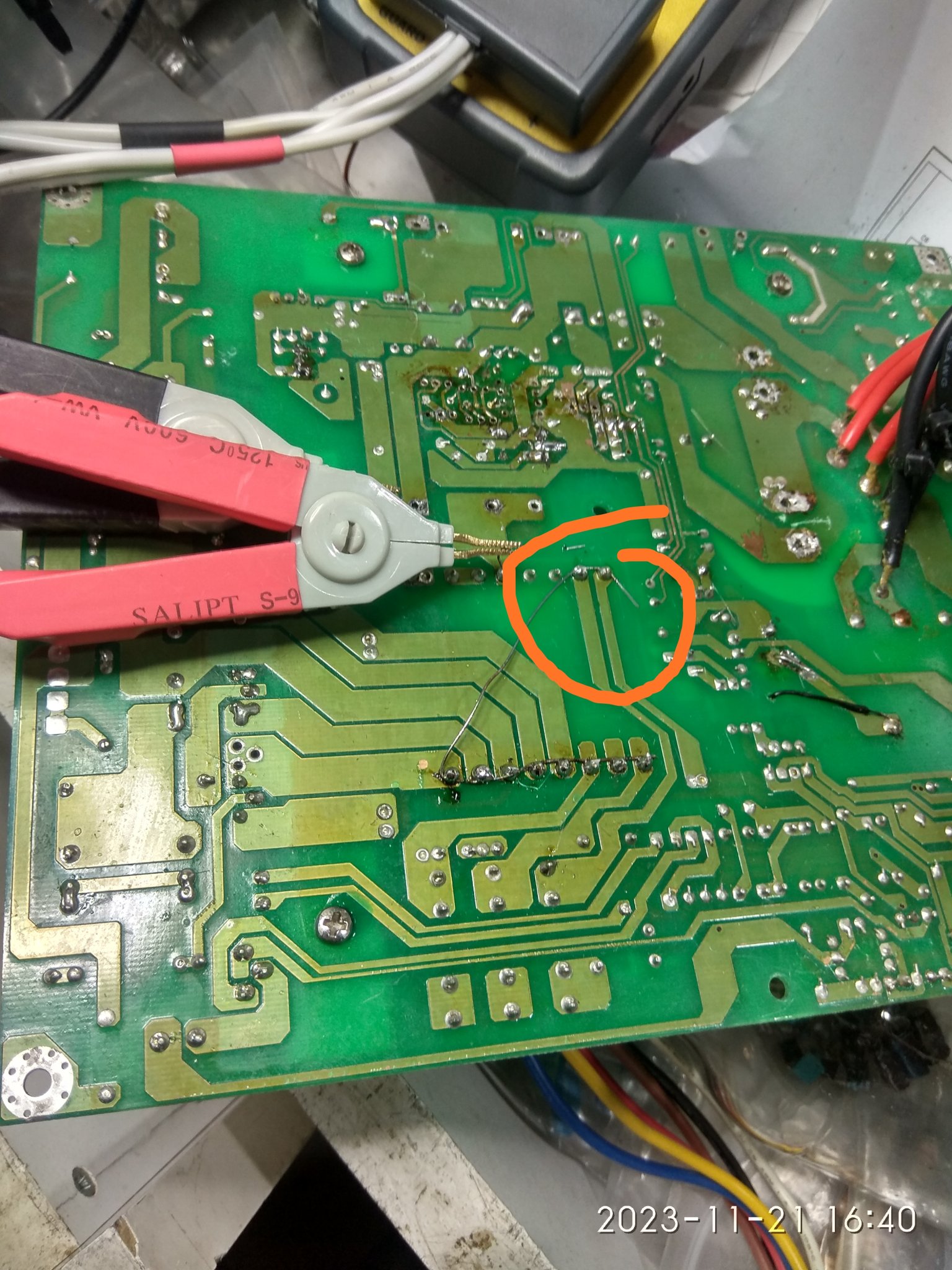

Hi greenocean,i decided to repair it one last time.
This time i will change all the small caps.
Waiting for parts to arrive i have desoldered C913,C916 among with others.
I have measured all and i can't see any out of specs.
Although this,i will replace all.
Unfortunately my first test was for capacitance only.
Trying to measure for ESR the other day using another measurement tool DER EE5000, i discovered that i lost this 22uf.
I have tried hard to find this but no luck.
You are right about the delay,i have make this circuit on a breadboard to study further.
I have placed the collector of Q908 to the positive supply through a resistor connected in series with a Led and i see clearly the delay.
Please look here post #29 for more details https://www.diyaudio.com/community/threads/help-me-to-find-an-igbt-alternative.405204/page-2

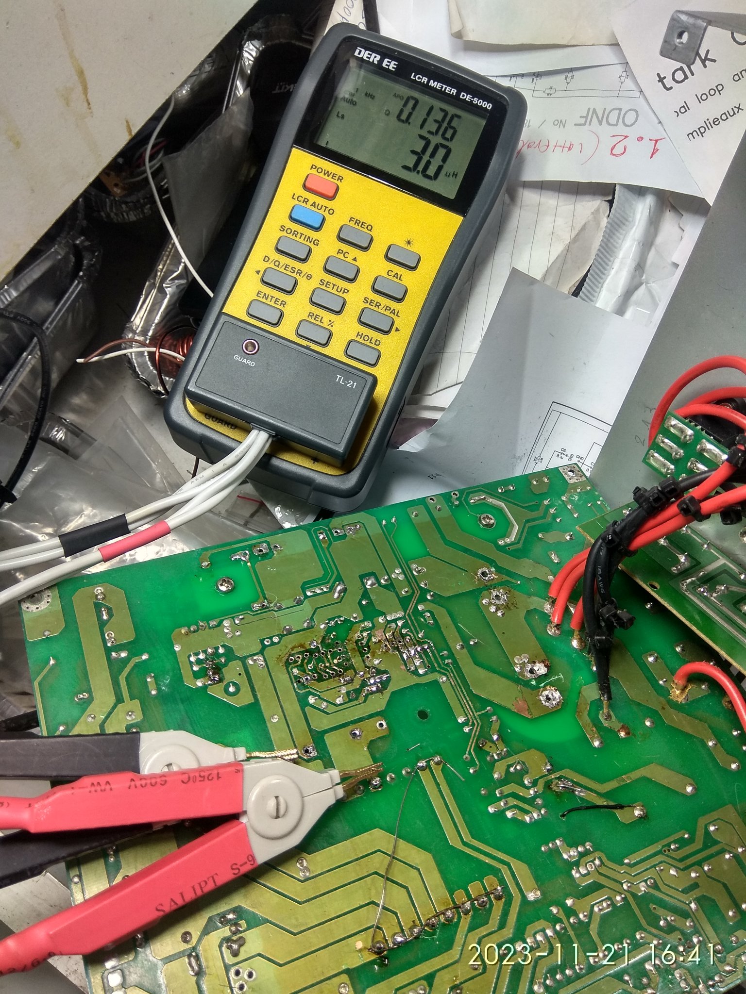

can you measure C922 value and transformer leakage inductance (measure primary inductance with all secondary shorted).
I want to know the resonant frequency (Fr)
in my calculation switching frequency (Fs) will be arround 70-72kHz (with 10K and 1nF)

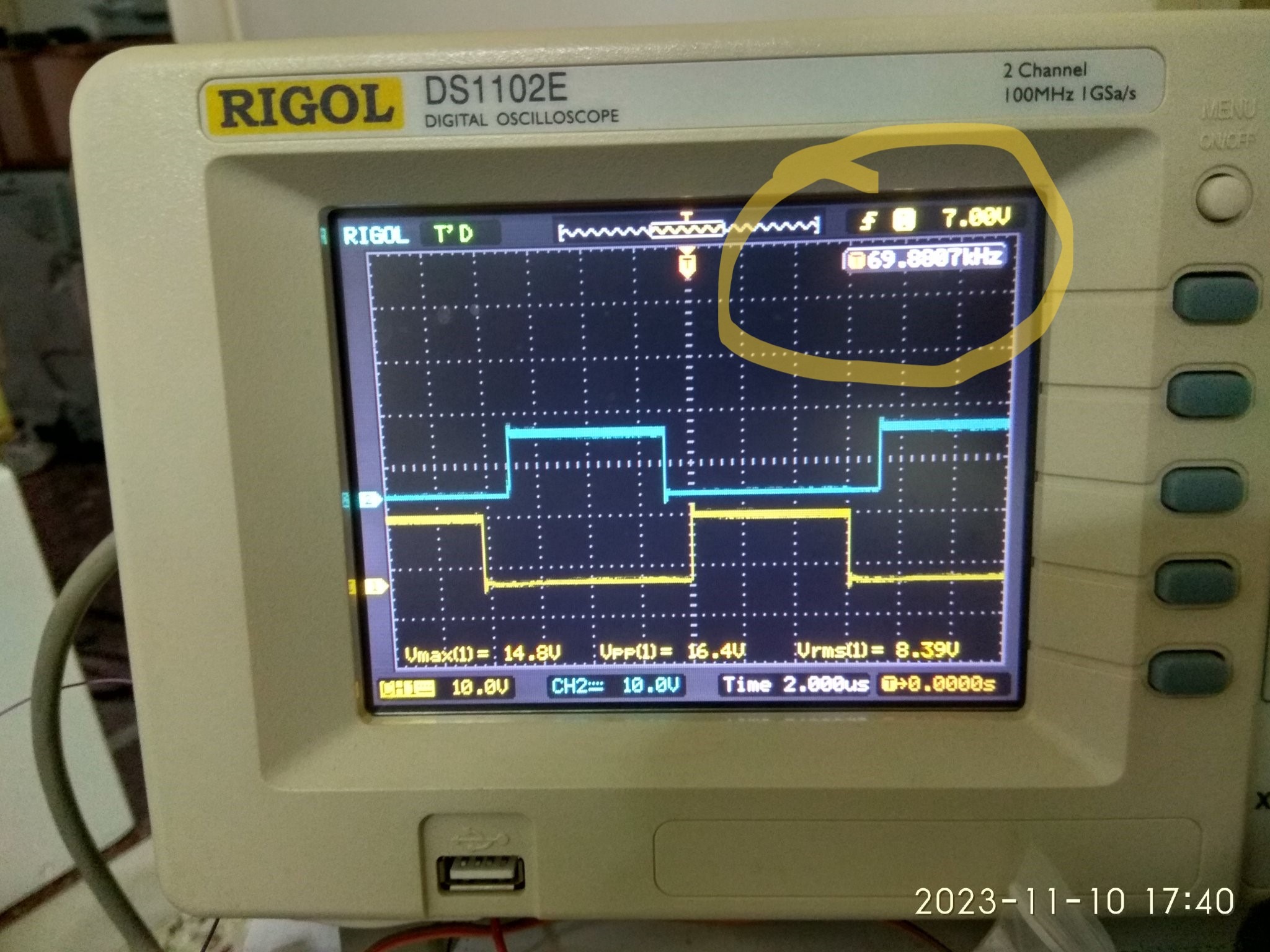

I have measured frecuency when it was working with the in series bulb .
It was 70khz,the same as in the test circuit.
C922=1uf measured out of circuit.
I can measure the transformer leakage inductance this afternoon.
Thank you for the interesting!
it looks normal with 3uH and 1uF then the resonant frequency is 91kHz.

Can you calculate again using 3.4uH and 1uf?
I asked because i have short a coil that is in the primary side too.
Ieaving this open the measured value is 3.4uH.

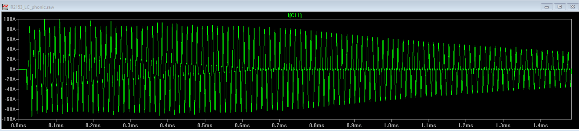

it's around 86kHz https://goodcalculators.com/resonant-frequency-calculator/
yes I noticed it. after successfully start with light bulb it will be fine, but without it maybe next day, next month... it will burned at startup.
also NTC needs time to cooldown to reset it's value, rapid on off will burn IGBT
this is LC series resonant converter working in ZCS region (Fs below Fr)
if we shift resonant frequency higher then peak current at startup will be lower. but maximum peak power will be reduced

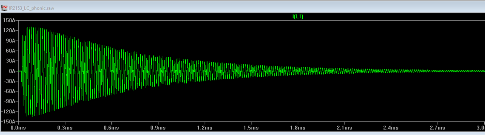

this is the startup current flowing through C922 (1uf and 3.4uH). please notice that the power source in simulation is ideal
I change C22 to 560nF (Fr = 115kHz), startup current reduced
what I can suggest is:
1. Try to increase NTC value, ex. 47D15
2. Try to reduce C22 ex. 560nF (resonant capacitor) to shift resonant frequency up
3. put your light bulb in place of NTC if there is enough space. it's crazy but it works
4. replace controller, maybe I can help (design) but it may take a few days
