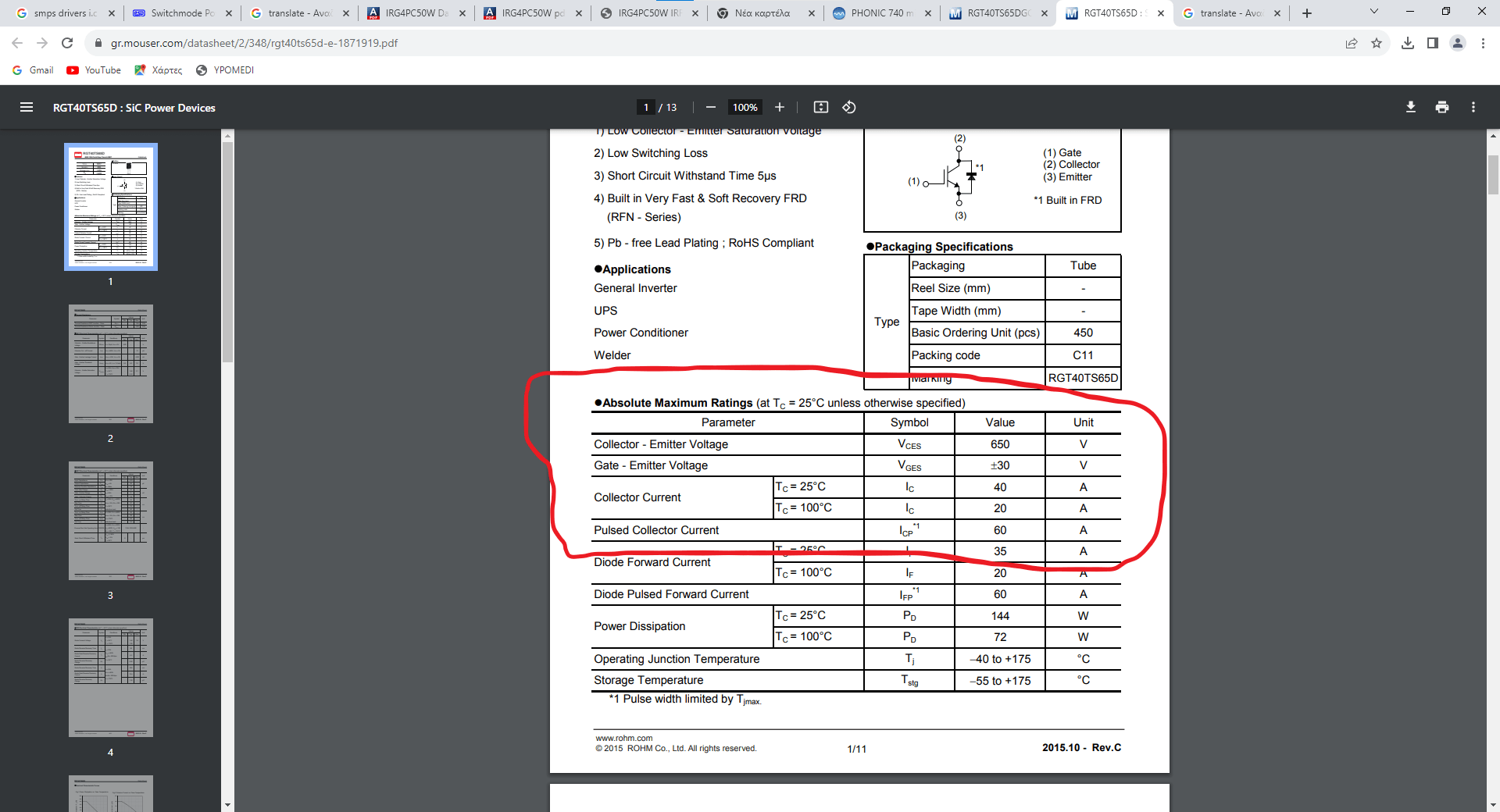

Looking at the IGBT specs,i see big differance in this area.
Pulced collector current. Icm=220A for the IRG4PC50W
Pulced collector current. Icp=60A for RGT40TS65DGC11
I don't know if this is something important.

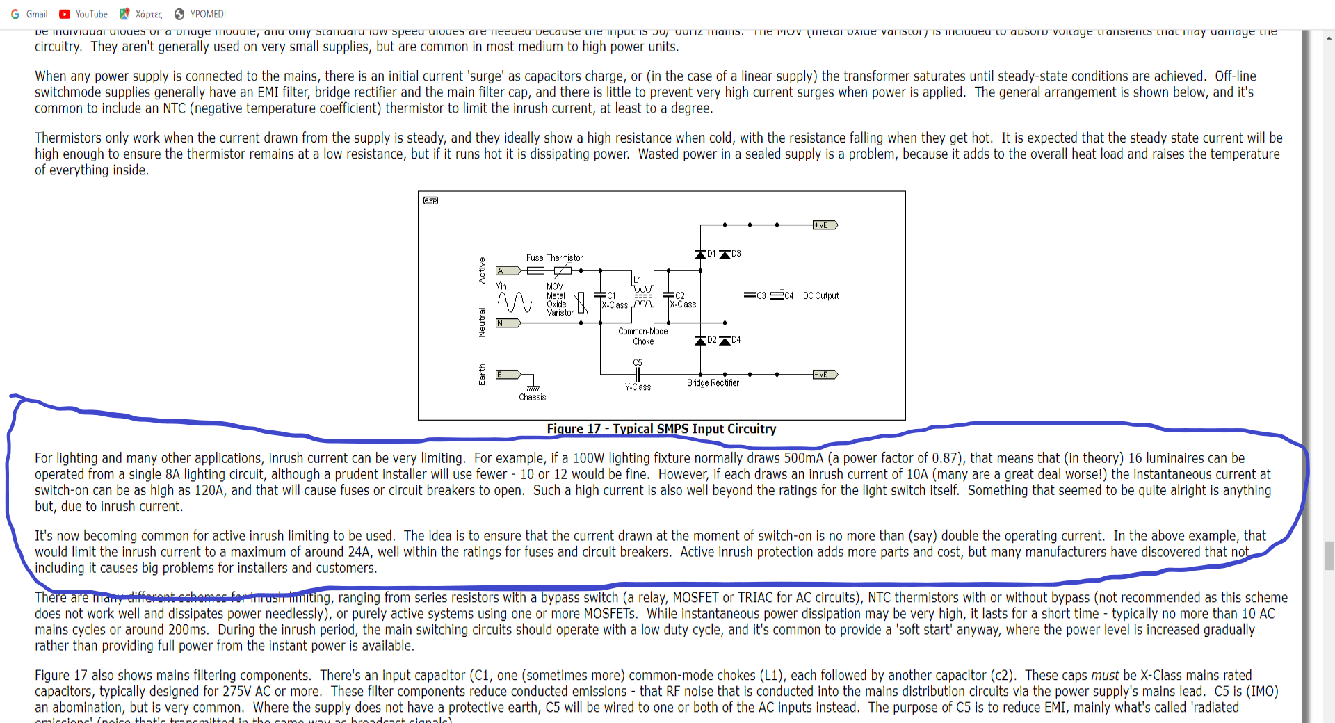

I asked this because i read by Eliot here.https://sound-au.com/articles/smps-primer.html

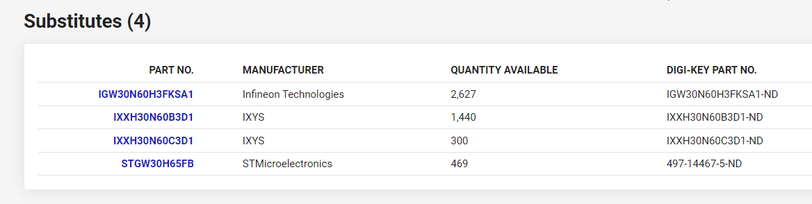

all suggested by digikey as substitution for IRG4PC50W have lower pulsed drain current

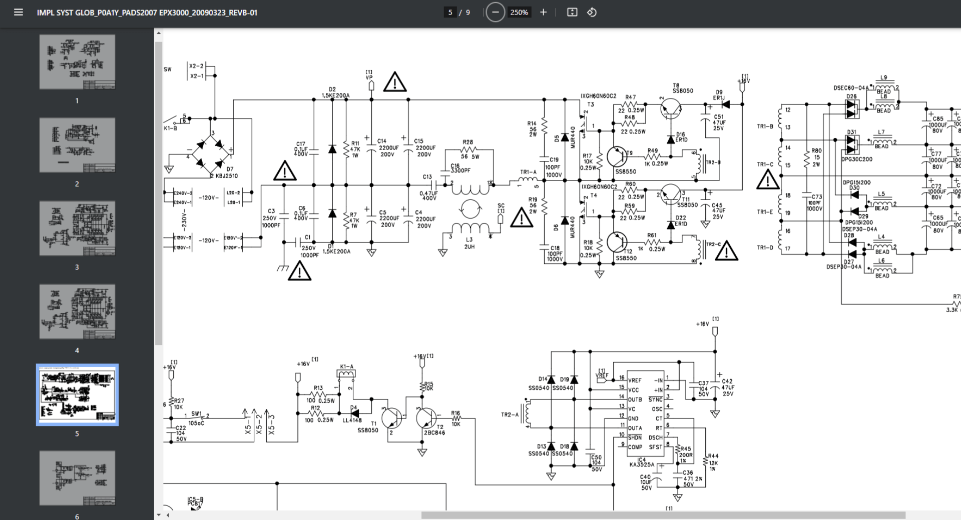

I found this 300A pulsed current used by behringer : IXGH60N60C3D1
220A Icm : STGW40NC60KD, crown uses STGY40NC60VD
I checked behringer sps1000 and yamaha emx5000 (IR2153) use 1MBK50D (150A Icp)

This one IGW30N60H3 is the recommented by the infineon as alternative to IRG4PC50W.
https://gr.mouser.com/ProductDetail/726-IGW30N60H3
As I mentioned before, that particular inrush current happens before it EVER sees an IGBT. And cannot be the cause of their failure.I asked this because i read by Eliot here.https://sound-au.com/articles/smps-primer.html
Charging the capacitors on the secondary side of the converter CAN kill the IGBTs. But your board has pretty small caps and does include inductors after the rectifier. That USUALLY makes a soft start, ie, slow ramp up in duty cycle of the converter at start up, unnecessary. The design could be right on the edge, but that would just result in random failures not every single time. It may fix it if that feature is added. If it does they SHOULDNT be shipping these things the way they are at all.

There is more than likely one failure mechanism in a modern transistor. Some are near instantaneous (second breakdown) and others cumulative. One BIG problem with todays stuff is thermal cycling. The attachment of the die to the leadframe gets worse (ie, thermal resistance increases) with each heating/cooling cycle. Eventually they just get hotter than they are supposed to. The inrush/startup current may not do much to a NEW one, but one thats aged might not take it so well.
The light bulb limiter IS a proper soft start circuit. For both the primary and secondary side issues. It just wont ever let you go into normal operation afterward. What I do on my big (non switch mode, BTW) amps is to put a 5 to 20 ohm resistor, 20 to 50 watt depending on resistance, in series with the mains. And a voltage detector that detects near full voltage and shorts it with a relay. It also locks out connecting the speaker until the cycle completes - the supply stays lightly loaded during the charge cycle. It will work equally well with switch mode supplies, but I use it with big toroids and banks of big caps. I don’t like blowing rectifiers or blasting pieces of the plug prongs off every time it’s plugged in.
A large PTC (not NTC) thermistor will also work as it will keep the surge current down if persists. An NTC doesn’t really “need” to be shorted as it’s resistance will drop on its own, but offers limited protection.
Yes i see,but if dc to dc converter is doing something why with the light bulb tester serves this well?
To my point of view,if you it doesn't shorted it become very hot during operation.There is more than likely one failure mechanism in a modern transistor. Some are near instantaneous (second breakdown) and others cumulative. One BIG problem with todays stuff is thermal cycling. The attachment of the die to the leadframe gets worse (ie, thermal resistance increases) with each heating/cooling cycle. Eventually they just get hotter than they are supposed to. The inrush/startup current may not do much to a NEW one, but one thats aged might not take it so well.
Suppose that someone push the on- off switch repeatedly,no inrush current limiter exists because NTC is still very hot.

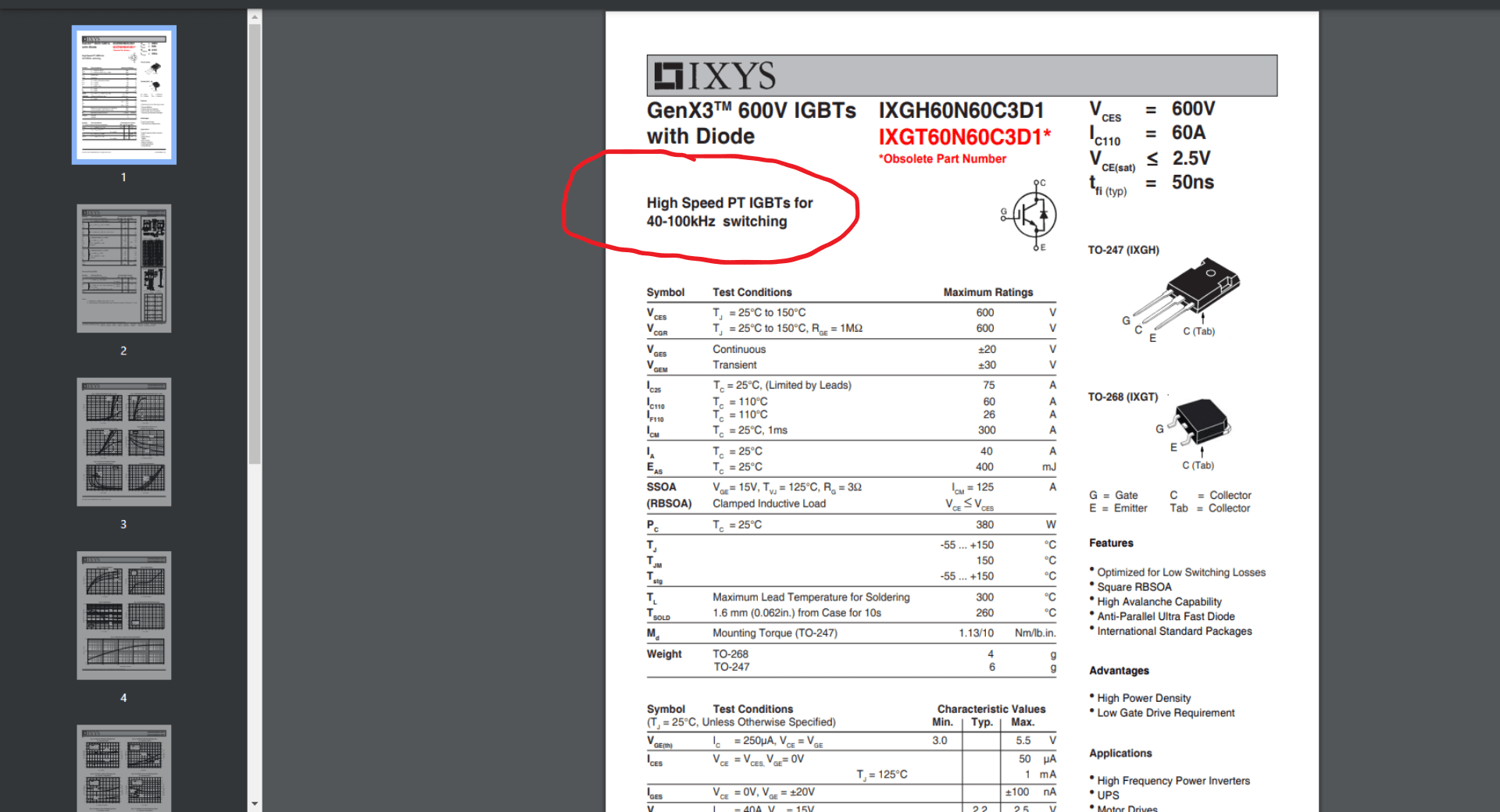

Please can you tell me the behringer model that you speaking about?
This is the most expensive(11euro) IGBT and the only one that is available,but i like the 300A Icm.

I hope that i can use the same driver combination too ,SS8050,SS8550,available in Mouser.

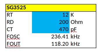

BTW I know that RT CT (pin 5,6 of SC3525)is the oscillator parts but i can't calculate the frequency.
Please can you help?I want to know the operating frecuency that is used this IGBT.😉
Strange that IGBT is out of spects,or this 100khz is for hard switching and in resonant mode this can work in higher frecuencies?
Finally i will use the IXGH60N60C3D1 IGBT module.

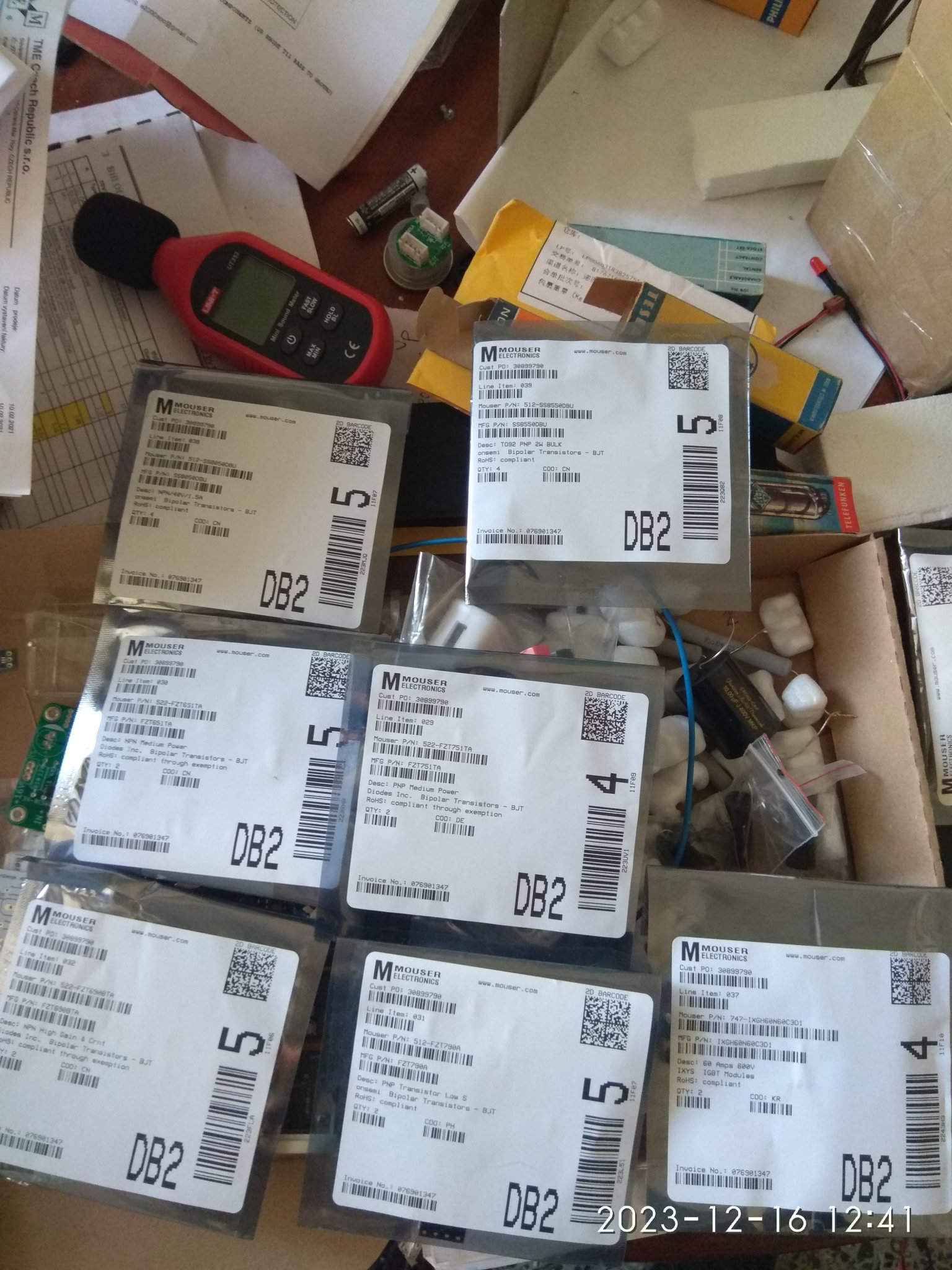

As i don't trust drivers i have (2SC2655,A1020),what drivers you would recommend from those in picture regardless of the case style?
