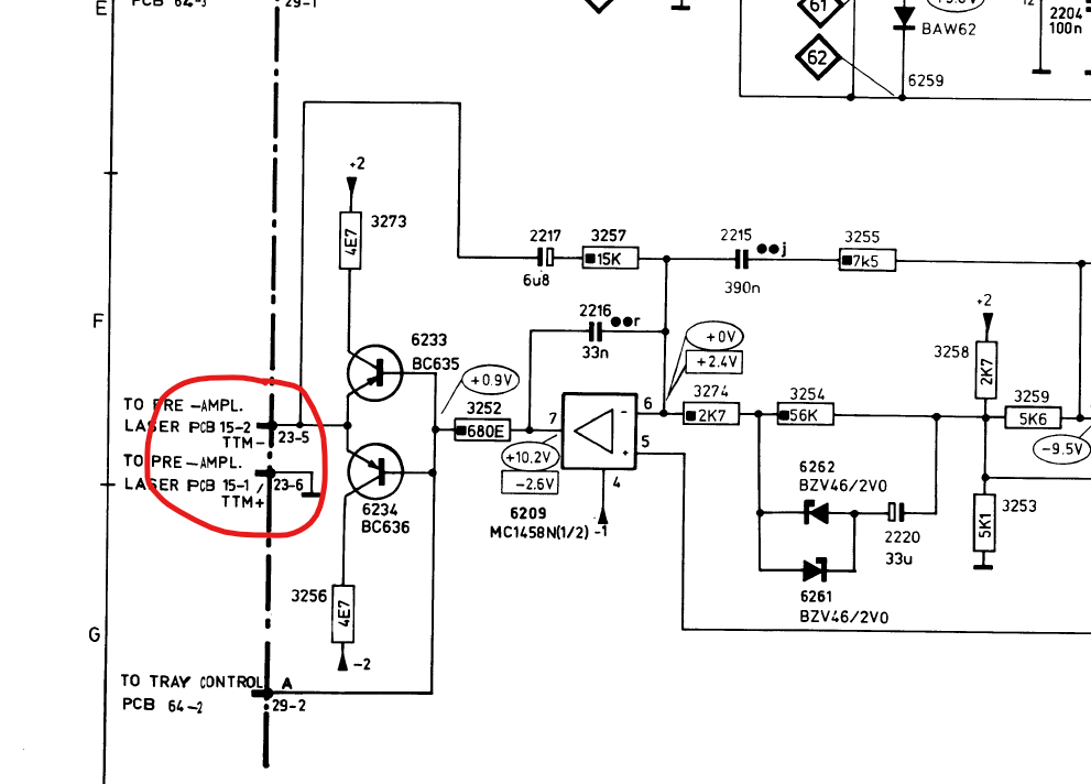

Is this a DC motor in this one, I know Philips used all sorts (DC, brushless, Hall effect etc) in the same units sometimes.
Years ago in the early days of VCR's (the old mechanical piano key machines) the head drum was belt driven off a small DC motor and servo problems became common. The cause was the motor and a pretty definitive test was to look at the ripple voltage on a scope across the motor (beware scope lead grounding if you try this). A good motor had less than a couple of hundred millivolts ripple as I recall.
No idea how that would work on these as the motors are smaller. You could maybe see if the ripple alters as it gets close to a skip.

So NO scope grounding in this case? As you know I am still a scope greenhorn.beware scope lead grounding if you try this

Ideally you connect the scope across the motor but that is only possible if one end of the motor is ground referenced to zero volts. If not you will have to look at the best way to connect the scope... which end of the motor is driven etc.
Not really but you could fry something in the player.
If in doubt connect the scope ground to the usual audio ground and then probe the motor and see which terminal is the one that is driven.
thanks. I'll try the + connection to the motor first.

I think it is ground referenced. TTM = turntable motor I assume. So just use safety of the normal audio grounds for the scope (the RCA sockets)
