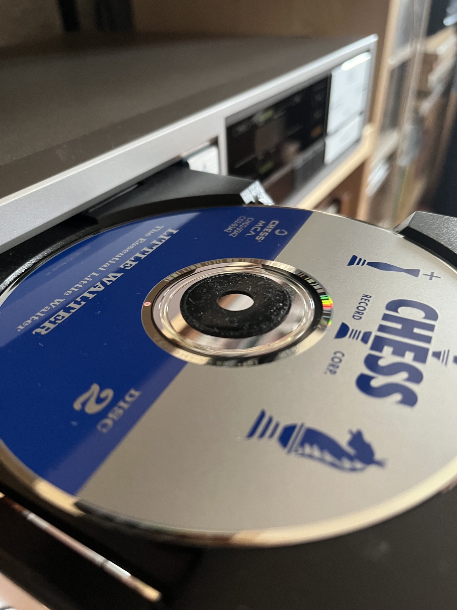

Sorry to hear that.No changes with the ring on the CD.
However the ring I remember was larger, let's say an outer diameter about 3.5 cm with a center hole a little larger than that of the CD itself.
Anyway I would like to be absolutely sure that the CD does not has micrometric movements by slipping onto the spindle so I would fix a second ring even at the bottom of the CD.

In order to get that improvised rubber washer beneath the CD I needed to glue the rubber to the bottom of it, or place it on the spindle and then slip the CD over it. No idea how to do this in the closed cage of the CDM0. I know (as mentioned above) that playing around with the clamp pressure can mitigate skipping, but I did this already and it did not make it go away (It did, when I got the machine three years ago and all sorts of adjustments were out of wack, but I brought those back then). I tend of exclude this track now honestly. Best would be a working drive (and also working boards) to slip into the machine in order to rule stuff out in a modular way, Mooly style 🙂

Ok. Tried it. Stuck it to the disc bottom. With that silicon washer the player would not read the disc.Try it
If I place it under the CD (in a way that it is between spindle and disk) I change the focus height. If it is under the CD and does not touch the spindle it has no effect apart from changing the weight and the required torque.
I changed the focus height already through the Allen screw under the motor shaft bearing plate (to no avail, see somewhere far above in this thread) and also tried to change focus offset (no results).
