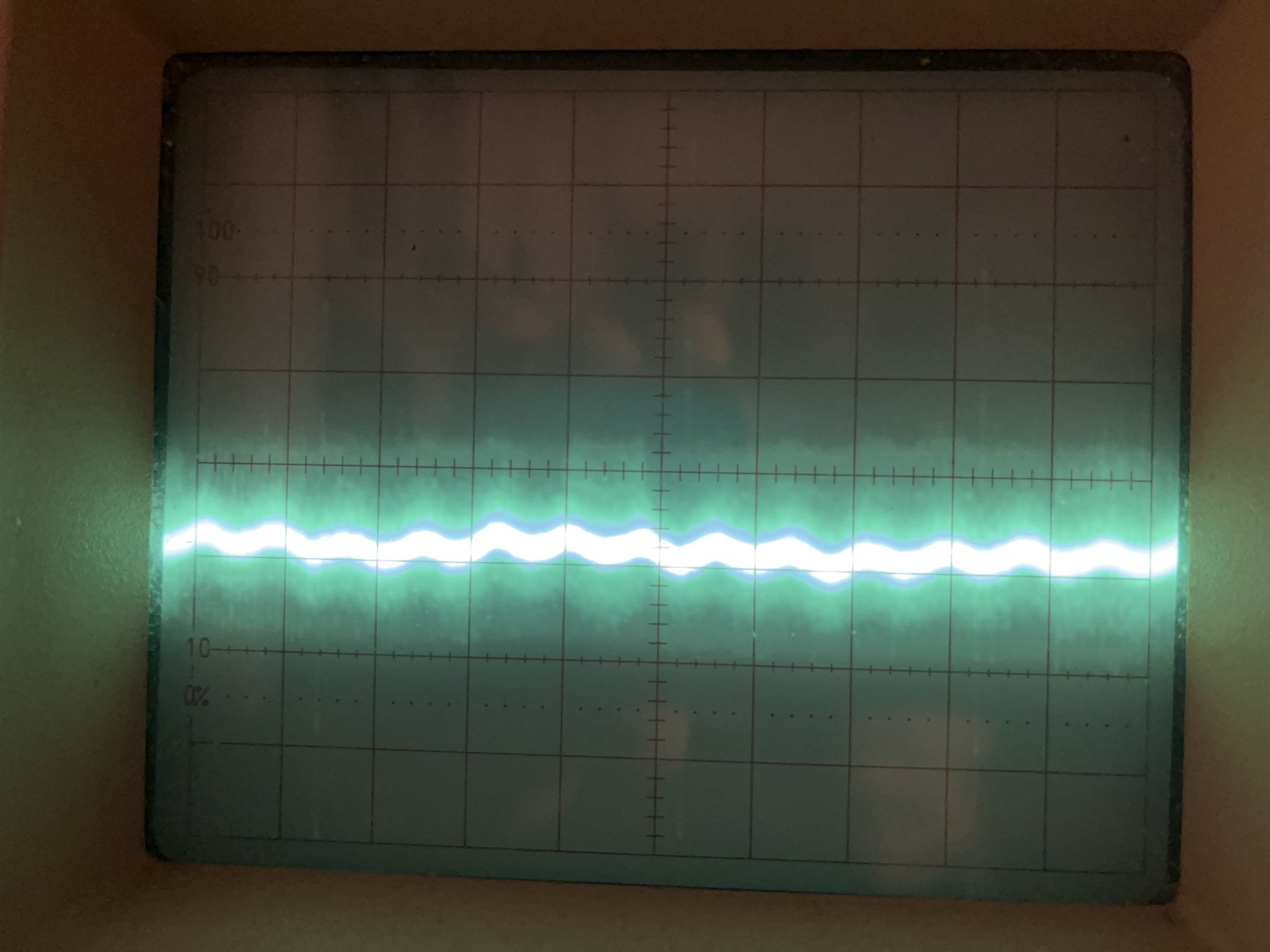

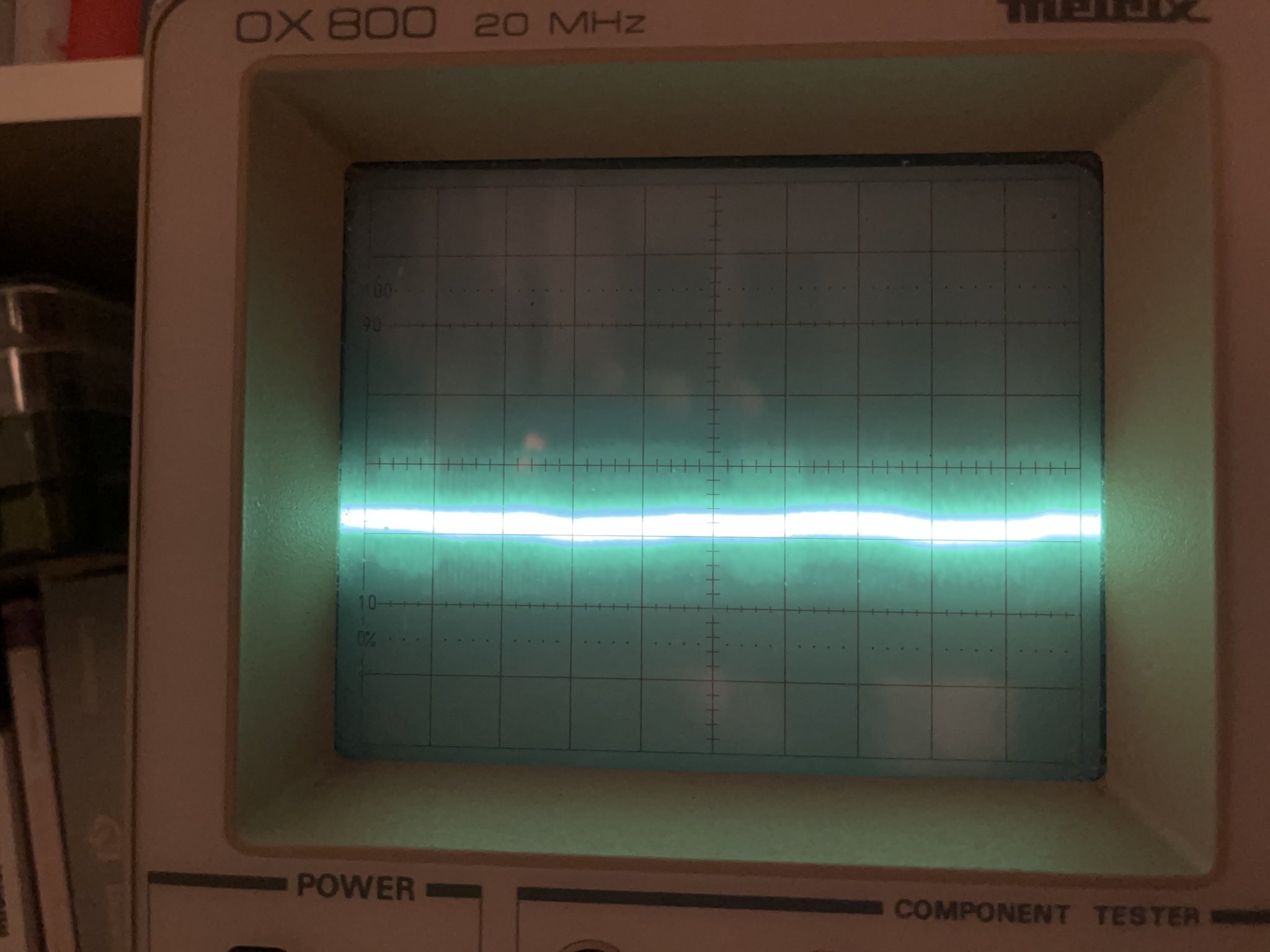

That looks essentially OK, the ripple is low. What we look for are sudden noisy random bursts of ripple indicating a worn or dirty commutator.
(the scope ground should just go to the main 0 volt line. Post #217, the motor is shown as going to ground. Connecting to the minus rail might short the rail out if the player and scope are both mains grounded)

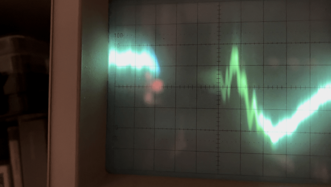

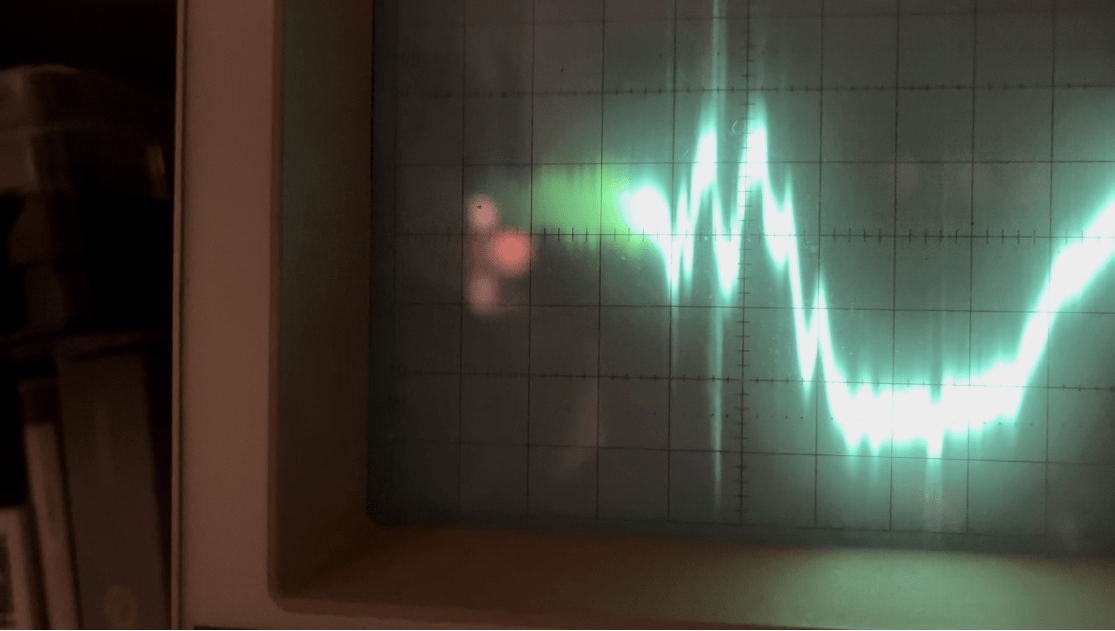

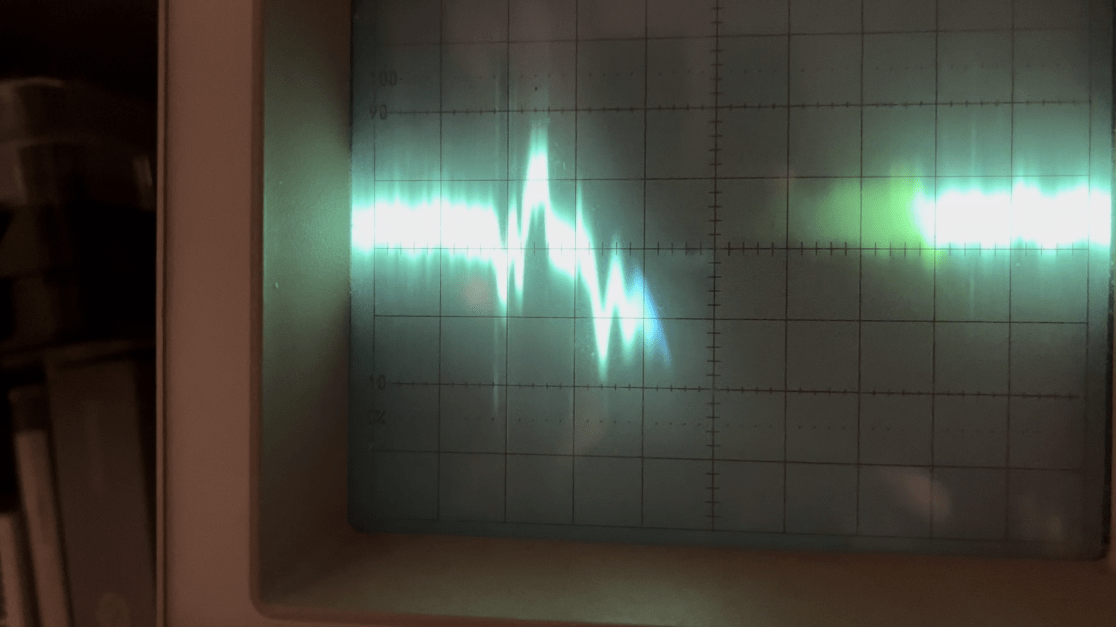

This is what I got with the scope ground probe attached to player ground, see in my dropbox: https://www.dropbox.com/s/73bjba7srvx2yb9/IMG_1910.MOV?dl=0
If you look at the little video, you might even audibly notice the player skip. When it does, the scope shows these patterns:
I honestly don't know. Was it pushed or did it jump 😉 in other words was that cause or was it caused by...
I still think if this was platter/turntable/motor related you would see it do this losing lock while it was paused. Its difficult. We've not had a definitive breakthrough yet on this 🙁

The scenario for the above is that the drive starts to "tick" or "twitter" audibly (as if trying to make more effort to hold the track), then glitches with a louder "tick"/"twitter", wich is visible as the spikes shown on the photos.
I am not sure that if the arm lost track first this would show at all in the spindle motor's behavior, as the spindle drive should be fairly autonomous and, so to speak, just pull through, regardless of the arm skipping. But maybe electrically it is not organized like this.
