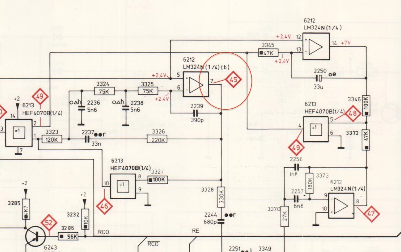

Did you check the Wobble generator, is it working 650 Hz..?
