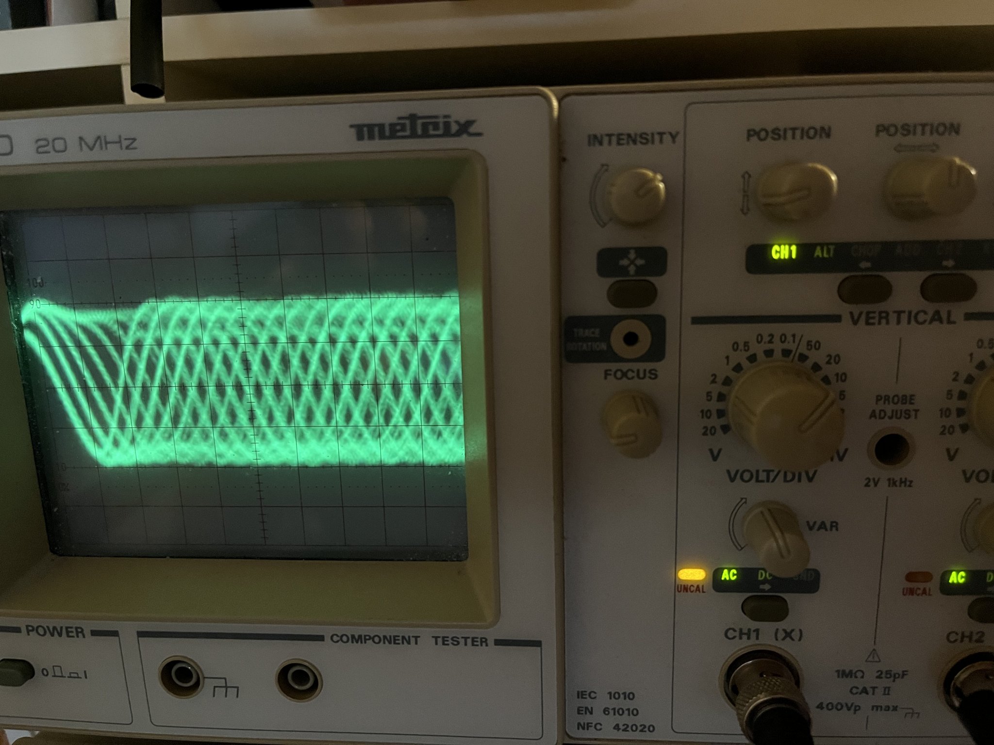

On both settings, 1x and 10x, I get less than 1V peak to peak from the Laser (below) – but it's another CD, one which really badly skips. Here on the 20mV / div setting.

It lights when I turn the VAR knob from its locked position.If that 'uncal' marking in red is a light it should not be lit.

I see you have the 'Var' control in an 'Uncalibrated' position. That Uncal light should be out.
The settings you are using of 20mv/div suggests you are in fact using a 10:1 probe. That divides the voltage by 10. Make sure the probe is compensated correctly using the Cal output. It only takes a few seconds to do. The trimmer is either in the probe body or the probe plug.

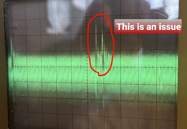

Yes, It sounds like your V axis is out of cal or the variable scale control is activated. The DVM will likely be more accurate and trustworthy in your situation. When you check the 5V to the MAB, put the scope in AC coupled input mode and pull up the vert scale to enlarge the amplitude for a better scale to reference.
The +2 rail is "ok" at 4.8V depending on the load, despite being on the lower end of tolerance. The noise is however a bit high (assuming your checking at the 5mV vert devision setting), specifically the type of noise with its dropouts is somewhat suspect. Try extending the time base a bit to see if there's onset of oscillation. I also don't like the dip in the eye pattern and the one in the 7805 output. Next step would also be to check the clock oscillator input to the MAB and its amplitude at the crystal next to it. That is also a reference for the DAC and DF on some of these players. Yours has the 14bit TDA1540 if Im not mistaken.
I'd replace the 7805 feeding the MAB including any decouplng caps after it. Use standard esr caps and make sure the ground is in place that goes to the front panel. The 2+ rail should be measured at the destination with its corresponding reference ground it sees ie right at the MAB chips B+ and ground. The display brightness will fluctuate if there is anything pulling on that 5V line. Current demand is very high in track seeking mode, but not on the 2+ rail, so if that one dips too low, it can indicate insufficient regulator current or another component drawing more than it should.

Good morning!I see you have the 'Var' control in an 'Uncalibrated' position. That Uncal light should be out.

I had changed the setting to x10 after you mentioned it. (Which then, immediately out of my mind, confused me, as the readings were far to low... 10 times actually
I played around with the scope a bit yesterday, also used channel 2. It is not different from 1.
The VAR light comes on when I use the VAR knob in order to adjust the wave form to the grid on the screen, hence sort of calibrate it by hand.

I measured the +2 (5V) line close to the MAB. Nothing pulled it down, no fluctuation of display lights.
I checked at the 5mV div. Did you look at the video with the voltage sagging? I also have these spikes.

Once the light is on the scope is uncalibrated and the volts/div are then meaningless. You always have to measure the amplitude with it 'calibrated' (light off). The RF should then be around 1 to 1.2 volts peak to peak on the scope.
That means with a X10 probe and with the scope on 50mv/div the RF should fill two squares for 1 volt peak to peak amplitude and two squares and two small divisions for 1.2 volts peak to peak.

Spikes are normal on any rail that is delivering a pulsed spiky load current. Amplitude matters of course but a few 10's of millivolts (bearing in mind you will not be using the exact correct grounds for measurement) is fine.
