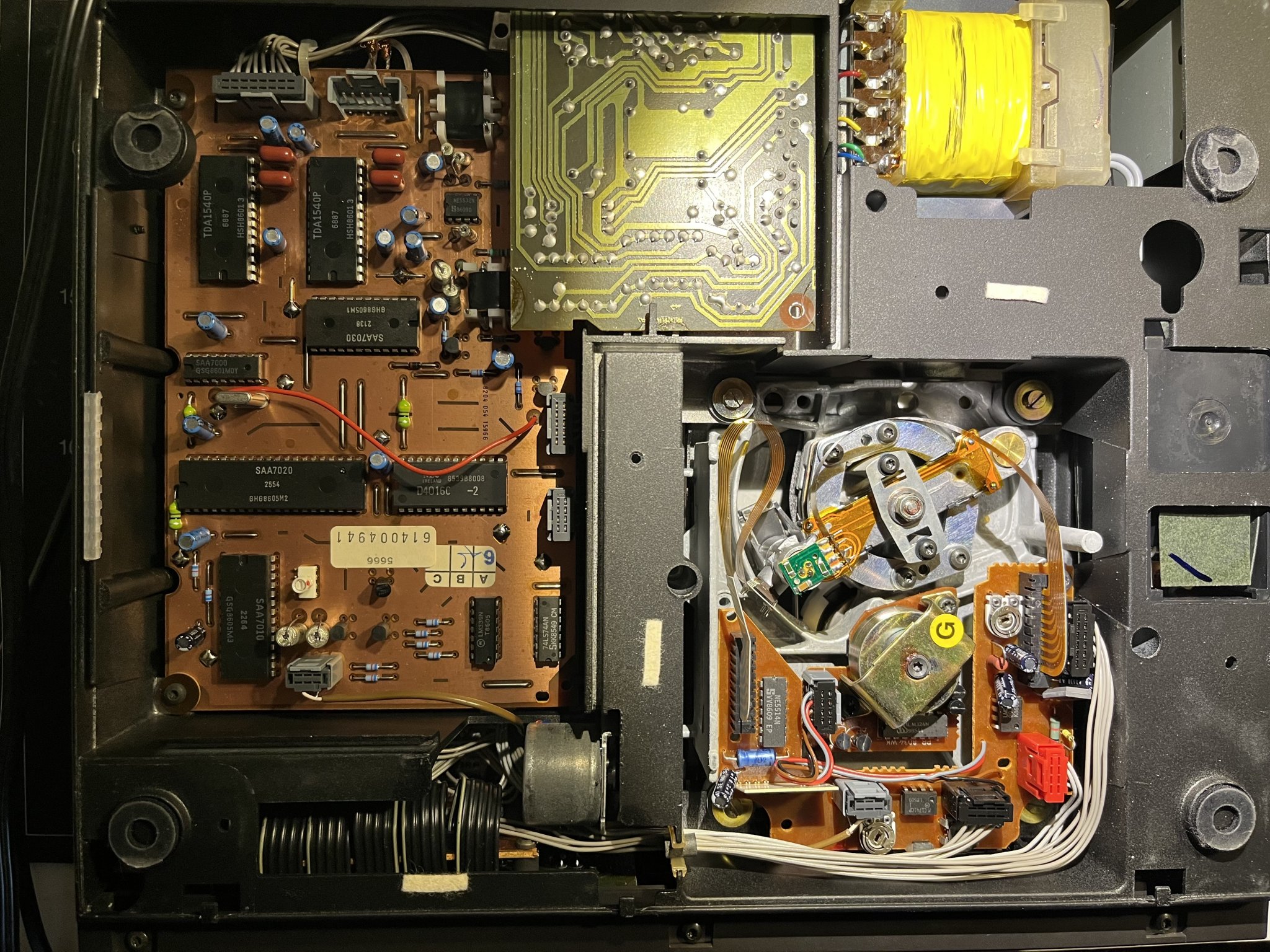

Hi Richard, that is so kind an offer! Thank you!
I am in Berlin right now.
What is your idea, I'd use your mech in order to confirm either mechanical or electrical fault? As yours also skips we'd possibly introduce new variants here. But I am open in any direction. I could at least replace your blue Philips axials 🙂

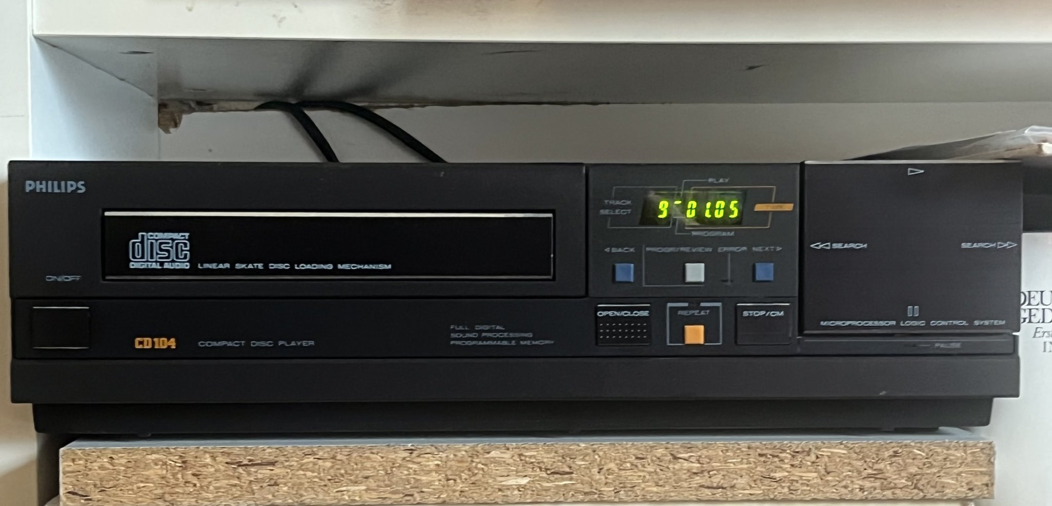

@profiguy , according to your expertise, would it be drag and drop to swap a CDM-1 against a CDM-0? I actually also have a 104 which is completely unmodified and untouched and unopened. I did not even think of swapping anything as it still works and I find this is very remarkable and somewhat precious. I was thinking to adjust it if it fails but not to modify anything. The 204 instead has been my guinea pig in the sense of "how far can I go" sound-wise, successful so far. No idea which CDM is in the 104.
The 104 sits on a place in the shelf where it takes some time to free it, but I could at least look what is inside. Lots of corroded griplets I assume 🙂

My idea was you’d use your board on my mech, but I’d provide my board too, as you could also replace the 4 caps (99% sure that’s cause of my skipping, classic issue) & then use it to rule out yours causing the fault if it wasn’t the mech.
But, I’m fairly sure your 104 and 204 have the same mechs, so you could use that to do the same thing - it will allow you to narrow the fault down. My money is on mechanical issue 🙂
Oh, I could send you the whole 204, but postage would be a bit steep. Plus mine is configured to use an external valve clock…and my only working valve clock is used with my 104…so you’d have the swap crystal and passive components to from yours to get it functional…
Let's talk about that.My idea was you’d use your board on my mech, but I’d provide my board too, as you could also replace the 4 caps (99% sure that’s cause of my skipping, classic issue) & then use it to rule out yours causing the fault if it wasn’t the mech.
We don't know if your motor unit does not also have a mechanical fault / is in need of lubricating / re-aligning.
And I don't know if it is a CDM-0 as well. It does not match plug-and-play style with the CDM-1. Some sorting of wires needed. See post above.

I used the occasion of the little peek show into the guts of the 104 to quickly replace the two light blue radial Philips brand 22uF 35V output coupling caps with two 22uF Nichicon Muse ES bipolar (my go-to coupling cap type). Nothing else done. Lots of 33uF axials confirmed.
And then we will already be two to dismantle and oil the mechanic.
I don't have the patience of a saint. I have the burning impatience of a sinner. I really want to get this machine up and running again.
Thanks for showing the pic. You do have a CDM-0. Your motor board is a different iteration however, it is on page 27ff of the CDM-0 manual.True - if you have the patience of a saint, I will get around to changing the 5 (not 4!) 33uF and confirm it fixes the problem - in fact this thread would motivate me to do so 🙂 I could then test it has fixed before going any further. If I ordered caps now, could even do so before I go on vacation for 2 weeks mid February 🙂
