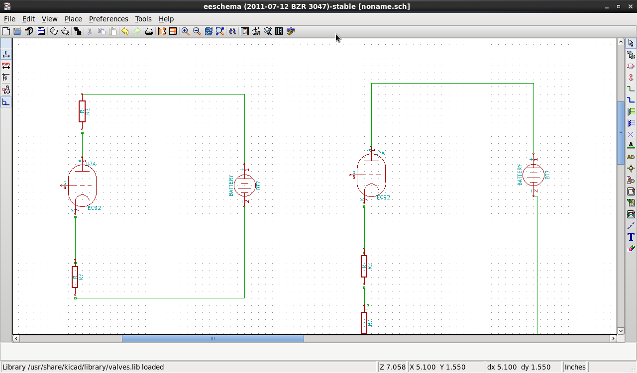

By the way, why don't you want to redraw the schematic, putting both resistors in series, under cahthode, for convenience?
I just started doing that but gave up: I found KCAD very inconvenient...

Actually, I think there may be a way to measure it, even under the restrictive "boundary conditions" that SY demands.
Imagine a Cathodyne with identical loads and no grid excitation. Equal and opposite ground-referenced AC current sources ip and ik drive the plate and cathode respectively. The circuit is perfectly balanced.
Now derive expressions for Vp and Vk. Each will contain contributions from ip and ik.
However, the definition of impedance is the change in the voltage between nodes A and B due to the current flowing into A and out of B, divided by that current.
Accordingly, before we divide Vp, we must reject that portion of its voltage that is due to ik, which does NOT flow directly into the plate and out of ground. Only ip does. When we divide Vp(ip) by ip and Vk(ik) by ik, we get Zp and Zk, where Zp >> Zk.
