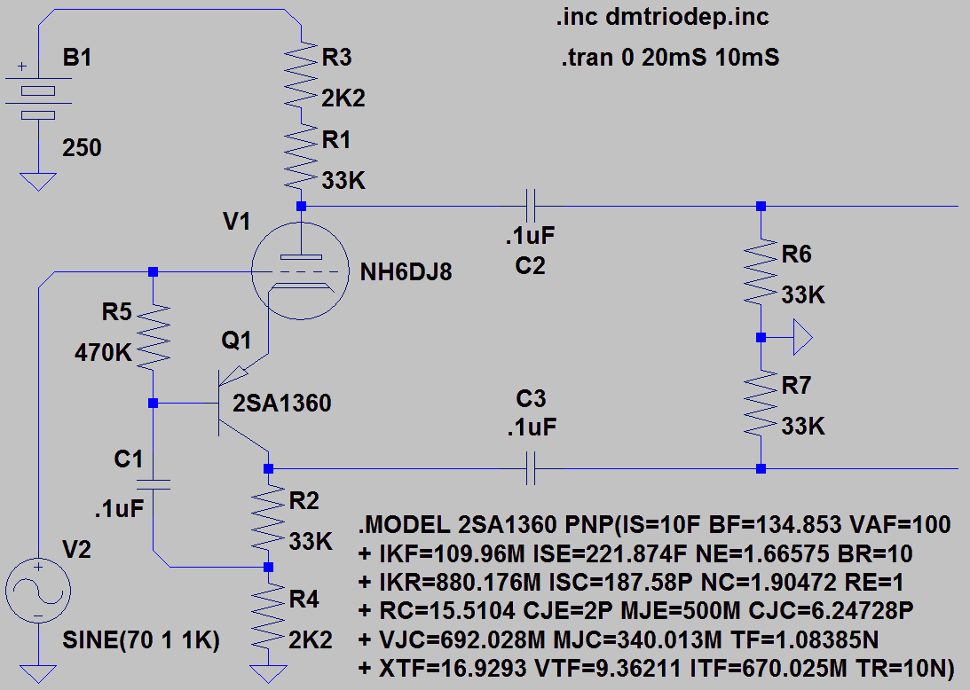

Whilst goofing around with drawing an easier to understand
(not necessarily better performing) version of the feedback
reduction method for equal Z's , I discovered a math error.
The feedback should *NOT* be 1/Mu as I had said earlier.
Looks like Z's are equal when cathode feedback is 2/Mu...
Careful the levels you put into this thing, it has gain!
