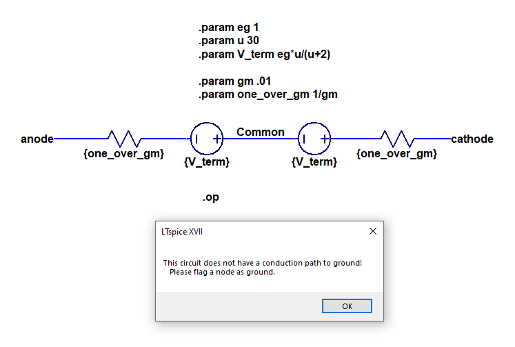

The problems of the traditional “floating” Cathodyne Model are evident without invoking simulators or resorting to analyses based on Kirchhoff’s laws.
It’s obvious that the Model ignores the question of power supply rejection; to it, Cathodynes with 10mV and 10V B+ ripples are identical. Also ignored are the effects of the value of the (matched anode and cathode) loads – 10 kOhm circuits are indistinguishable from 10 ohm ones. Of course, bench tests easily reveal both types of differences.
The Model is like a transformer winding. Each specifies a pair of terminal voltages with respect to that of a third terminal to which the pair is connected. For the winding, that terminal is its center tap; for the Model, it’s an imaginary “Common” terminal.
Just as with a transformer, without a ground connection, the Model cannot specify voltages with respect to ground. (As such, the Model befuddles simulators – see attached.) This is a real problem for a circuit whose purpose is to drive an output stage which is controlled by its ground-referenced grid voltages (its cathodes are typically AC-grounded), not by its inter-grid voltage difference (as specified by the Model.) As if that were not enough, in the absence of ground, there is no closed path through which high signal level output stage grid current can flow. An acceptable model must have connections to ground.
In summary, the Model disregards B+ supply noise, is insensitive to (matched pair anode and cathode) loading, does not specify the signals which control the output stage, and doesn’t support the flow of that stage’s grid current under high signal level conditions. A different model is required if these unfortunate deficiencies are to be addressed.

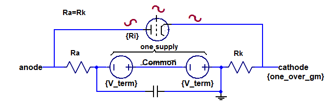

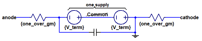

The thumbnail I provided was not my own Model; it was copied from a Linear Audio article by Stuart Yaniger and received a favorable review from Burkhard Vogel.
In general, I agree with your comments. Although I do not oppose combining the two supplies into one and eliminating "Common", neither do I see that it solves anything. And the ground you added to your thumbnail means that there is no signal at the cathode. Bench tests will show this to be a problem.
Without a valid connection to ground, your thumbnail addresses none of the problems I listed regarding the thumbnail I posted.

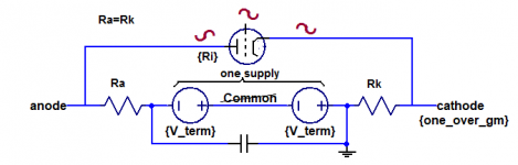

Ketje, as I'm sure you've read, I am no fan of this model. But your Vg is the eg in the .param statement of what I posted. V_term, the voltage of each source, is set by another .param statement to be u eg / (u + 2), where u is the triode mu. In my view, the model makes some sense, but it still should be rejected for the reasons I've posted.
1. Except for drawing grid current, grid to plate capacitive current versus grid to cathode capacitance currents, and filament to cathode capacitive and filament to cathode leakage currents . . .
Then, the current change in the cathode circuit is exactly the same as the current change in the plate circuit.
2. That is true, no matter what the cathode impedance is versus what the plate impedance is (but only if you use identical cathode and plate resistors, identical coupling caps, and identical next stage grid resistances to ground).
The balance of the concertina is very very very good if you pay attention to # 1. and # 2. above.
