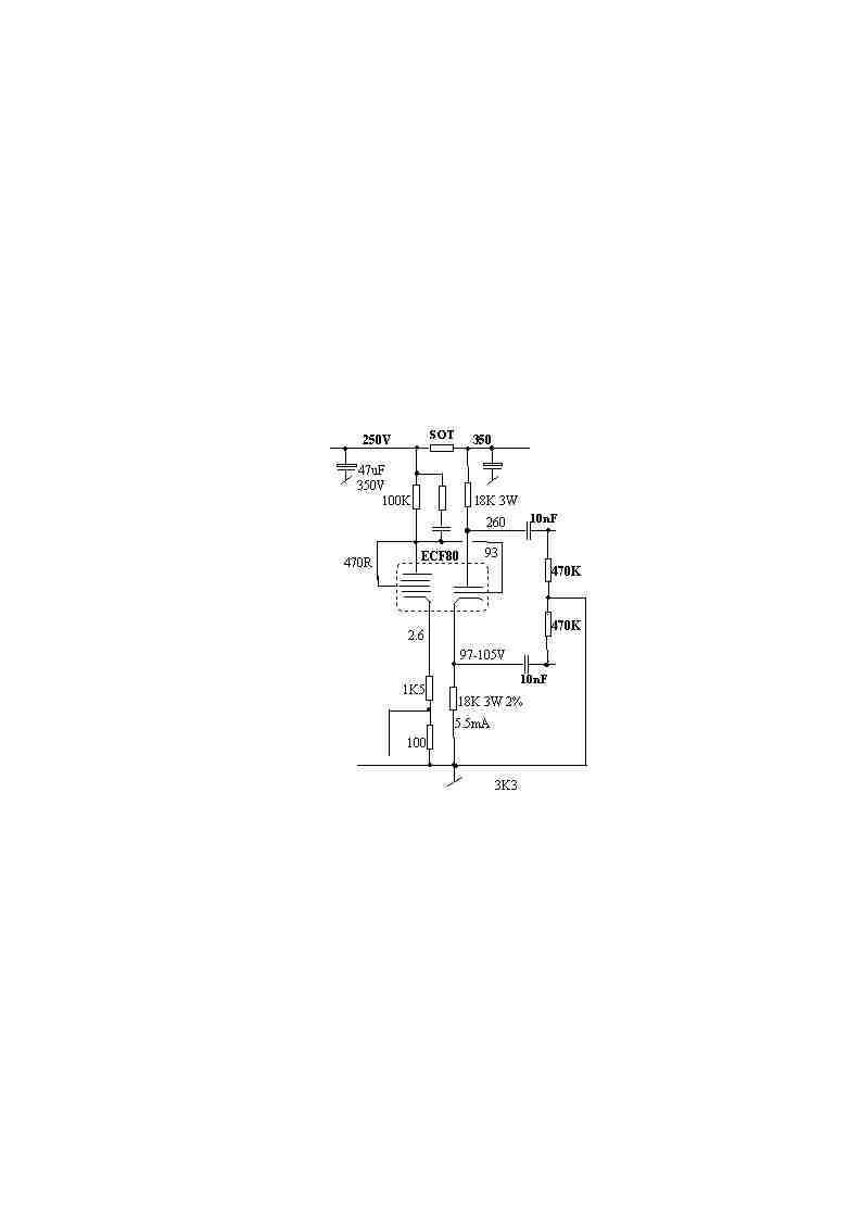

The problems of the traditional “floating” Cathodyne Model are evident without invoking simulators or resorting to analyses based on Kirchhoff’s laws.
It’s obvious that the Model ignores the question of power supply rejection; to it, Cathodynes with 10mV and 10V B+ ripples are identical. Also ignored are the effects of the value of the (matched anode and cathode) loads – 10 kOhm circuits are indistinguishable from 10 ohm ones. Of course, bench tests easily reveal both types of differences.
The Model is like a transformer winding. Each specifies a pair of terminal voltages with respect to that of a third terminal to which the pair is connected. For the winding, that terminal is its center tap; for the Model, it’s an imaginary “Common” terminal.
Just as with a transformer, without a ground connection, the Model cannot specify voltages with respect to ground. (As such, the Model befuddles simulators – see attached.) This is a real problem for a circuit whose purpose is to drive an output stage which is controlled by its ground-referenced grid voltages (its cathodes are typically AC-grounded), not by its inter-grid voltage difference (as specified by the Model.) As if that were not enough, in the absence of ground, there is no closed path through which high signal level output stage grid current can flow. An acceptable model must have connections to ground.
In summary, the Model disregards B+ supply noise, is insensitive to (matched pair anode and cathode) loading, does not specify the signals which control the output stage, and doesn’t support the flow of that stage’s grid current under high signal level conditions. A different model is required if these unfortunate deficiencies are to be addressed.

There is always a ground, the anode and cathode don't fload, they are connected to the supply.And the supply has a connection to the load (output stage) and is bypassed to have both ends ad AC ground level.

The thumbnail I provided was not my own Model; it was copied from a Linear Audio article by Stuart Yaniger and received a favorable review from Burkhard Vogel.
In general, I agree with your comments. Although I do not oppose combining the two supplies into one and eliminating "Common", neither do I see that it solves anything. And the ground you added to your thumbnail means that there is no signal at the cathode. Bench tests will show this to be a problem.
Without a valid connection to ground, your thumbnail addresses none of the problems I listed regarding the thumbnail I posted.

To assemble a new circuit, it is highly desirable to have an understanding of the effects that components of various values will have on circuit performance. Guided by this, performance is confirmed by bench measurements. Without such an understanding, you could be modifying your circuit over and over, hoping to achieve the results you desire without ever knowing if it is even possible to do so.
6A3sUMMER might prefer to ignore the guidance afforded by models, but others will benefit by making use of the information they provide. A good model and a bench test: each has its place in the process of creating a new circuit.
The purpose of my earlier posts was to disclose the limitations and flaws of a certain popular model and point out that there is an alternative which corrects those problems and improves its accuracy.
Ketje, as I'm sure you've read, I am no fan of this model. But your Vg is the eg in the .param statement of what I posted. V_term, the voltage of each source, is set by another .param statement to be u eg / (u + 2), where u is the triode mu. In my view, the model makes some sense, but it still should be rejected for the reasons I've posted.
