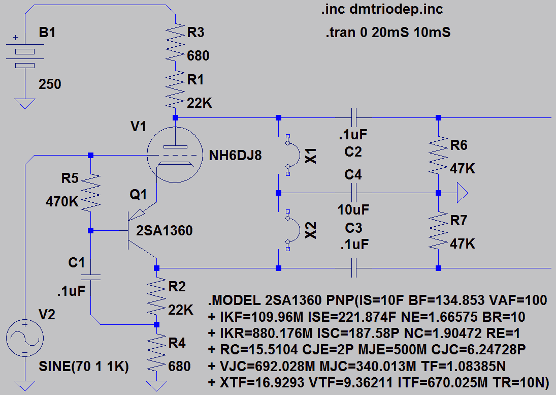

Zp, properly understood, is independent of the AC load attached to the cathode.
Yeah, except that it isn't...
Lets observe an example circuit with actual equal impedances.
Under normal conditions, both output a 10V sine.
But short either X1 or X2 jumper to the grounding cap,
and note the consequence seen at the other output!
No matter which you short, the other spits out a 15V sine.
Thats proof of the pudding right there... No favoritism.
Little distorted, far from optimally biased, but equal...
+/- 10x gains? im not sure why it isn't closer to +/- 18x,
which would be closer to Mu/2. Bad loadline I suppose.
Example in post #55 might be harder to grasp, but runs
the triode at almost constant current for true Mu/2.
I also goofed when second guessing my own earlier circuit.
1/Mu was the correct answer. 2/Mu might make the waves
a tiny bit more equal in the matched load state, but only
1/Mu cathode feedback makes the fully off-balance loads
deliver equal consequence to the other side.
There can't be any math that ignores what happens the
other side. You can't know RP or RC without knowing
how the other is loaded, because it has consequences
that must transfer for the impedances to be equal!
Actually, you see under stress they become UNEQUAL.
But the misbehavior is equally distributed, and favors
neither end... Unfortunately the best balance you can
hope to achieve, without reducing both to zero by the
global feedback method...
In fact, you've proven my earlier point that some here insist on folding the trans-impedance from cathode to plate with Zp. Consider carefully what you quoted:
Zp, properly understood, is independent...
Moreover, the model that I sketched in the attachment to #254 gives exactly the result you describe above while holding Zp, Zk, and the trans-impedances constant, thus calling into question your conclusion.
I've simulated a simple small-signal model of a phase-splitter with Rp = Rk = 22k, mu = 100, rp = 62.5k. From this model, I calculated and verified the Z parameters of the coupled output ports:
Zp = 21.79k
Zk = 806.0
Zkp = -21.194k
Zpk = -210
The small-signal model and the model I sketched in the attachment give identical results including the effect you described above thus verifying the model and its interpretation.
Also, note that Zp + Zkp = Zk + Zpk = 596
Not coincidentally, 596 is the differential output impedance so it all hangs together. Just as I wrote before, my model will give the correct results (in the context in which it was derived) regardless of the loading. I has to, it's based on sound EE fundamentals.
You can ignore the other end only if both of your "equal" impedances are zero.

Correction, I did not simulate your example circuit but rather a simple phase splitter. The perils of posting before morning coffee... ;^)
Later today, I'll work on extracting the Z parameters of your example circuit and compare those to the simple phase splitter.
I suspect that the Zp and Zk will be more less equal as will be the trans-impedances which implies the results you describe.
kenpeter, since you already have your example circuit working in your simulator, why don't you extract the Z parameters for my model. It's easy to do.
Replace R6 and R7 with AC current sources; label them I6 and I7. Initially, zero both. Set the AC voltage of V2 to 1 and plot the AC voltages across the current sources. The midband values are the open circuit voltage gain parameters, Ap (across I6) and Ak (across I7).
Now, zero the AC voltage on V2. Set the AC voltage of I6 to 1 and plot the voltages across the current sources again. The midband values are the Zp (across I6) and Zpk (across I7) parameters.
Now, zero I6 and set I7 to 1 and plot the voltages across the current sources again. The midband values are the Zkp (across I6) and Zk (across I7).
That's it. Let me know what they are and I'll plug them into my model and see if we get comparable results.
Merlinb, the symbol in question is just a lowercase, cursive 'z'. It represents the transfer impedance. Although the transfer impedances are a function of gm, they're not equal to 1/gm.
In words, the transfer-impedance Zkp it is the ratio of the open-circuit AC output voltage at the plate to the AC current out of the cathode output. Google "Z parameters" or open-circuit parameters for more general details.
If my algebra is correct:
Zkp = -(1 + mu)*Rk*Rp / [rp + Rp + (1 + mu)*Rk]
Zpk = -[(Rp - Rk)*rp + Rp*Rk] / [rp + Rp + (1 + mu)*Rk]
When Rp = Rk: Zkp = (1 + mu)*Zpk
Zp and Zk are the well known:
Zp = [rp + (1 + mu)*Rk] || Rp
Zk = Rk || [(rp + Rp) / (1 + mu)]
The open-circuit gains, Ap & Ak, are the well-known:
Ap = -mu*Rp / [rp + Rp + (1 + mu)*Rk]
Ak = mu*Rk / [rp + Rp + (1 + mu)*Rk]

Essentially, you'll run three different AC sweeps on your circuit (from 100Hz to 10kHz will be fine). You need three AC sources: V2, I6 (replaces R6) and I7 (replaces R7). Only one of these sources will be activated during each of the three AC sweeps; it will have an AC value of 1. The other two will be set to zero AC volts or amps.
In all three sweeps, you'll be plotting the output voltages, the voltages across I6 and I7.
In this way, you see the AC response of the outputs to each of the different sources, one at a time.
These responses tell us the 6 parameters in my model: Ap, Ak, Zp, Zk, Zkp, Zpk. You read the magnitudes directly from the output voltages.

OK, in the meantime I figured out that it's LTSpice which I actually already have installed. I runs fine in Wine but I essentially have no experience with this program.
Nonetheless, I simulated your circuit and extracted the following parameters:
Ap = -11.72
Az = 11.65
Zp = 14.81k
Zk = 14.44k
Zpk = -8.245k
Zkp = -8.268k
So, as I suspected it must be, the Zp and Zk (open-circuit output impedances) are nearly equal as are the transfer impedances for your circuit.
So, according to this, the differential mode output impedance should be about
Zp + Zpk = 6.57k. Let's see...
Yep, with R6 and R7 set to 6.57k, I'm seeing an output voltage roughly half the open-circuit output voltage from both your circuit and my model Z parameter model of it.
Cool!
