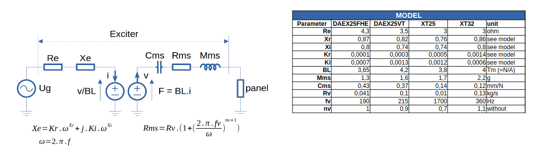

Hello Eucy
The model schematic and parameters for DAEX25FHE, DAEX25VT, XT25, XT32 are now in the document Github exciter_characteristics.pdf
@Veleric : Thank you Eric for the measurements.
Extract :
I note some reasonable differences in measured vs published rms values for the Xcite 24-4 and 32-4 units...
The values from the measurements and from the specification are comparable only if they refer to the same model. The model being like the way to extract several information from the impedance curve. So in this paper only the value from the first page are comparable directly referring to the Thiele and Small (T/S) parameters (or model) which suppose a constant Rms value over the frequency range.
The model in last page (the one I posted just before) suppose a frequency dependent Rms
From this table it comes as resonance frequency for XT25 326Hz (for 306Hz in the spec), for XT32 310Hz (for 312Hz in the spec) so using those frequencies for Rms calculation in last page , it comes for XT25 0.175 vs 0.09 in the spec and 0.14 in T/S model and for XT32 0.31 vs 0.2 in the spec and 0,2 in T/S model.
Knowing since those measurements that the damping is probably the parameter with the most important error margin, I would say it is not that bad.
With your comment, I see the lines "Rms VC / magnet" and "Mms VC / magnet" of the first table are not consistent. They are now more clearly split (I uploaded a new version of the file)

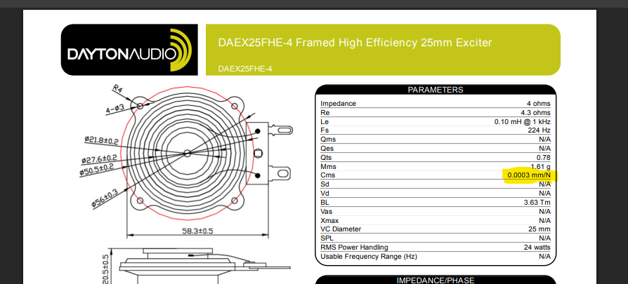

The main comment I would do is about XT25 which is much stiffer at 0.12mm/N the the Dayton models FHE, VT at 0,4mm/N. I don't know the consequence. The XT32 is comparable (from those parameters) to the DAEX30HSFE.
Christian
Christian,
Looks like they slipped a few digits in the Dayton specs for Cms, unless they are a lot stiffer than we think. Presumably they mean m/N instead of mm/N. Or am I missing something? Your numbers make more sense to me!
Eric
Hello Eric,
Yes it is a mistake in the datasheet. We can confirm ss the fs is visible on the impedance curve, the mms makes sense in gram range so if you compute the cms it comes below 1mm/N. fs = 1/2/pi/sqrt(mms*cms)

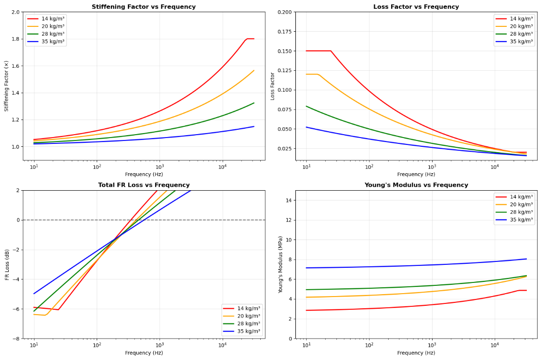

I've been hunting around all the complexities we haven't yet covered - one of them being frequency dependent stiffening of panel material and the effect on output - here's a taster for EPS to chew on - the zero line is the expected static FEA (or other) result - so below about 500Hz, static is pessimistic, and above it we can expect losses due to freq dependent stiffening.
Hello Eucy,
From my side, I started from a list of common observations or questions I was able to list from our discussions : is the coincidence frequency a reality for a DIYer? which cause and countermeasure for the HF peak? which cause and countermeasure for the midrange peak from the rear side? why a simply hanging panel can be appreciated compare to other suspensions? what can be the benefit of added masses (edge, balance)? what are the suitable panel ratio and exciter location?... Far to be easy. The process is slow but some answers are here.
To come to your point, it is a piece of puzzle that doesn't fit in this set of questions. Or possibly I am not able to see how it fits.
Did you start from some observations or knowledge from an other domain for that?
Could you explain the plots and how they are related to each other?
The Young modulus is for sure a parameter but I think it the first time I see it frequency dependent. What is the source of this plot?
I can understand the loss factor even if damping is not implemented like that in my script. Its decrease with frequency makes also probably sense with my last observations about Depron (XPS). It is the reason of my question of the Q model to Dave.
The stiffening factor and the FR loss are new for me and I can't connect them at the moment to observations.

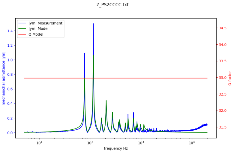

The Q factor and more generally the damping model is really a key point. When I started 2 years ago with FDM, and up to recently, I thought the difficulty was on the solver... but now the FMD solver is implemented and seeing your modal implementation, the damping is on the top of the difficulty list.
I just wrote a small script that tries to extract the Q factor from the mechanical admittance derived from an impedance measurement. Below is a plot for the plain polystyrene CCCC panel I shared some posts ago. The script is based on curve fitting. If you are interested, I can share the python code.
I implemented in it with a Q law able to increase the Q factor with a power of the frequency... on the few tests I have for now, it returned a constant Q value.
For the plain polystyrene it is Q = 33 in the plot below.
Question : in PETTaLLs, we see the Q factor seems to be chosen below what the impedance curve suggests. It is confirmed by my curve fitting script. Could you explain the reasons that lead you to adopt the PETTaLLS Q values?

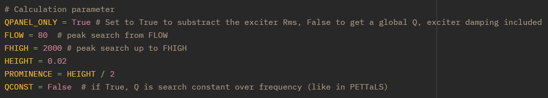

I modified the script. It has now the following parameters :
QPANEL_ONLY : set to True will remove the exciter Rms from the calculation giving the Q of the panel. False the Q will be global. (NEW)
FLOW : set a lower limit to search of peaks and to the curve fitting (NEW)
FHIGH : set an upper frequency. Already in the previous script but not as an easy to read parameter
HEIGHT : specify the minimum height of a peak. Already in the previous script but not as an easy to read parameter
PROMINENCE : set the minimum difference between 2 peaks. Already in the previous script but not as an easy to read parameter
QCONST : set to true to estimate a constant quality factor as expected by PETTaLS, False, Q will follow Q = Q0(1+ (f/f0)^k0)/2 which my current trial of a frequency dependent Q. NEW
2 remarks
  • You have to close the first graph (REW impedance and electrical elements of the model) then the second (admittance, peaks and limits) to reach the line where is the curve fitting. The result graph should appear.
  • I have introduced a facto 1/2 in the frequency dependent Q
If you want I run the script for you on some materials, send me your REW impedance files. It will go in the direction of a material library.

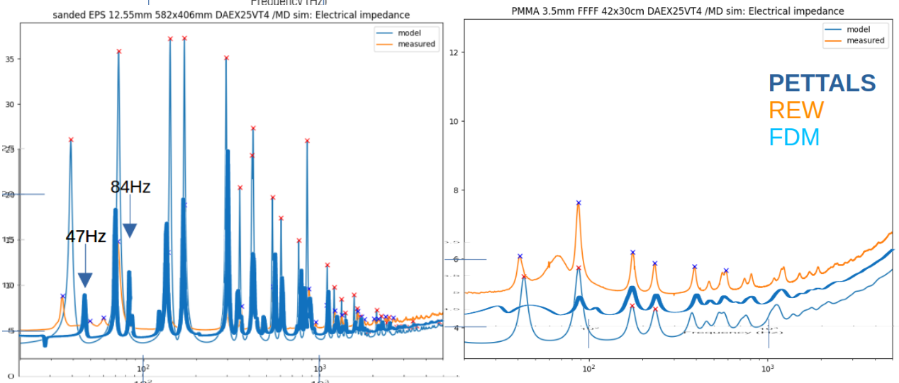

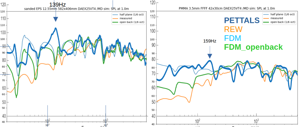

Here are 2 new test cases of simulation (PETTaLS @EarthTonesElectronics , and my FDM python script)
Those test cases started from the idea to go further in the Q identification from the impedance measurements.
Eric made the measurements (tap test, REW) and the material parameters evaluation. Thank's a lot Eric!
In fact what started as a Q evaluation turned in a full tool chain evaluation.
The steps were as follow :
  • tap tests with REW (panel alone)
  • impedance and FR at 1m (panel with a DAEX25VT)
  • estimation of the material parameters (Young modulus, Poisson's ratio) from the tap tests with FEA simulation
  • quality factor extraction from the impedance measurement (see post before)
  • for the FDM script, the impedance and FR from REW were exported in txt format to be used as references
  • simulation
The 2 panels are acrylic and EPS mounted in free edges with an exciter at 0.5/0.5 with a fixed magnet. Those materials were chosen because isotropic, at both end of the density of the materials usually used for DML. The tests conditions were chosen to fit PETTaLS and the FDM script.
The very positive point is it was not necessary to tweak the parameters to get good results. They show also the possibilities to get the material parameters.
The simulations gave a good alignment in frequency. More difficult in impedance values.
The SPL outputs have also quite good similarities with the measurements.
The SPL curves are manually adjust in level to be superimposed. The check of the absolute level was out of scope.
The 2 test cases are summarized in the 2 attached pdf.
Below are the main outputs (impedance and SPL). Left are the plots with EPS, acrylic is on the right.
From the SPL, the low frequency SPL from the open back simulation in FDM is over-estimated. PETTaLs shows unexpected peaks (139 and 159Hz).
From the EPS impedance plot with PETTaLS, the lowest frequency peaks are not aligned with the measurement. The velocity maps at those frequency show some asymmetry (see pdf).
There shifts in the impedance plots because of the DC resistance which was not compensate.
