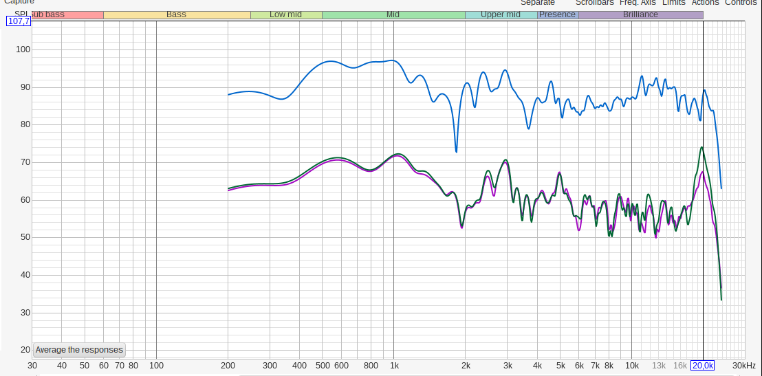

Hello Dave,

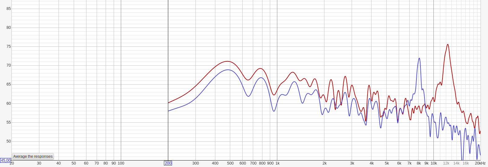

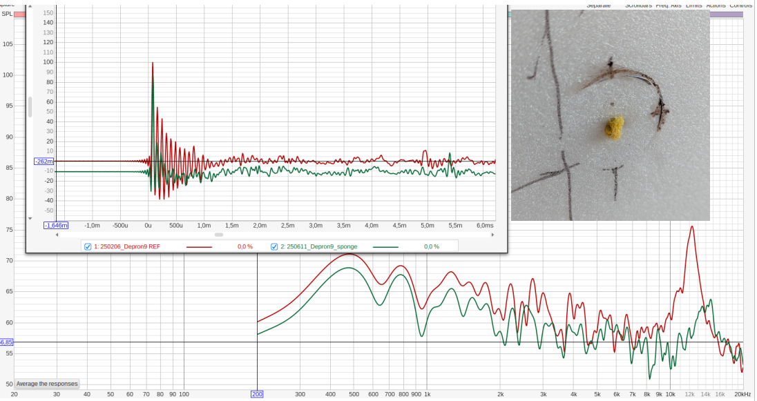

Here are measurements I prepared some time ago but I just did today. There might be interesting in the quest of the HF resonances.
I started from the situation of a DAEX25FHE glued on a 60x60cm (I know strange dimensions but it is before taking any decisions about how to size it) sheet of 9mm Depron (sort of XPS). This panel shows a huge peak at 12k (red curve)
As a countermeasure, I glued a 25mm thin aluminum disc at the exciter location (on the front side to avoid to remove the exciter).
Result the peak is still present but lower in frequency 8k and a loss of HF
View attachment 1471560 A bit disappointed because this countermeasure worked some months ago with an acrylic panel, I have removed the disc. The panel didn't return in its initial condition because while removing the alu disc, the glue removed also the skin of the Depron, the peak jumped to 9.5kHz
Then I applied the countermeasure recommended by Steve... a small piece of foam inserted in a maybe 2mm or less central hole. Magic! @spedge . Steve, I hope you'll be happy to see your advice applied!
Here the original panel compared to the sponge countermeasure with the IR and a picture
So I don't say there is no exciter breakup topic. Just to show what is the commonly encountered problem. There might be 2 topics in fact, the resonance of the central area occurring mainly with a light material and the voice coil breakup visible with a heavy material.

PS : all the measurements are gated at 5ms to reject the room.
PS2: I am wondering now what what would be the result thinning the central area... I remember Steve experimented it and I did so on my very first XPS panel. With the right profile, it could act as an acoustic black hole. Some constrained damping layer might be possible in addition...

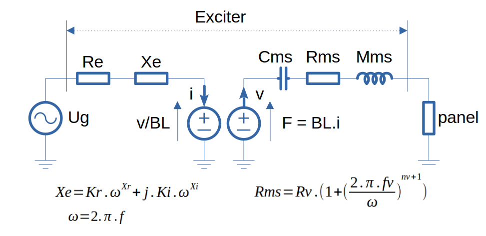

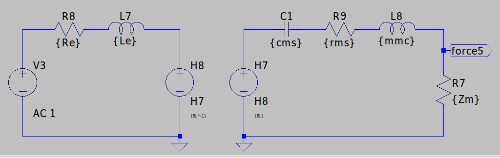

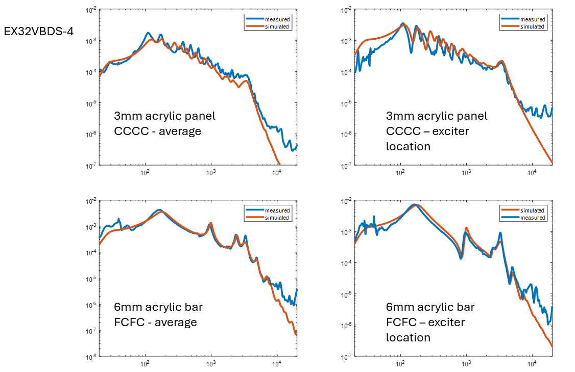

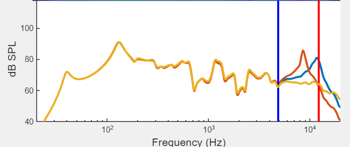

Here are some simulations matching your experiments: blue line is basic exciter, orange line is with added mass at the exciter location (aluminum disc), yellow line is with the mass removed at the exciter location (e.g. cutting a hole in the panel). I don't think my model is complete yet, but I'm getting closer!
Good! I posted a follow up on the main thread : #14057 showing a test where the central areal was thinned and dampedThis is certainly helpful in identifying the source!
I have no experience with alu. Too heavy, too stiff. The heaviest material in my set is acrylic.It seems to be related to changing boundary conditions at the exciter/plate interface.
On this topic of resonance in the 10kHz, the DIYer experiences are more from light panels like EPS. For them a very little mass or modification of the center change quickly the resonance.
My knowledge of your simulator is too low to fully understand "yellow line is with the mass removed at the exciter location (e.g. cutting a hole in the panel)" Making a hole removes mass yes but probably also decreases at the exciter ring the stiffness of the plate.

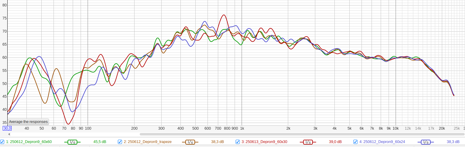

After testing the central area effect on the HF, I decided to continue to what I have had in mind for weeks which is to see what is the effect of a skew edge (trapeze shape).
So I started from my 60x60cm sample
Then I resized it to a 30 top/42 bottom x 60 trapeze.
As the difference was not that important, I decided to test a 30x60... without paying attention it was a 1/2 ratio
An last I resized it to 24x60.
Below are the FR smoothed at 1/6 octave. The problem I want to point is visible but not that obvious. Do you see it?

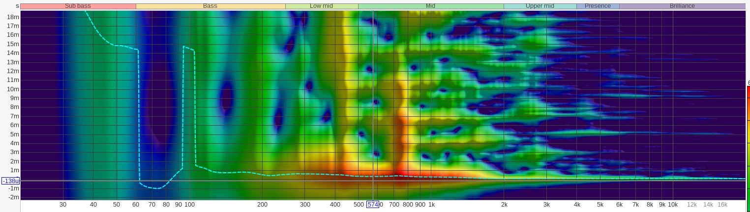

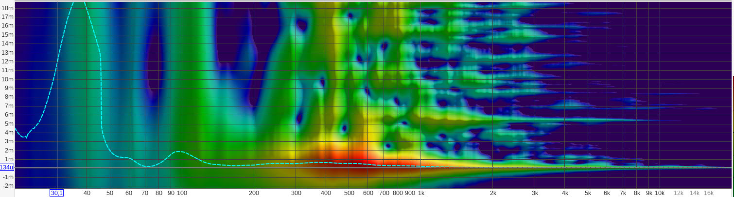

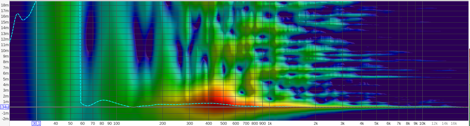

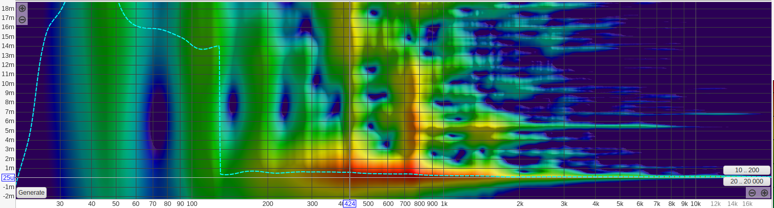

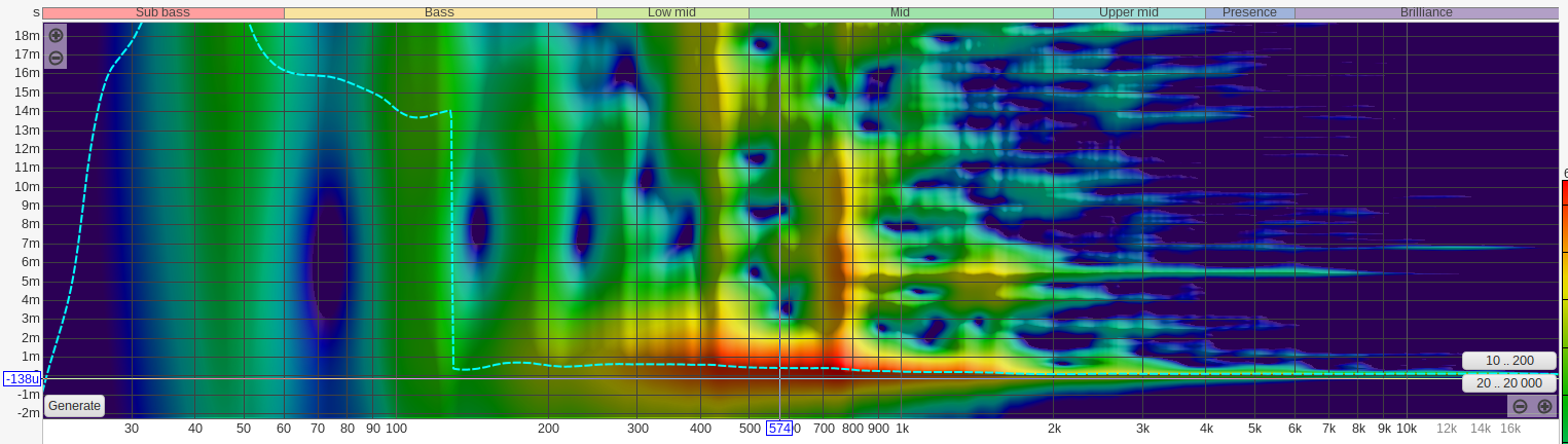

Here are the spectrograms
60x60, not that bad
trapeze, it starts to be a bit long in the 500/600 Hz range
60x30. Horror! look at above 400 and 700Hz
60x24, still some resonance but in the same magnitude as the trapeze
Up to that, I was in the idea to use the smoothness of the FR let say above 200Hz as a fitness indicator to classify the different designs. I don't have this figure for those measurements but it seems that the spectrogram view is much more sensitive.
All of that to say what I expect from a simulation is to be able to classify the designs in such a way. Of course it is not a big revelation to discard a 2:1 ratio. We have here "only" 4 variants. Where is the optimum, if there is one...

Christian,Of course it is not a big revelation to discard a 2:1 ratio.
No, it's not a big revelation. But it may still also possibly be misguided at the same time, at least in the case of a free panel. It's true that for a simply supported (and isotropic) panel, when the ratio of the side lengths is an integer multiple, there are more "coinciding" resonances than with non-integer ratio of side lengths. And it is reasonable to suggest that such overlapping resonances might result in more "ringing".
But I'm not so sure the same is true of a free panel (except for a 1:1 ratio!). As far as I can tell from my FEA models, there is nothing "special" about the resonances of free panels with side lengths with integer ratios. As an example, I just ran this model of a free panel with a 2:1 ratio. There's no coinciding resonances within the first 40 some frequencies. I suspect your FDM model will show similar results.

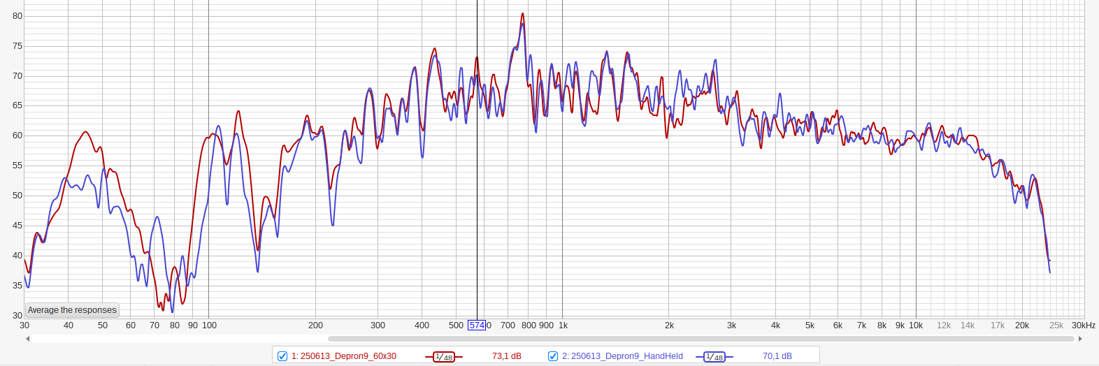

I assume these are free panels right?
I use now one large ribbon of tape on the top part of the panel aligned on the exciter.What are the suspension points?
In the same test sequence, I removed the tape and made a measurement holding the exciter by the magnet. The FR was very similar to the one with the tape. So for now my conclusion is this tape method is very close to free edges conditions at least for the range above 150 to 200Hz.
It is not EPS, it is Depron which the brand name for sheets generally used for thermal isolation. It is an XPS made from a very thin foam. I am a bit surprised by the results which seem different from the XPS in thicker sheets (ie 20mm). The materials seem also different. In the article linked, it is written it is what is cardboard core.Are they EPS? And did you attempt to identify the elastic moduli?
Eric
Link to a wiki : Depron (FR), the article is in French.
I haven't measured the Young modulus for now.
The sheets are sold in 9mm or 6mm thick. This one is 9mm (measured 9.3mm). Density is 38.5kg/m³, so 0.35kg/m²
I have in my notes from some paper I found a 31kg/m³ XPS with E 20 to 40MPa and Poisson's coefficient 0.4 to 0.5. To be confirmed for Depron... Maybe I should make a tape test with a not too large sample to have the frequencies high enough.
With central tape : red, Hand held : blue
Central tape
Hand held
For sure your are right Eric... And what I wrote is wrong! It is not a simply supported panel. Thank you for the simulation.No, it's not a big revelation. But it may still also possibly be misguided at the same time, at least in the case of a free panel.
So a question comes... what is the cause of those resonances?
Maybe a side comment which is some weeks ago, I did about the same kind of tests with a 20mm thick sheet of EPS. I will try later fo find the measurements but it was the same global FR shape. Rather smooth (compare to other tests I made) and very suprising for me, with a low effect of the width on the bass roll off. The EPS sheet was cut from 80cm to 35cm with not that much change.
An other side comment is, for those light panel, it seems (to be confirmed) that adding the exciter with the effect of its spider stiffness pushes a resulting first mode above the second mode.
Christian,So a question comes... what is the cause of those resonances?
For me it is harder to explain why the other sizes don't have more obvious resonances.
